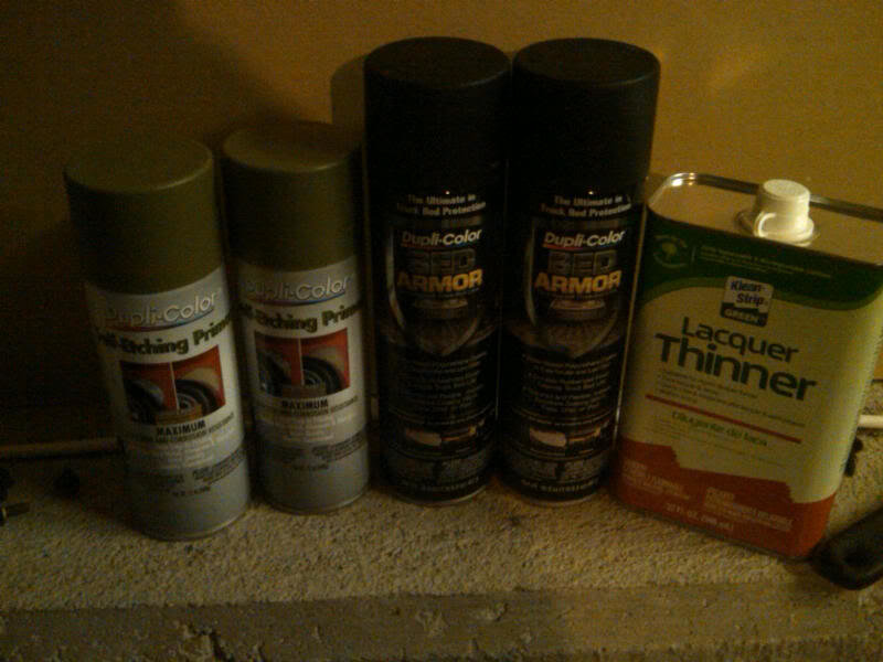

    Picked up the supplies today...I'm hoping to get it done in the next few days..

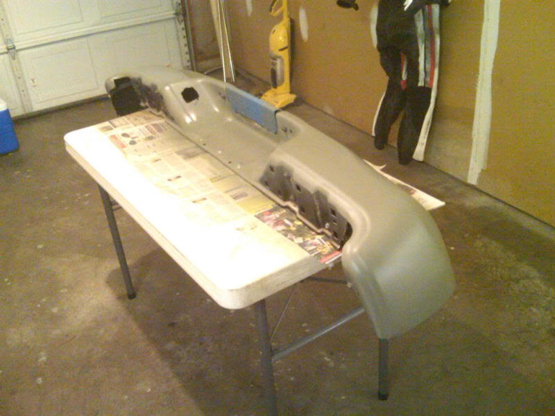

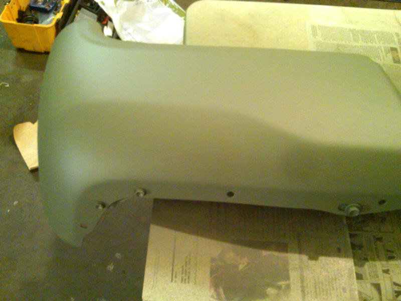

    Might get this done tonight..It's snowing and I want to park in the garage, lol
    Primer done.

    I'm having a hard time getting it on in thin coats...it seems to be dripping alot. I'm wondering if it would have turned out better without a primer coat....Do you have any photos of the finished product?

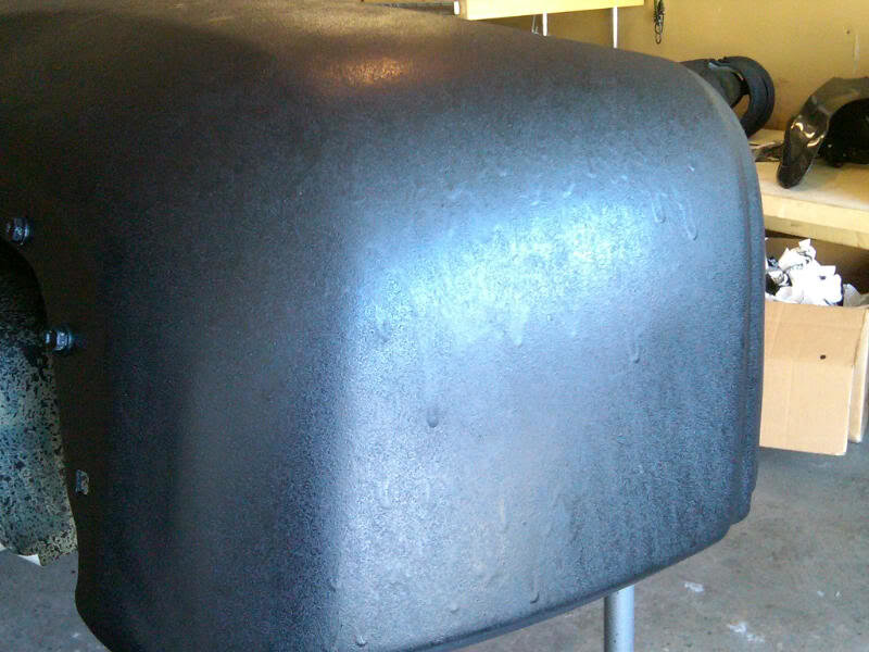

    It is going to make a huge mess. I was about 14-15" away from my front bumper when I sprayed it. I used 3 coats total.

    Remember each coat won't fully cover. It will look speckled. If you try to make each coat fully cover, it will drip. Just put like 10 super quick thin coats on, it will turn out much better and stronger.
    Good luck!

    Thanks for posting, looks good, mine still looks pretty glossy, but it's only been about an hour..hopefully in the next hour it will dry out and get a flatter look, and I can fill in from there..
    Thanks!
    Noted, thanks. It's a little too late for that, but hopefully once this base coat dries I can apply that technique and get the desired outcome.

    Finished primer coat, really happy with how that turned out.
    Bedliner dripped down the side, not happy with that...I'm thinking about getting the roll on stuff, this spray is driving me crazy.
