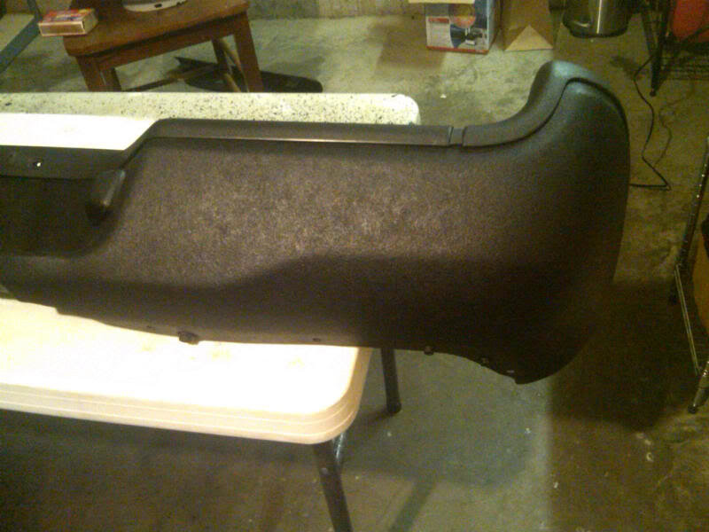

    Sun was out today, so I kept the door open. Sanded it down with 100 grit sandpaper, then gave it a quick rinse and got back to spraying. I blotted flat any large clumps that looked like they might run, but overall had no problems.
    I think the biggest mistake I made last night ( just realized) is that I forgot to sand the primer coat, it was too smooth and that caused the liner to drip. These last 4 coats I just put on had no serious dripping.
    I'll post pics when it dries, thanks for the help doods.

    Done. Turned out pretty good, I'm happy with it. Matches the plastic pretty good, no need to do that. For the less than $20 project total it was totally worth it. I'll post another photo tomorrow when I get it mounted and the sun is out.

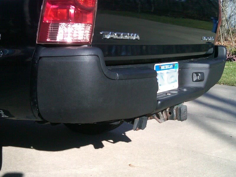

    Here it is...Looks great, I love it! Probably gonna do the emblems and fender flares. Any little discoloration you see is just a little water from the bath.

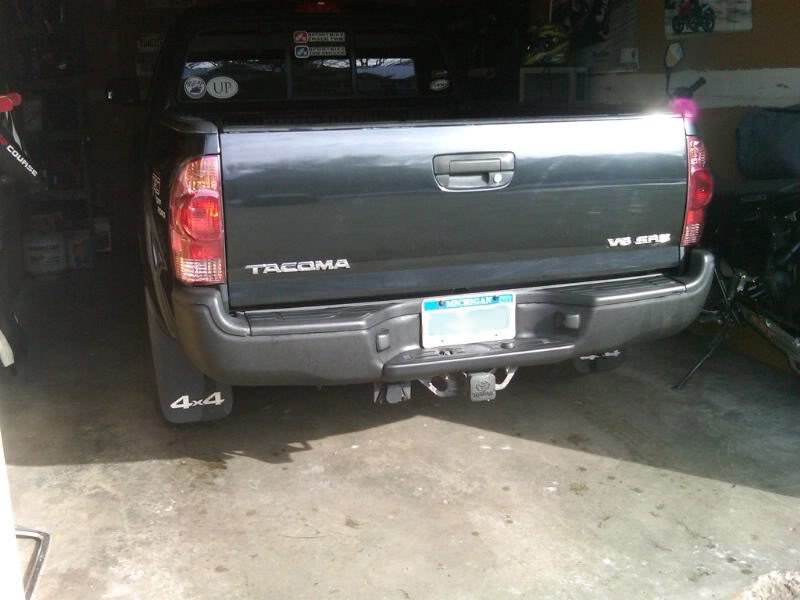

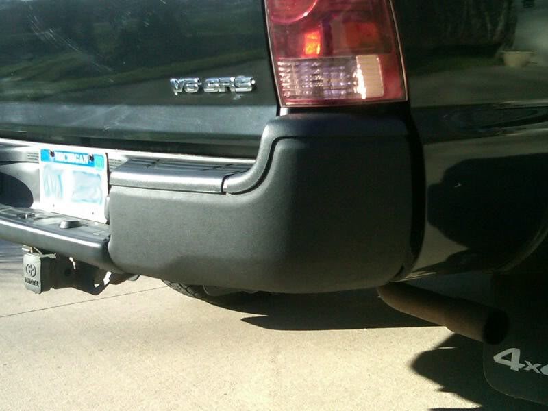

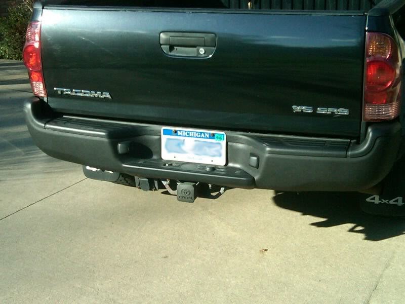

    Sorry for the delay, hope these do it for you..
    Thanks man, it's pretty simple, go for it.
    Yeah, I would just stick with the powder coat in this scenario.
