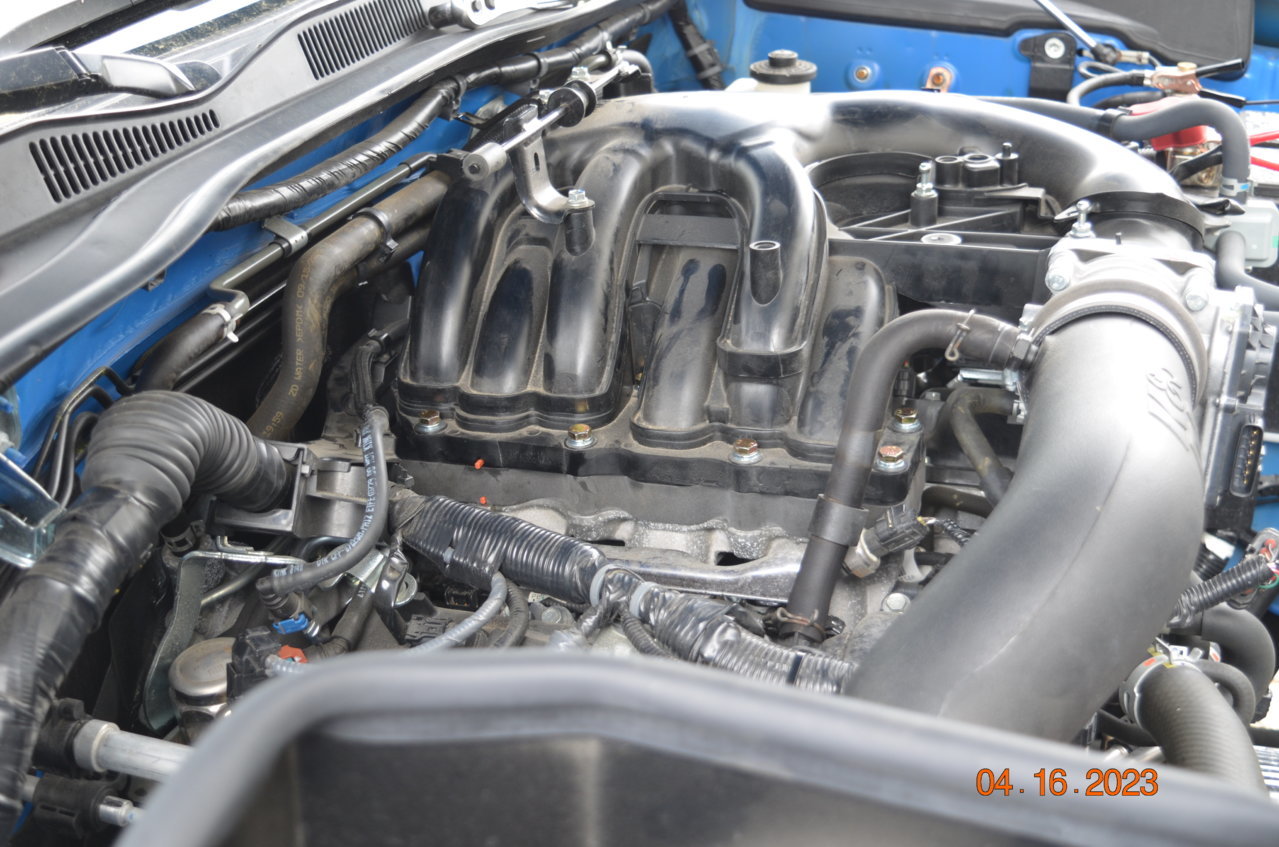

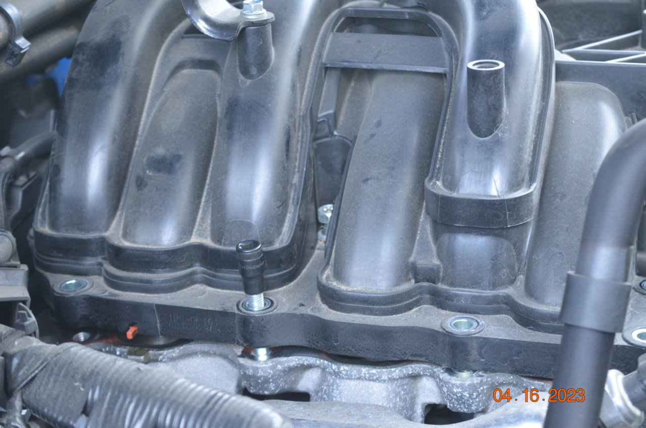

    I found time today to install my manifold spacer on my '21 TRD Sport. It was very easy except for having to fight with that wire harness at the rear of the engine.
    But even with that and stopping to take pictures, I still got it done in less than an hour.

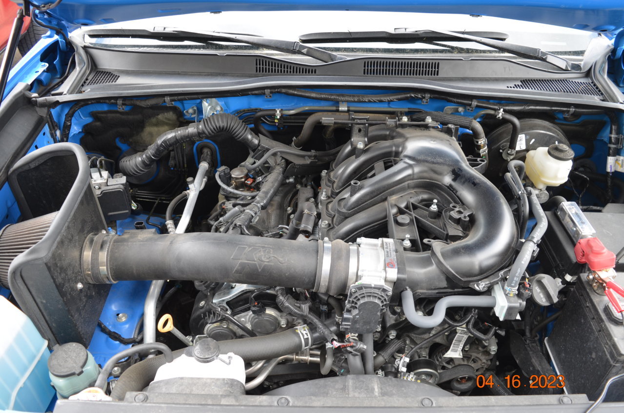

    Here's the engine getting prepped for manifold removal. I unclipped everything in this picture. 1- Spacer install prep.jpg

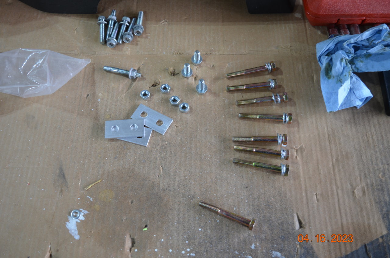

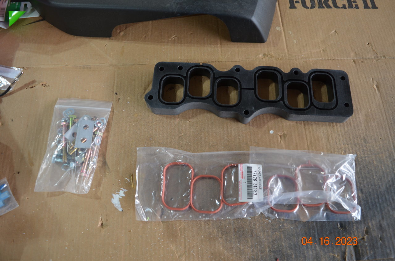

    Next I laid out the manifold spacer and all the parts that were included with it.

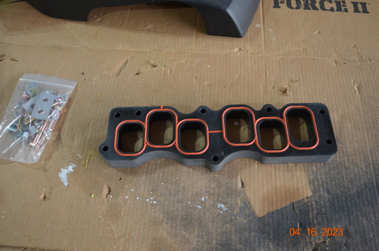

    I then put the gasket on the spacer.2- Manifold Spacer prep (1).jpg 2- Manifold Spacer prep (2).jpg

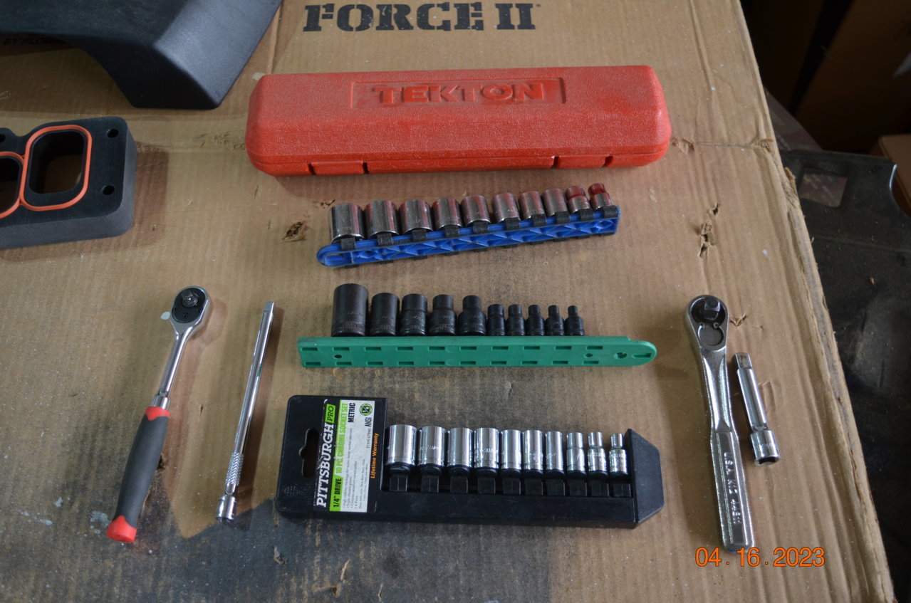

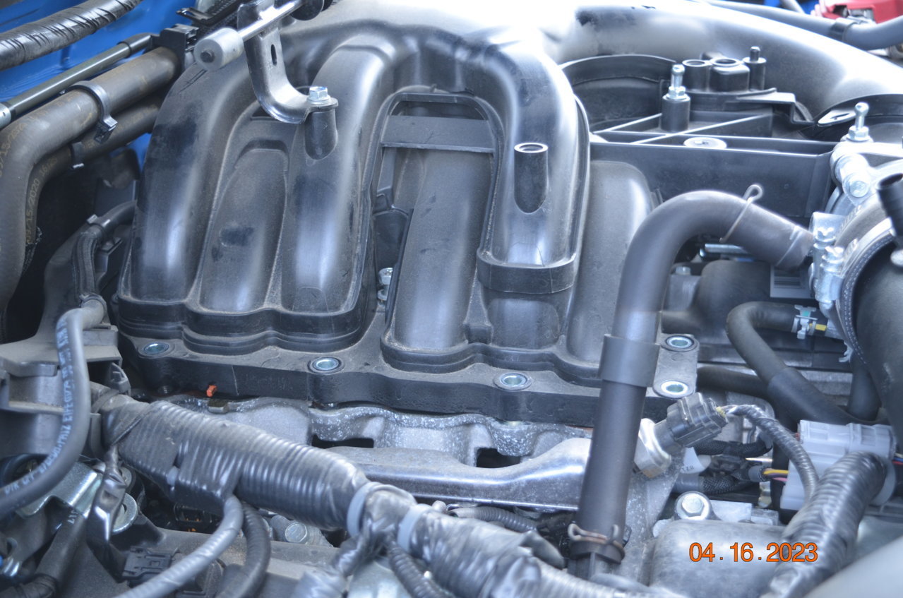

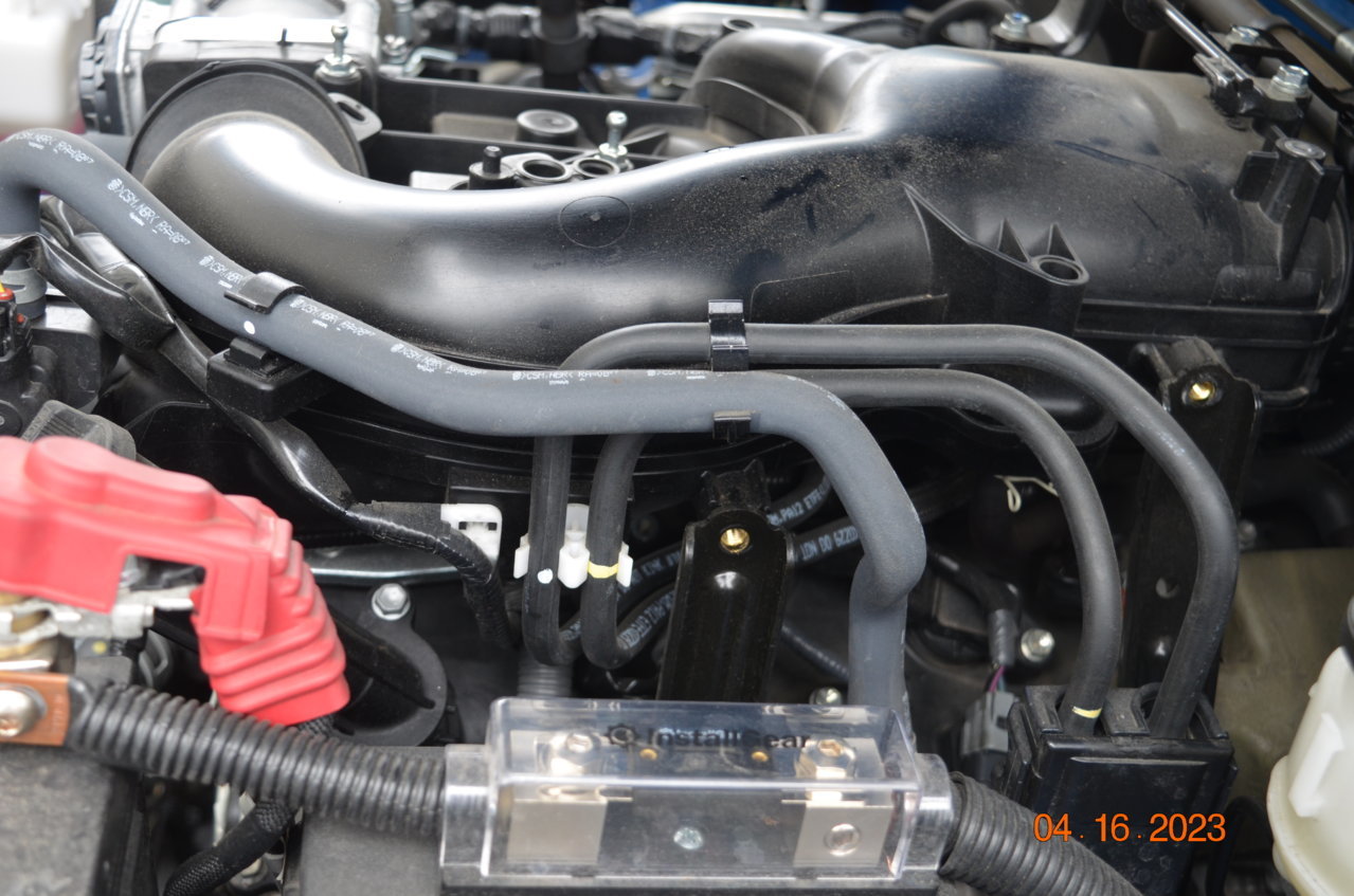

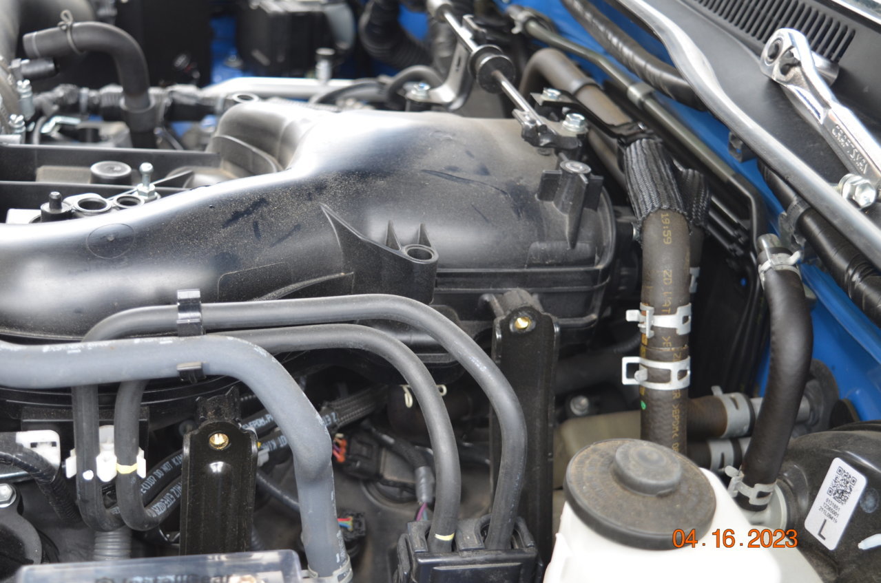

    Next I removed the manifold bolts and separated the braces from the manifold by removing those bolts. 4- Manifold braces separated from Manifold (1).jpg 4- Manifold braces separated from Manifold (2).jpg 4- Manifold braces separated from Manifold (3).jpg

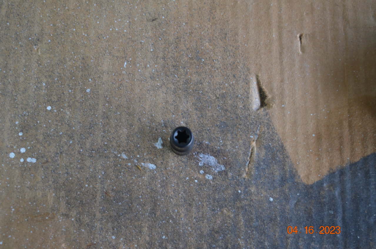

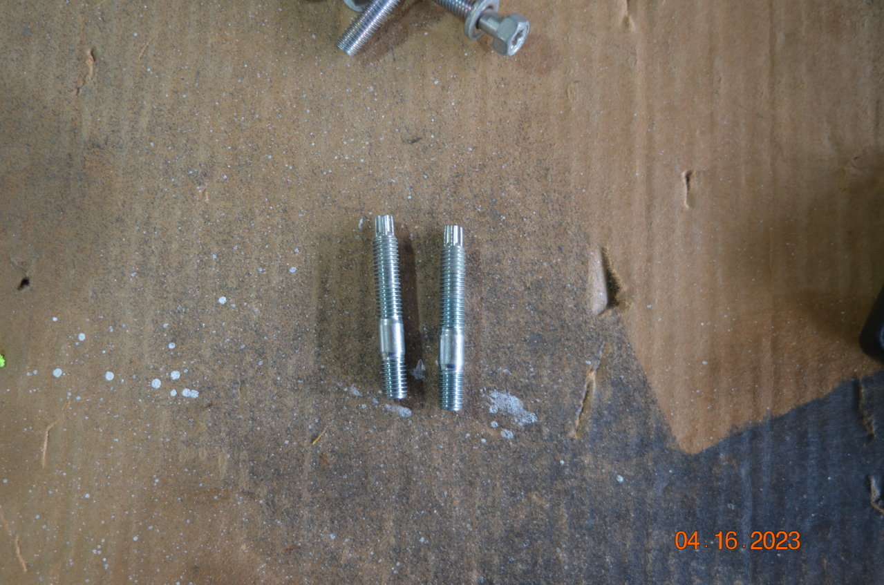

    Time to remove the studs. I did this before I removed the manifold. I didn't use the 2 nut trick, because I had an E8 socket that I used to remove them. So......no having to remove the manifold and stuffing rags in the intake runners. 5-Manifold Stud removal with E8 socket (1).jpg 5-Manifold Stud removal with E8 socket (2).jpg 5-Manifold Stud removal with E8 socket (3).jpg

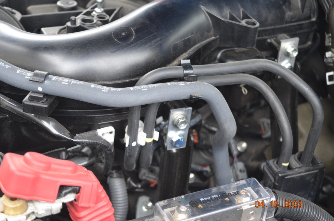

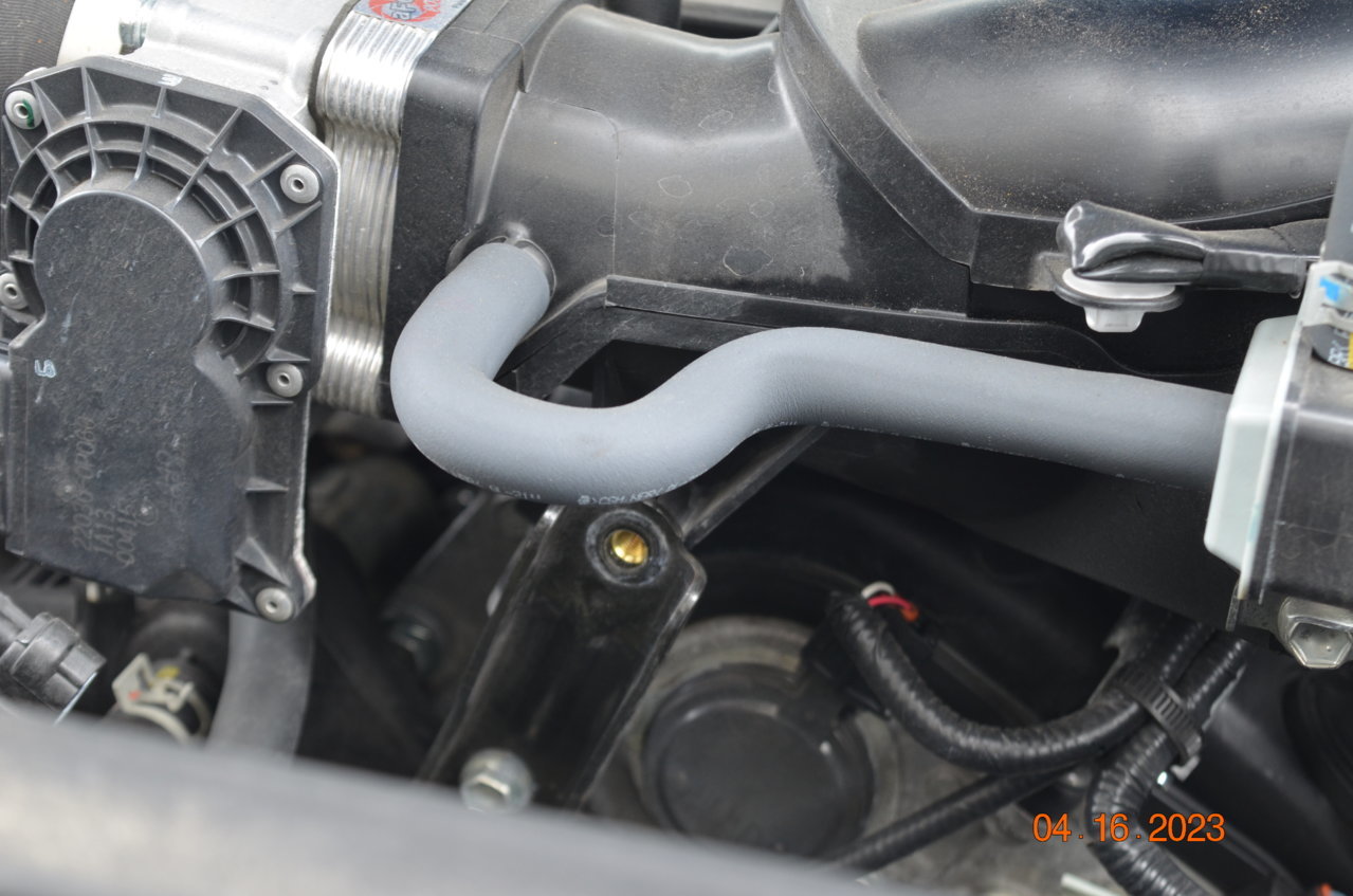

    Next I put the washers on the bolts and put the manifold spacer on the truck. Everything went pretty smooth until now, and it still wasn't as bad as I thought it would be. That wire harness was a bitch to deal with, but I moved it. Then I lined up the manifold and the spacer and put the bolts in. This was SOOO much fun!!
    6- Bolt prep.jpg 7- Manifold Spacer installed (1).jpg 7- Manifold Spacer installed (2).jpg Now mind you, I did all of this with no help, so it can be done with one person.

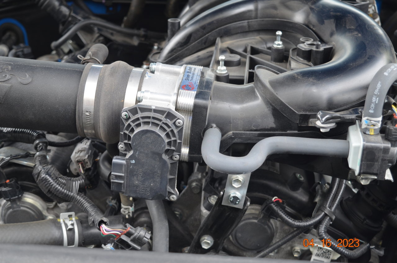

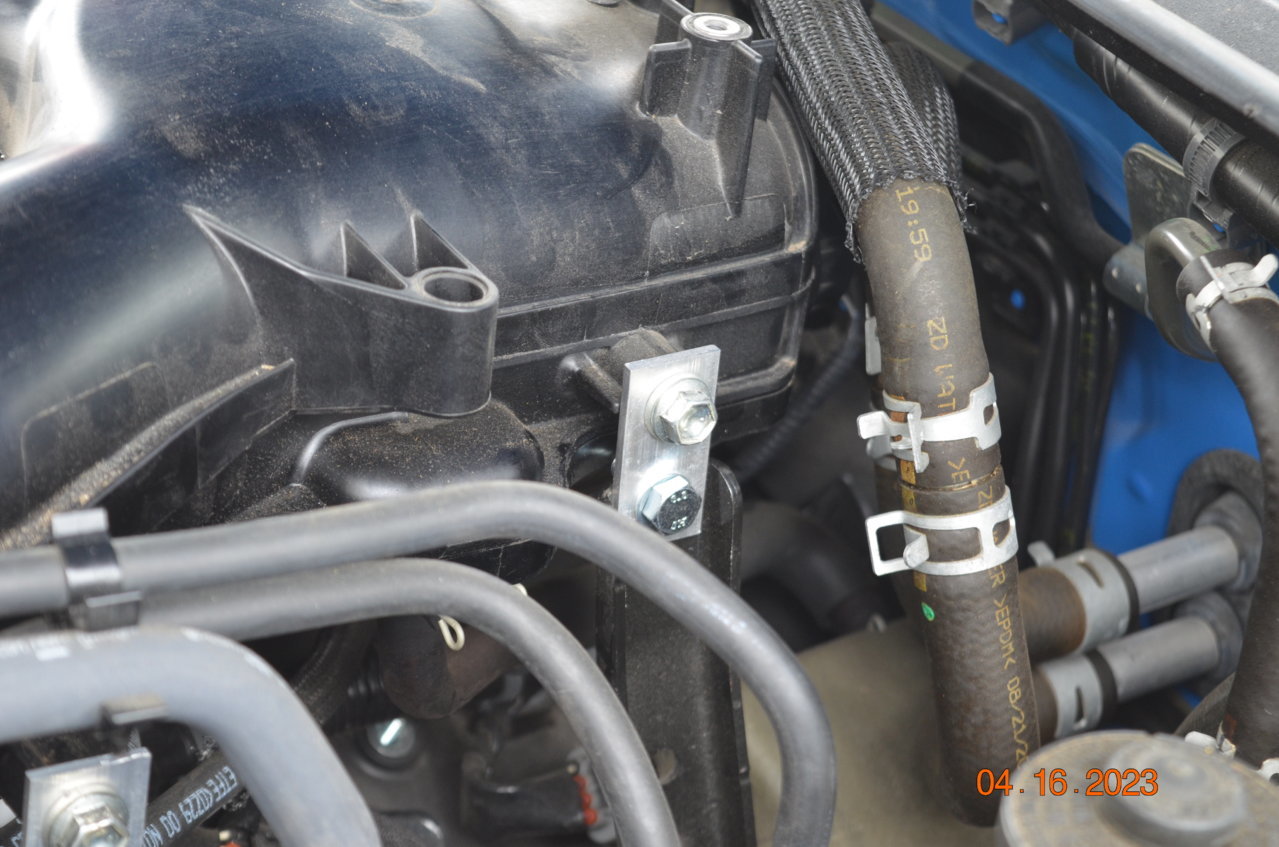

    Then I put the brace spacers on and tightened them up.
    Started the truck to check for leaks, and called it a day. I haven't driven it yet, so I can't tell you if it made an improvement right now.
    But stay tuned, because I'll give a report back on this thread when I do drive it. 8- Manifold brace spacers installed (1).jpg 8- Manifold brace spacers installed (2).jpg 8- Manifold brace spacers installed (3).jpg
