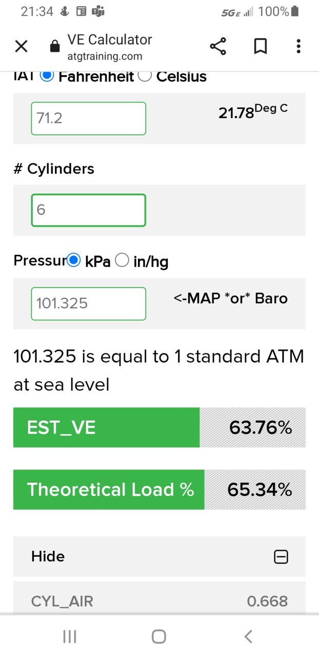

  16. Apr 18, 2023 at 9:25 PM
    #56
    Vlady
    Vlady Well-Known Member
    Dec 20, 2017
    #238986
    4,493
    Issy, WA
    2017 White SR5 DCSB V6 4x4
    Log basics before and after on the same stretch of the road driving normally and a few pulls.
    Accelerator, throttle, Maf, load, rpms, fuel trims(short&long), lambdas, ignition , intake air temp, tranny gear, torque converter status.
    We could calculate volumetric efficiency say at 2000 rpms based on average of captured data and compare 2 sets of data. Theoretically, spacer's data should produce higher VE % for given conditions vs non-spacer.
    So I pulled my techstream logs and punched the numbers into VE calculator. The calculate load in techstream for given conditions is 65% and matches the calculator
