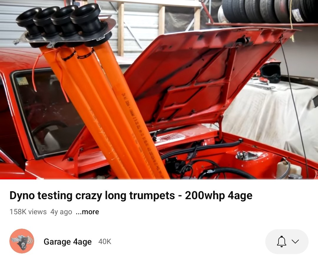

    I'm half serious about doublestacking a pair. I live in a super hilly area, I need all the torques I can get at the low end.
    If anyone wants to spend an afternoon down the youtube rabbit hole. The channel Garage 4age has a whole bunch of dyno tests with all sorts of different intake runners and intake designs.
    Edit- he also has a pretty kickass hilux.

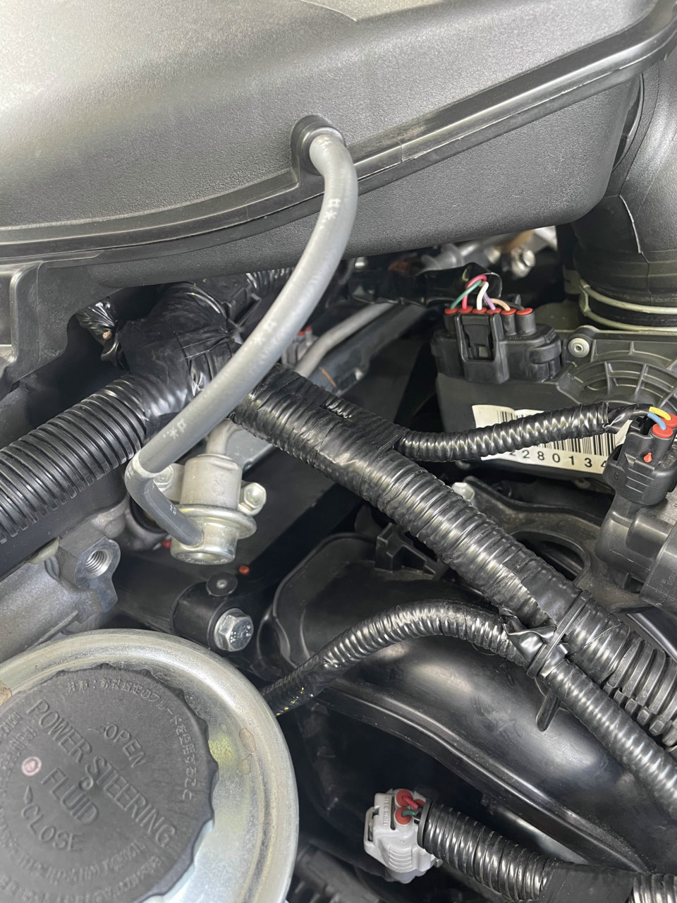

    Got it installed i would say not for the faint of heart, simple but more challenging than expected just a tight spot especially for that pcv hose. Kit is nice but some of the brackets required modification and the replacement hose for the intake was the wrong size. Instructions are over detailed for some parts and lack luster on others. They intake hose included is 3/4 while the old one was 5/8, i am assuming he did that for an easier install as the 5/8 hose needed to stretch a bit to fit on the intake side, it slide right on to the valve cover. I made new brackets to space the intake mounting over as i did not care for the ones in the kit, also had to modify the brackets for the very 2 bottom mounting bolts on the manifold. Overall mostly there but did require some modifications, on a quick drive i notice a slight difference hard to tell. I am going to give it a few tanks and report back, after i installed the lce header it took a few tanks of fuel for the computer to adjust and feel a difference.

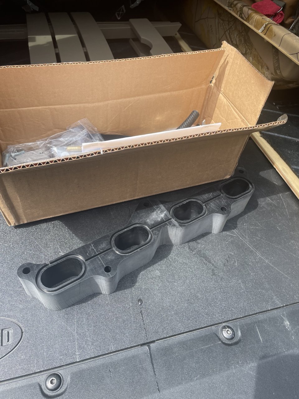

    I received shipping confirmation for mine which should be arriving tomorrow, aiming to install on Sunday. Currently only have about 500 miles on my truck but I have already become pretty familiar with how it runs. I can say that even on my way home from the dealership I could tell it needed some improvement certain areas, it literally felt like it was misfiring at times and one area that even my wife noticed as a passenger was when entering our driveway in 2nd gear it just didn't seem to know what to do and sputtered a bit. That was corrected after my first fill up of fuel using 93, took away 90% or more of the low rpm issues and smoothed it out significantly but still wishing there was more torque. Hoping this will improve that while I continue waiting for my VF tuner cable as a tune will be the next upgrade in effort of making this V6 drive more like a truck should. Regardless of how much or little improvement there may be, I still love the truck just the way it is.

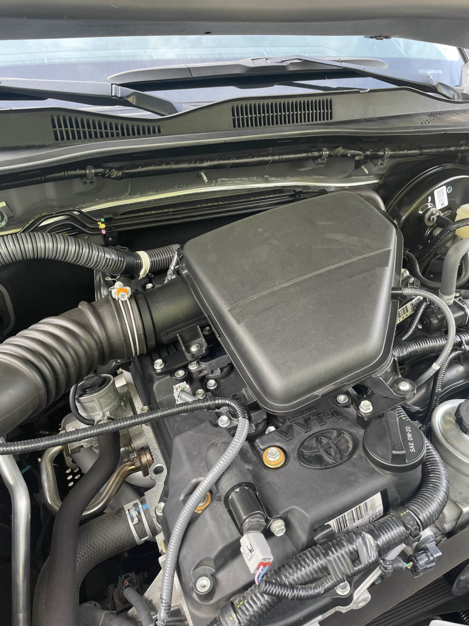

    Managed to get this installed today, was pretty straightforward and simple overall. I did not run into any issue which required modifications to the extension brackets, and the only issue with any wiring being in the way was the big plastic housing in the back which houses the wiring behind the manifold. I loosened the nut on the one side, popped up the other side and some harness clips further away to get some slack while I installed the spacer and manifold to the engine. The most difficult part for me, which wasn't all the difficult, was lining the spacer and manifold to the engine and getting the first bolts started. Nothing else caused any issues worth mentioning. Some things to mention about my particular truck that may be different than others - manual transmission so the clutch hose and line were present, not sure how the automatic differs under the hood in that area or any additional wiring being present. Mine is the 7 bolt manifold, I saw that some have 7 and some have 8 bolts. Everything else under the hood is stock, and only 550 miles total on the truck. I only had time to spin around the block just to make sure everything was alright but once I get about my normal trips I should have a good idea of any difference as most of the places I go are a lot of uphill in one direction and downhill back so I will see how it reacts keeping in higher gears than usual.

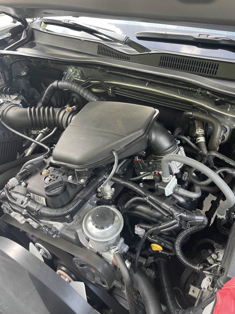

    The install wasn't especially difficult or hard to follow per se but mostly just consistently irritating due to accessing the center of the engine bay in my truck being much worse than I'd figured due to lift and tires. Just a lot of steps to track, bolts to keep track of, and a lot of different socket sizes to cycle through. After install I let the truck idle a while as the idle in Park initially seemed a few hundred RPM higher (I figured the tune would need to adjust to the altered air flow setup, so I did what I'd read others doing when changing to higher flow throttle bodies), but it soon adjusted down to normal ranges and I've not had a single issue since.
