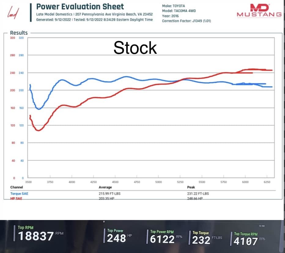

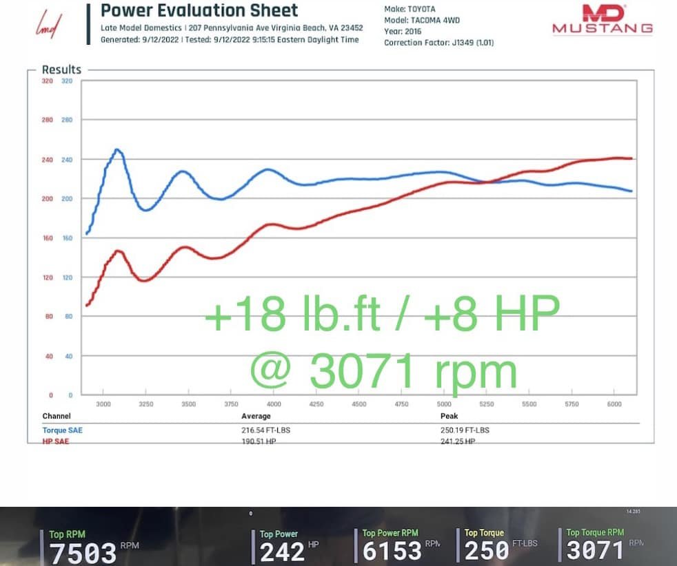

    Figured I'd get all the info in here. Here are the dynos from the FB post linked above.
    As discussed above, yes... these charts are annoying. The Stock chart only starts at 3500rpm, where as the modded chart starts at around 2750rpm. Very annoying given this prevents any direct comparison in the lower rpm range, isn't that exactly the whole point of this mod!? Perhaps cutting off before 3500 on the stock chart was intentional?
    It also wouldn't be difficult to for them to get the raw data of both runs and place them on a single chart.

    Thanks for the pictures, FB was being terrible
    Dang, the dyno shows the two runs were less than 45 minutes apart. Did they swap that over that quickly?

    From reading the install, yes, I think you could get the spacer on in around 30mins (says me who's never done anything like that before).
    wahoobie and Firn[QUOTED] like this.

    I would still love to see before and after dynos that start at the same rpm, specifically showing lower rpm given it's making the torque more available low down that's meant to be the value proposition of this product, seems madness showing an 'after' dyno that starts at 2750 rpm, and also not showing me what stock looks like until 3500rpm onwards.
    Firn likes this.

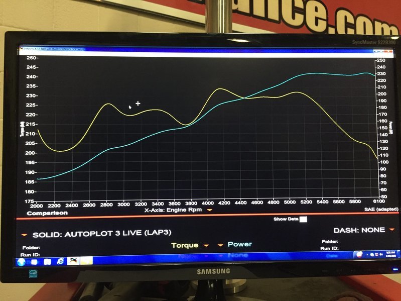

    Heres some stock dynos from here on TW.
    AndrewInCanada and Junkhead like this.

    You can't compare a dynapack that measures at the hub to a Mustang dyno. Mustang dynos are going to read lower.
    And for everyone asking for a low RPM pull chassis dynos don't work that way. They're typically not accurate until at the lowest 2800ish RPM but usually higher than that.
    TireFire likes this.

    Just one of dozens of examples here on the forum. I’m not making any comparison.
    ktbell444 likes this.

    The tire oscillation alone :(
    Hub dyno or a low profile tire on 15" rims would have been so much better to capture but alas NOT real world at all.

    youre telling me a spacer adds 18ft/lbs of torque? can anyone confirm im seeing this right haha?

    some people really need to look into the effects of intake runner length. lengthening them with a spacer should absolutely lower the torque curve. but also this is a give and take deal. your sacrificing high rpm power for thism considering theres many people that have never gone over 4000rpm in their truck at all then this can definitely be worthwhile.
