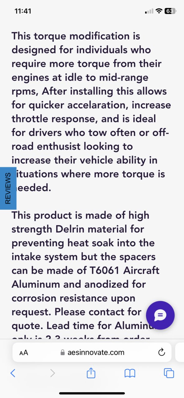

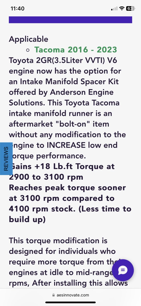

    I'm interested in this, if there is some 3rd party dyno results to see. Already considering a tune, so it will be interesting to see if someone can dyno a tuned v6 without and then with a spacer. $3-fiddy for an inch of delrin slab seems steep, but the basic premise is sound.

    Ugh... fine. I'm buying one for my L4 manual and i'll tell you if it works or not, but i'm not doing any dyno crap. Either it obviously tows better or it doesn't. If it doesn't, i'm not gonna lie to you just to make myself feel better - IT'S ONLY $300.
    These pissing contests are annoying. Physics says "this happens because science", users say, "this works just like science said it would", but Bubba Knowbetter be like, "Derpa derp, science is hard, i don't understand so it's stupid, and so are you, waste of money 101, derp..." (italicized for dumb-shit voice)

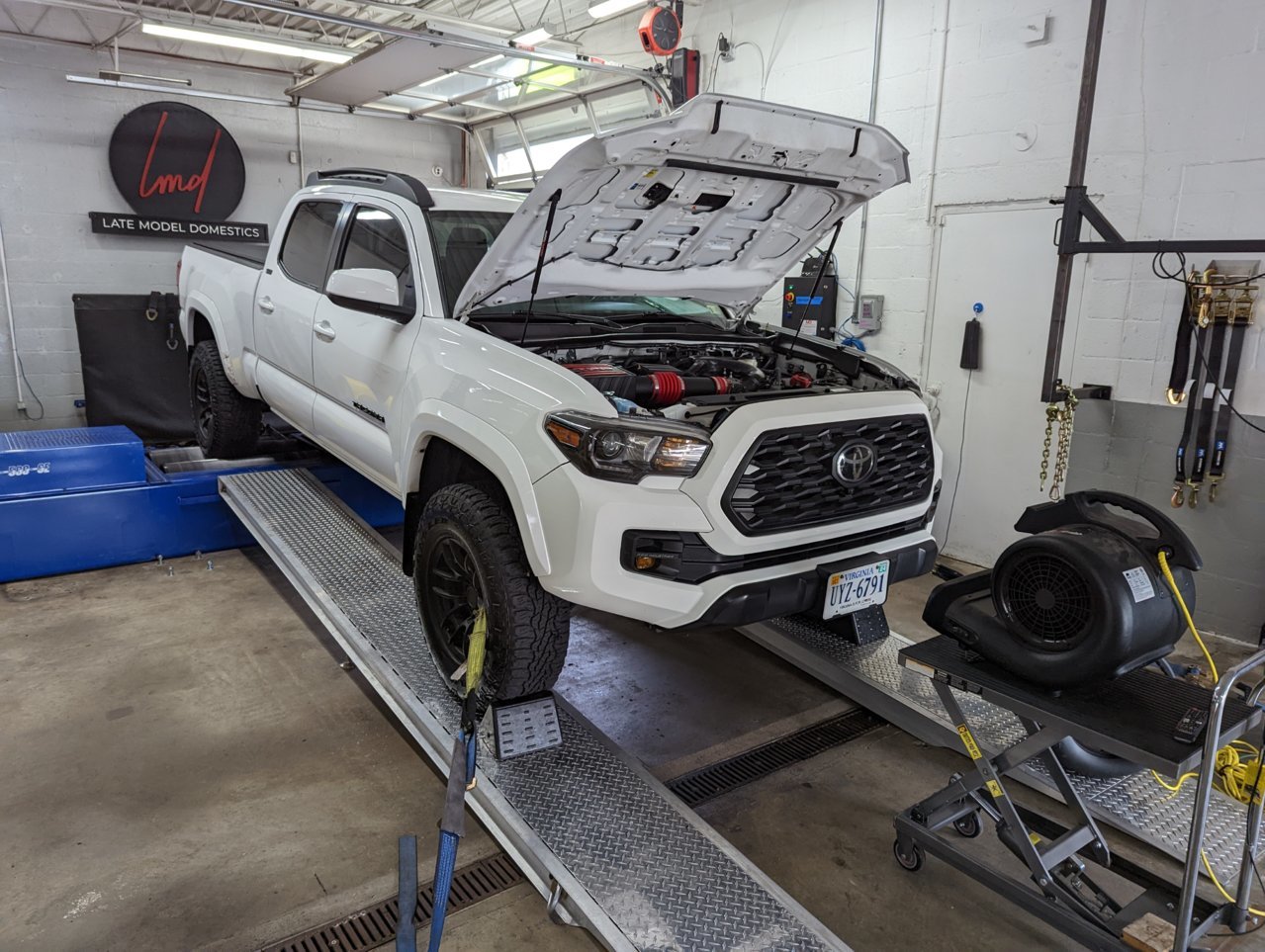

    You are good to go sir! I'd really like to hear your thoughts on it also. I've been running it for months now and given your experiences thus far per-spacer vs with-spacer are greatly appreciated!

    Premise sound indeed! I offered my truck to Shawn for the stock and spacer dyno runs. Though the dyno was difficult to capture the lower RPMS based on my setup (tires/stock tune/non-hub dyno challenges) the results captured were from those runs that Shawn uses. Having the spacer on my truck while performing real-world stock tune testing also was a welcomed improvement though of course all the other stock tune limitations were readily apparent to me.
    I was very happy to get updated to KDMAX Pro (v9) after the dyno and road use testing was completed. I think it's a great combination which to me resulted in a slightly lower shift of the powerband. If you are looking for max gains and drag racing I don't think this option (think FI for that venture) but for an easy bolt on that helps improve one of the poor areas of our awesome trucks I'd say it's worthy of the cost. Par it with a KDMAX Pro tune and you've got a nice new truck that is the way it should have been stock.
