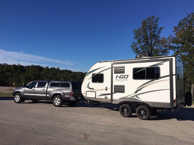

    Love mine:thumbsup:. My camper weighs 4200 ready to go. I think the hitch weighs 48 lbs total and is real easy to set up
