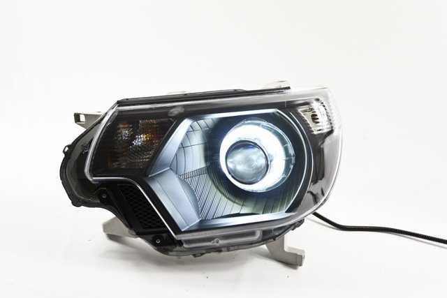

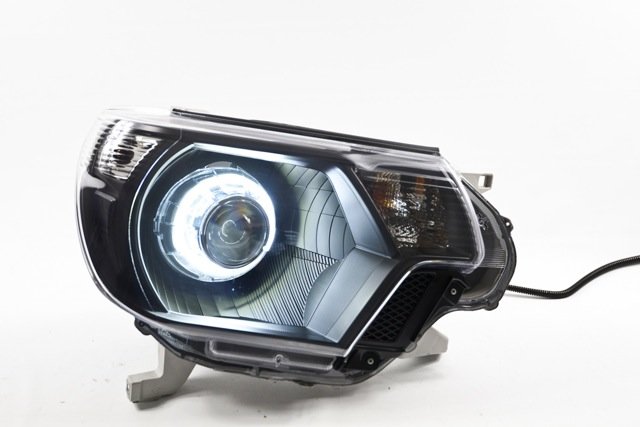

    Like this?

    Kind of yes.

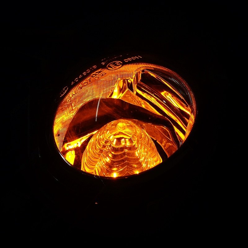

    Are you planning on doing anything with the wy5w corner lights? I cant decide what im going to do there. It just seems out of place.

    Yes, that was shown a while back. Koito amber LED behind a Carclo 20mm rippled lens:

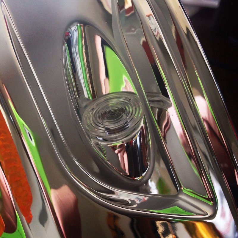

    Fog lights are cut open. LED test-fitted.
