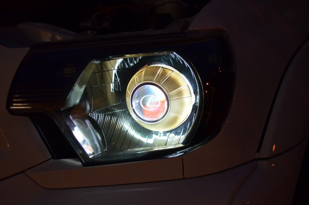

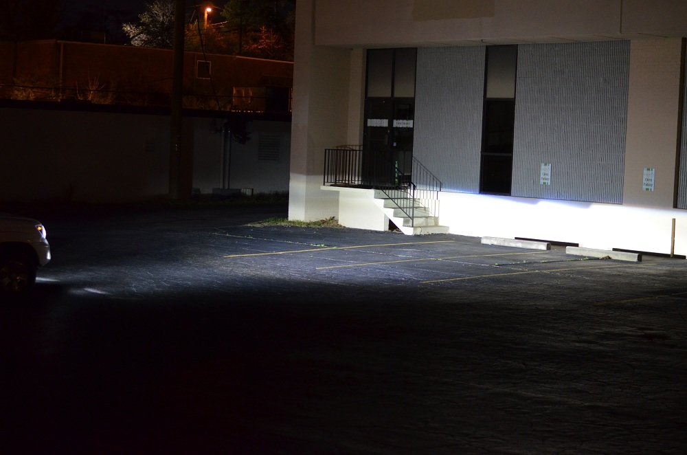

    Output shot. You can see how the driver's side is slightly rotated clockwise. I'll fix that the next time I have a few hours free.

    Curious as to how you would fix this when you already glued the projectors like so
  4. Mar 31, 2014 at 4:12 AM
    #164
    TRSAndrew
    TRSAndrew [OP] Instagram: @apissues Vendor
    Jan 3, 2012
    #69858
    3,348
    ATL
    ‘22 4Runner, ‘14 F150, and I’ve had 4 Tacomas (‘12, ‘15, ‘16, ‘18), 2 FJs
    Cut it out! :cool:
  5. Mar 31, 2014 at 4:28 AM
    #165
    TRSJimmy
    TRSJimmy All I Do Is Nguyen
    Jul 10, 2012
    #82308
    3,088
    Jimmy
    Gainesville, GA
    12' Mall Crawlin Peerunner
    I was hoping an easier answer haha Mine is slightly off by a degree or so. Doesn't bother me as much, but I want it perfect!
  6. Mar 31, 2014 at 7:26 AM
    #166
    Edpsx
    Edpsx Well-Known Member
    Oct 7, 2013
    #114018
    147
    DFW
    13' Double Cab Limited MGM
    K&N Intake, Stainless Tube Steps, Pioneer 8500BHS, Coming Soon:, Morimoto H1 Mini, Viper 5704
    Haha, mine was the same way. I actually stuffed washers in between the housing and the fender bolt to raise mine back up to level so I didnt have to cut it back out, but mine was only off by a degree or two. The fender bolt is plenty long enough to be able to put about 6-8 washers and still bolt down too. It would be nice if we had a rotational adjustment knob though.

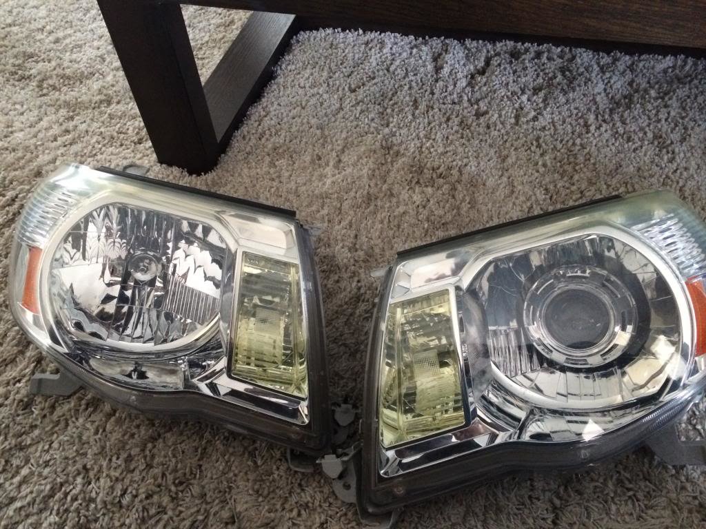

    This is sick. Question: what is your opinion of using tsx clear projectors on a Tacoma retro? I've had them sitting in my garage since two cars ago and glad I still do have them but I realize I would lose high beams with them.

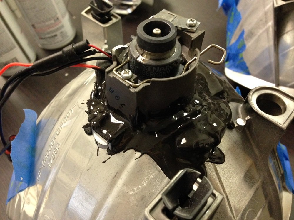

    Is this the same stuff you guys sell on your site or something different? The only reason I ask is that in the last two kits I have done it black vs. they factory grey.
  9. Apr 2, 2014 at 7:41 PM
    #169
    XXFattyHunterXX
    XXFattyHunterXX Well-Known Member
    Sep 18, 2012
    #87200
    136
    Westminster, Colorado
    T4R
    Yes the black stuff on TRS website, i tried getting the gray ones from my local dealer but the parts guy didn't know what i was talking about.

    TRS should have the gray Koito butyl rubber. Be warned, it comes in a block and you have to heat and cut off pieces to use.

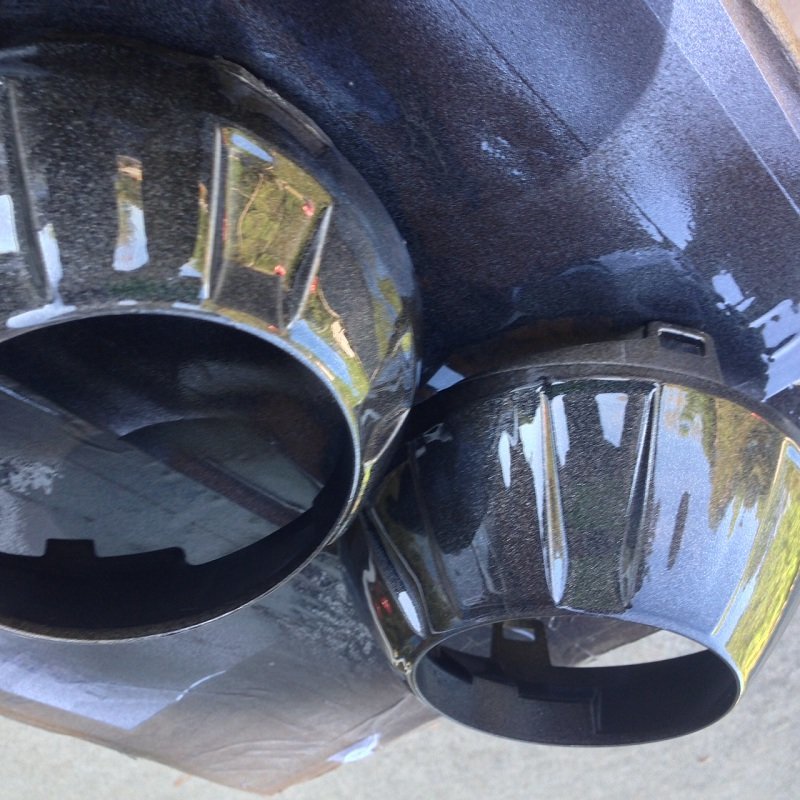

    Looks wild with the LED ring on. Makes me want to strip off the paint and tint the shroud instead. Lol

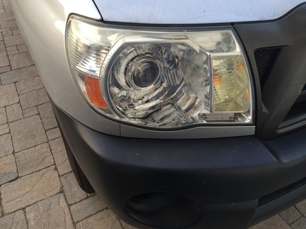

    Thanks Andrew for all the great support. These guys really do a great job in the support area.
    2006 Regular Cab
    If you want I can take a picture of my light output. The light output is clearer then my Stock Audi

    Mito which projectors did you use, 460's?

    Sorry i don't know what they are called since TRS sent me a new pair as the first set didn't fit.

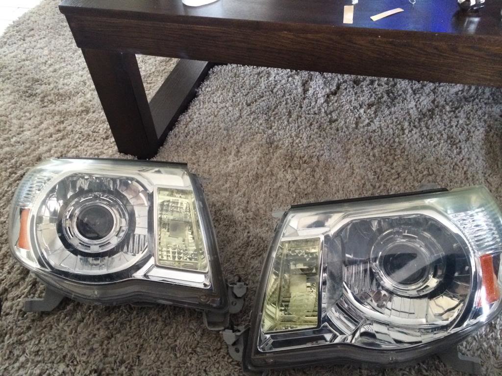

    Back in they go!
    Left - Fix rotation issue
    Right - Re-tune cutoff for more color
    Both - repaint shrouds
