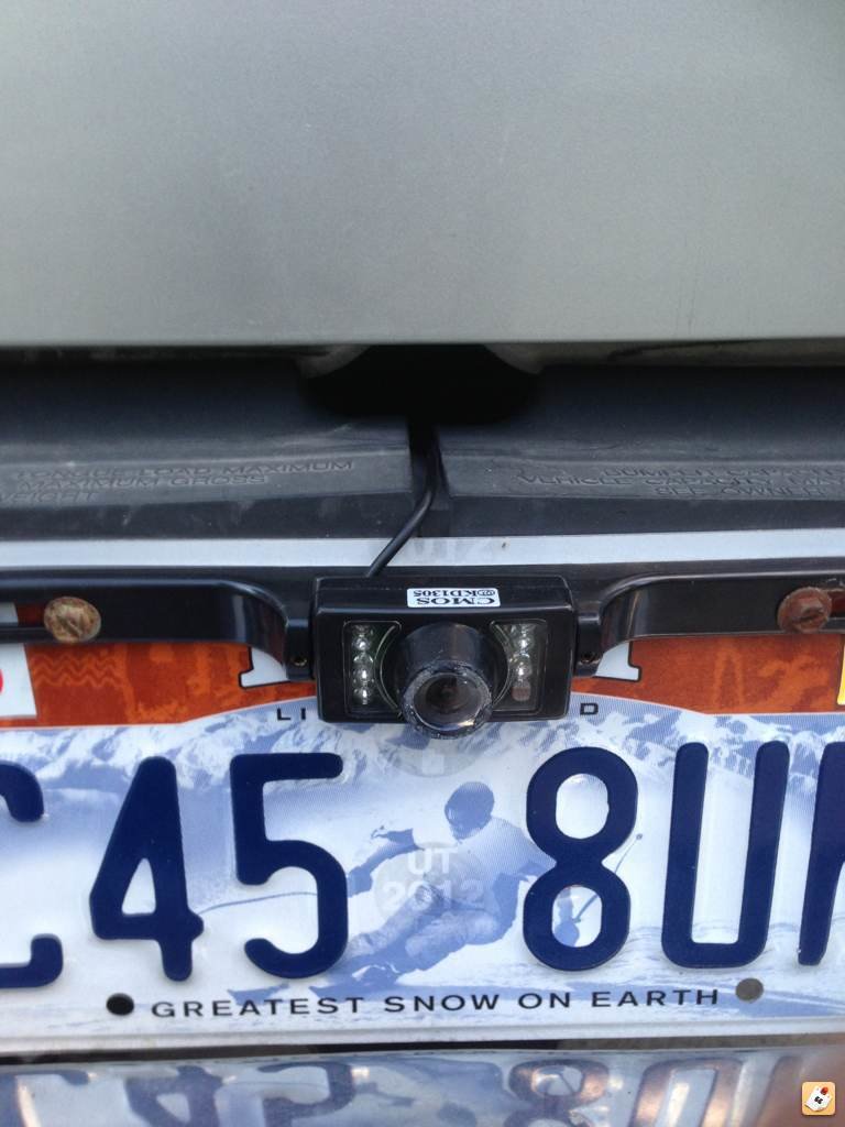

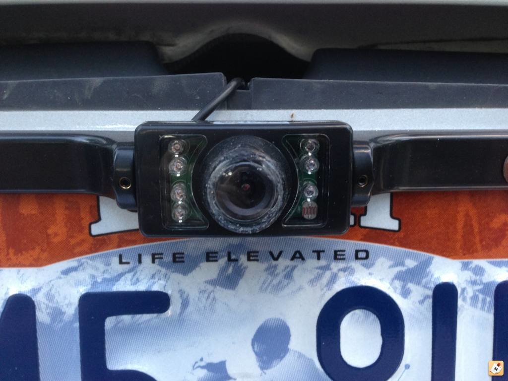

    So I finally got around to buying a backup camera for my truck. I usually don't have any trouble backing in/going in reverse, but looking through three tinted pieces of glass (rear, shell front/back) at night can sometimes be a bit tricky... So, for peace of mind (and my girlfriend's sake) I installed this thing.
    I got a liscense mounted Koolertron CMOS camera off Amazon for like 12 bucks. I decided I wuld add a bit if silicon, cause I doubt this thing is too waterproof...

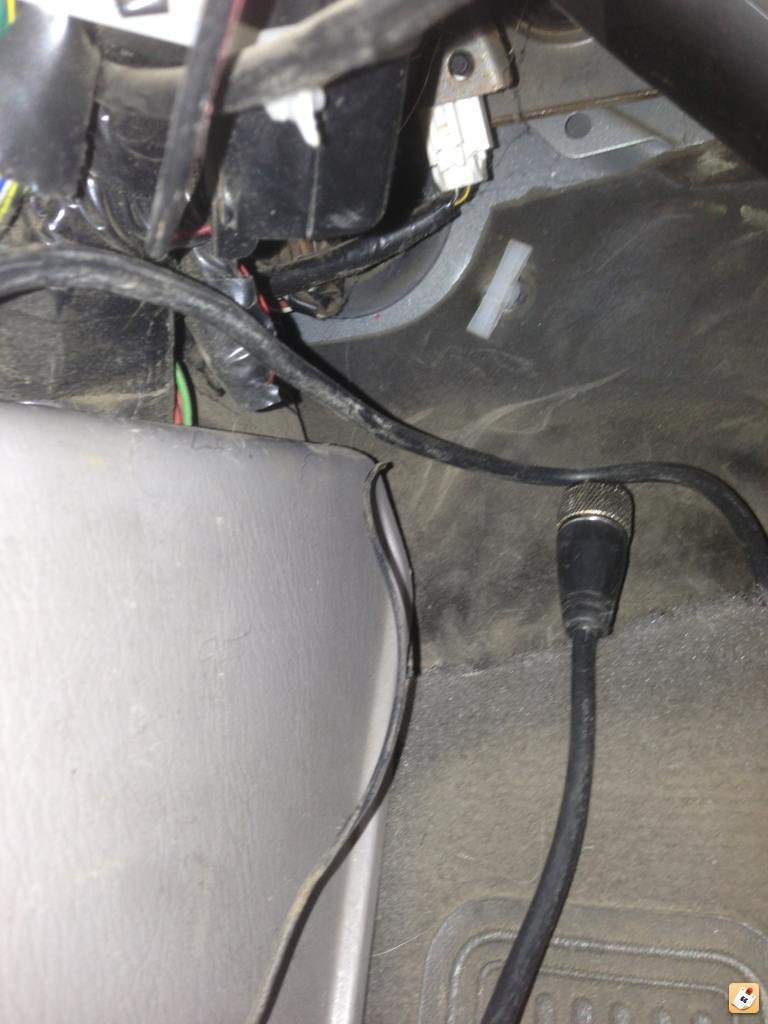

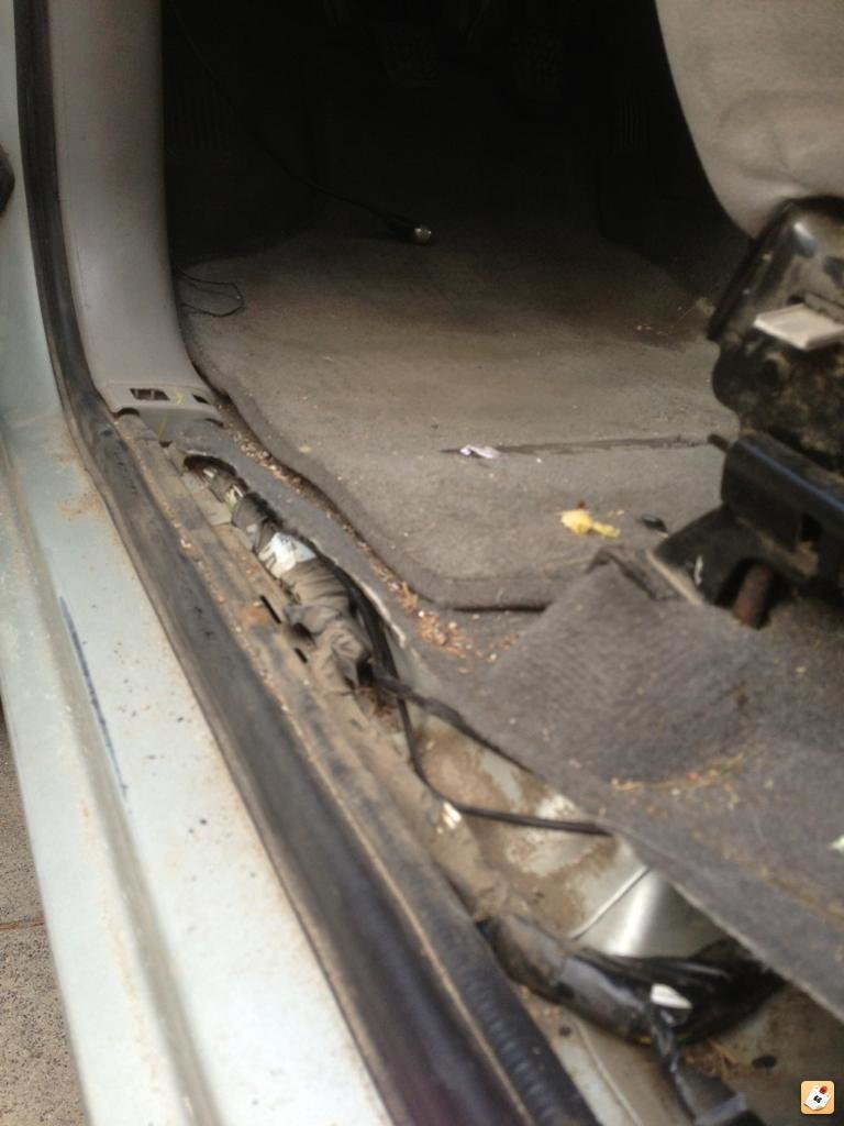

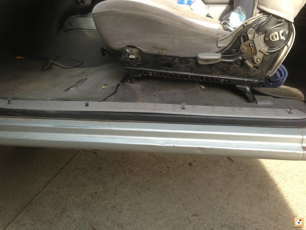

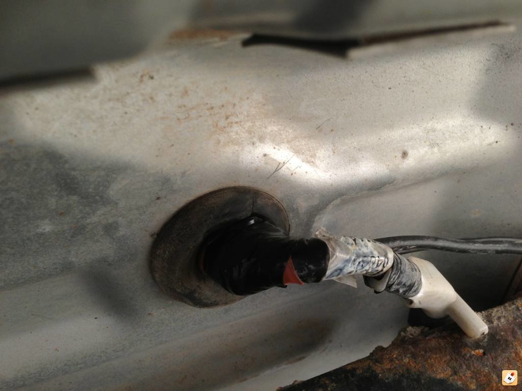

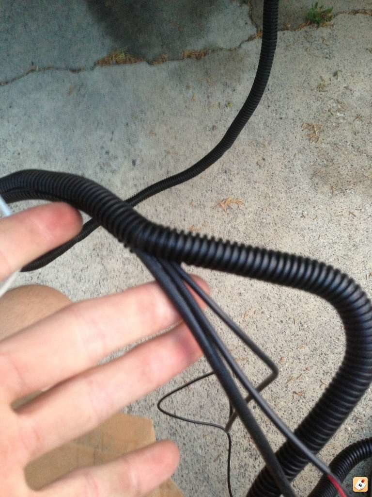

    I tucked the wiring for it, along with he coax cable for my CB into a wire sheath and ran it to the front if he truck alongside the factory wiring harness. Then I ran he two wires up hrough the weatherproof grommet under the drivers seat.

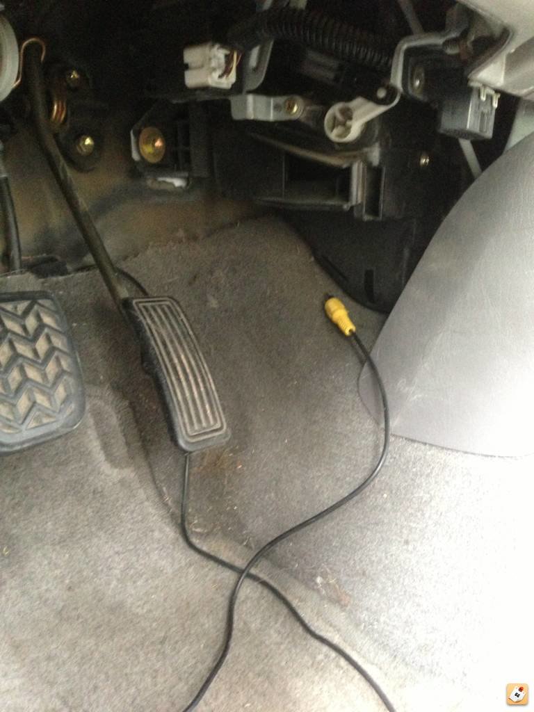

    I remove these four screens for the kick plate and yank out the trim next to the dead pedel which allowed me to run the wires under the carpet. The coax went up by the cutch and into my CB (finally!) while the yellow RGB cable went further aroun towards the head unit.
    I got it all plugged in to my head unit, you have to remove the dash trim and take the HU out, but didn't bother to take pictures of that bit.

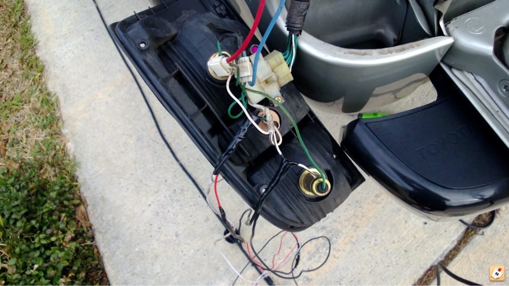

    Took off he drivers side tail light and tapped the red wire into a green wire that lead to the reverse light bulb, and hooked the black to white wire with black stripe as the ground.
    Aaaaaaaand, it doesn't work. I think I need to connect a wire from my HU to something that only gets power when in reverse.
    So I'm going to follow the green wire from the taillight to the dash and tap into it there. If that doesn't work, I'm going to try plugging the video cable into the AV in port rather than the backup camera port on my HU. The camera won't kick in automatically when I put it in reverse, but I don't foresee using it every time anyway.
    Stay tuned for the resolution! Sorry about grammar and spelling. I'm on an iPhone, will come and edit later.
