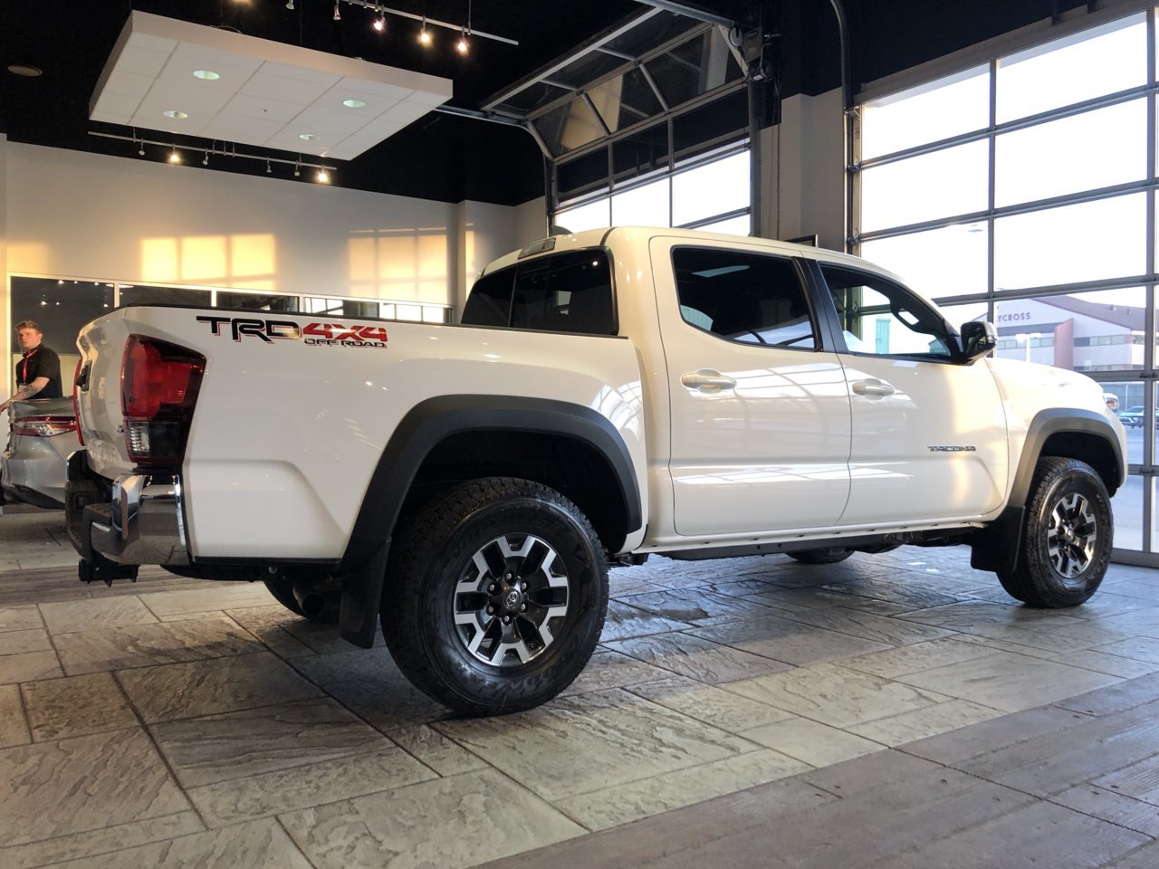

    So here goes my build thread. Pickin it up at the dealership. Mint condition.

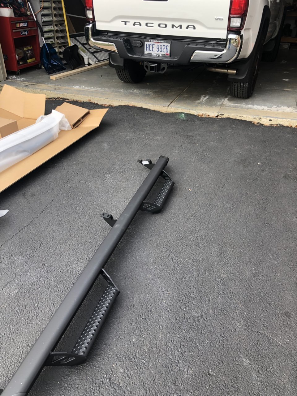

    I added some predator steps on her about a week later. :)

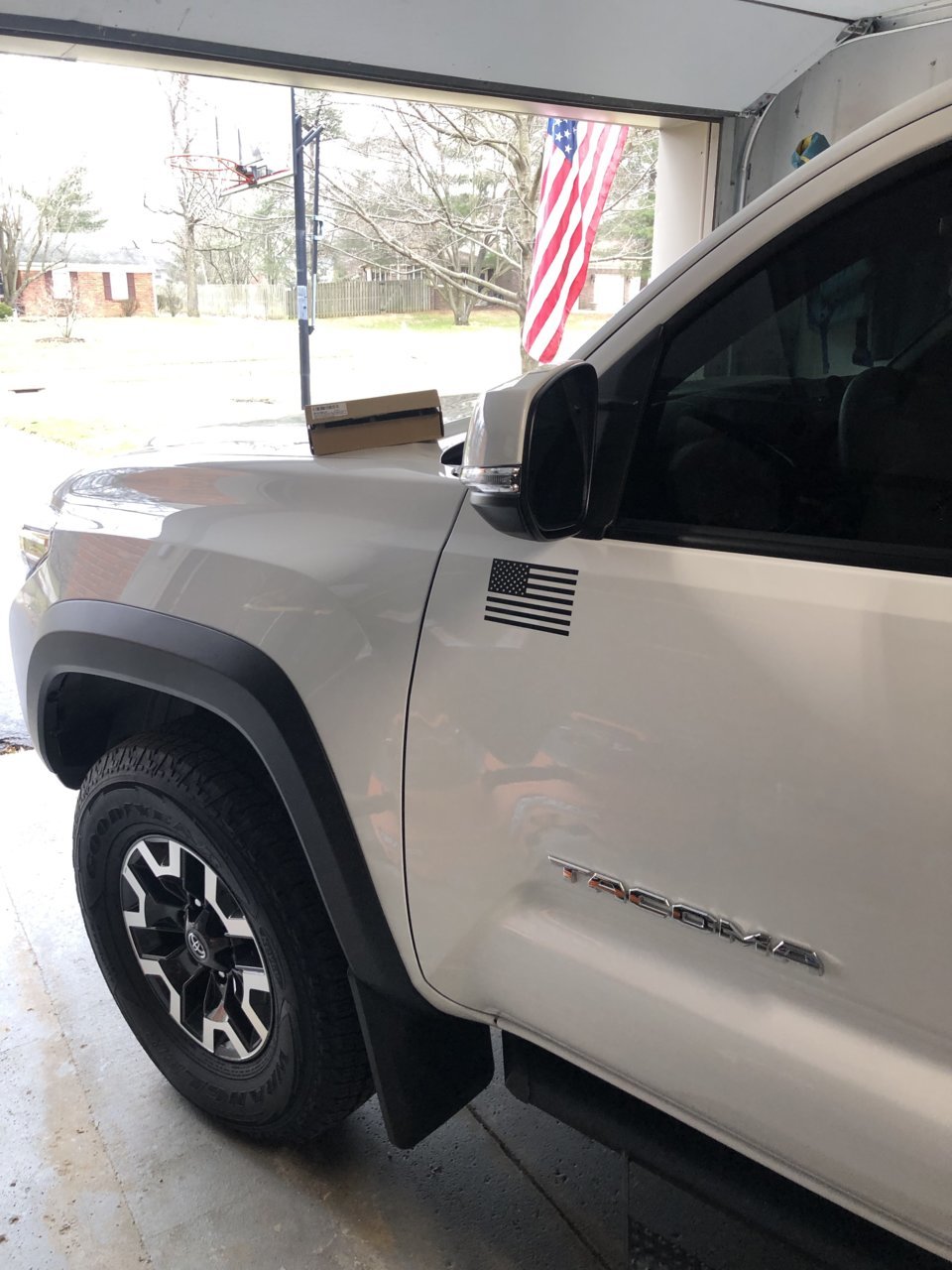

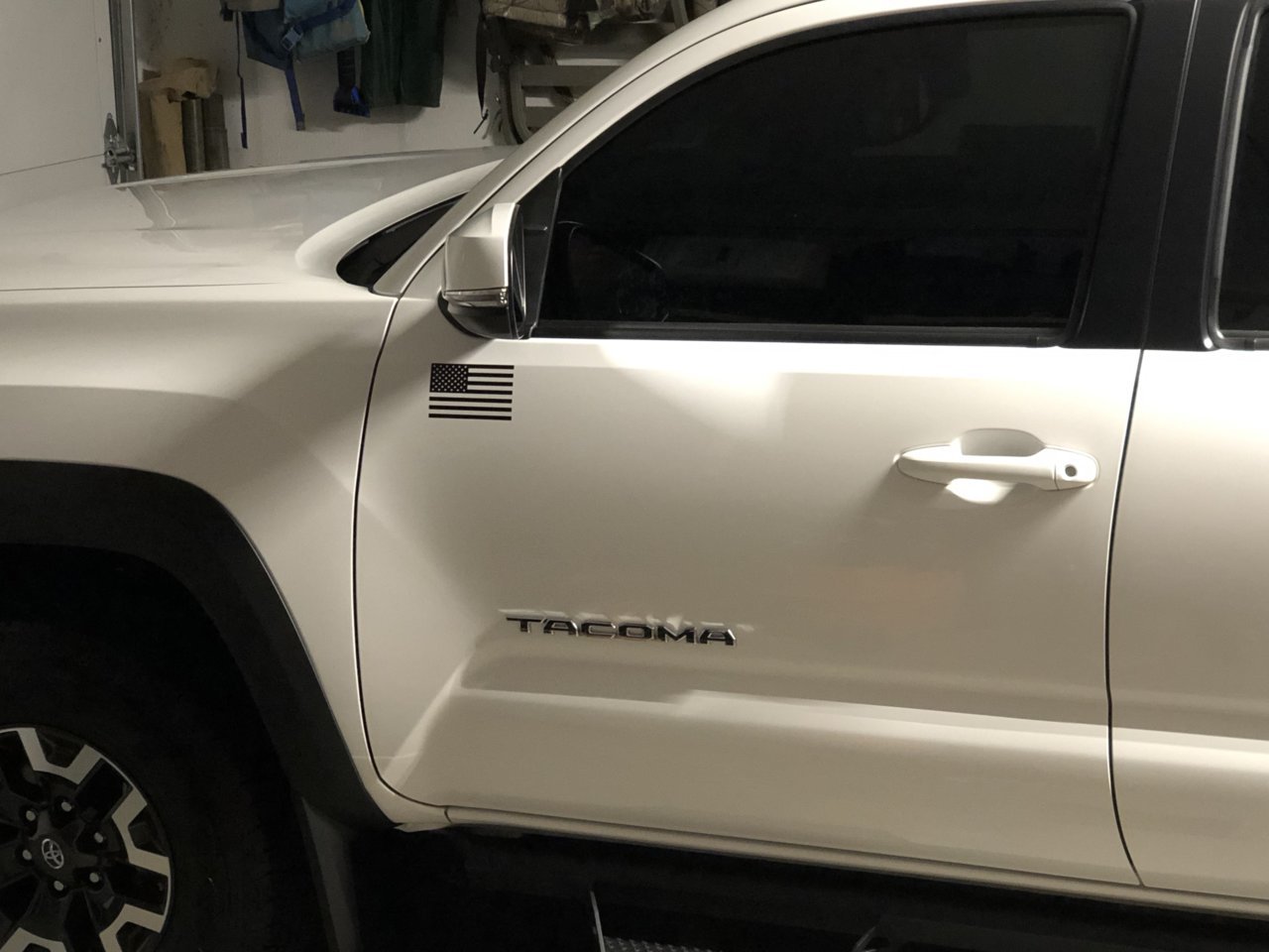

    Next I added some decals.... on both driver and passenger side. I think these looks sick.

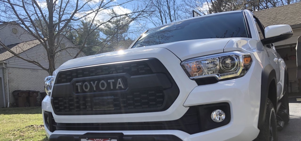

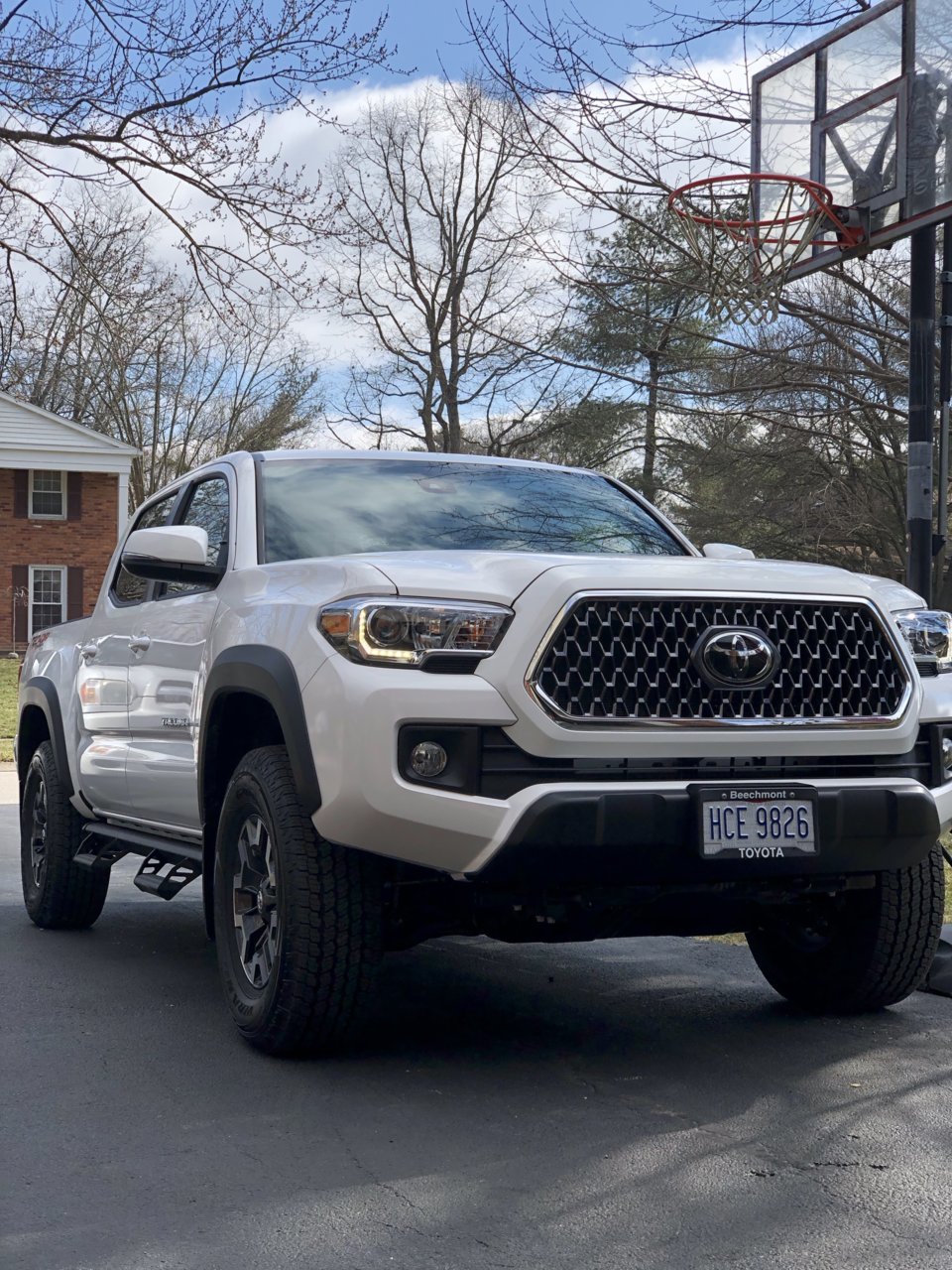

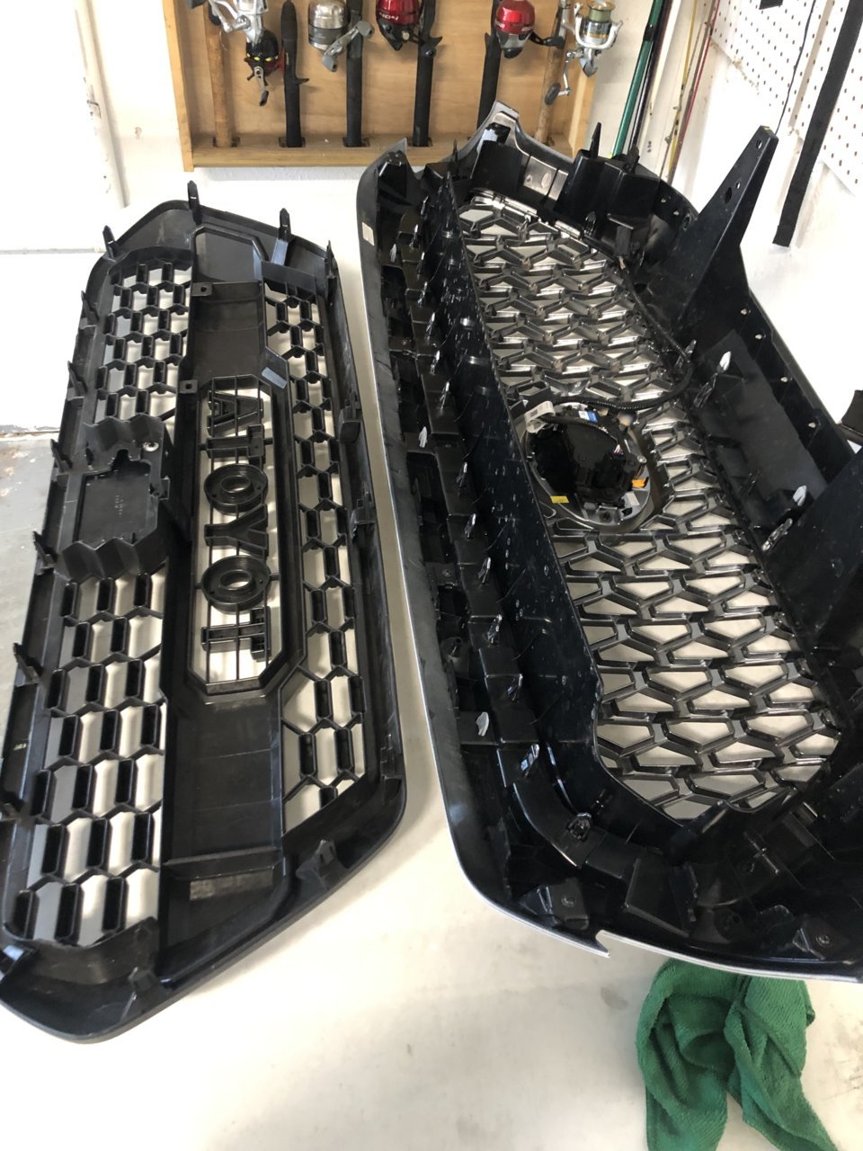

    I had to do it. TRD Pro grill was the next upgrade.

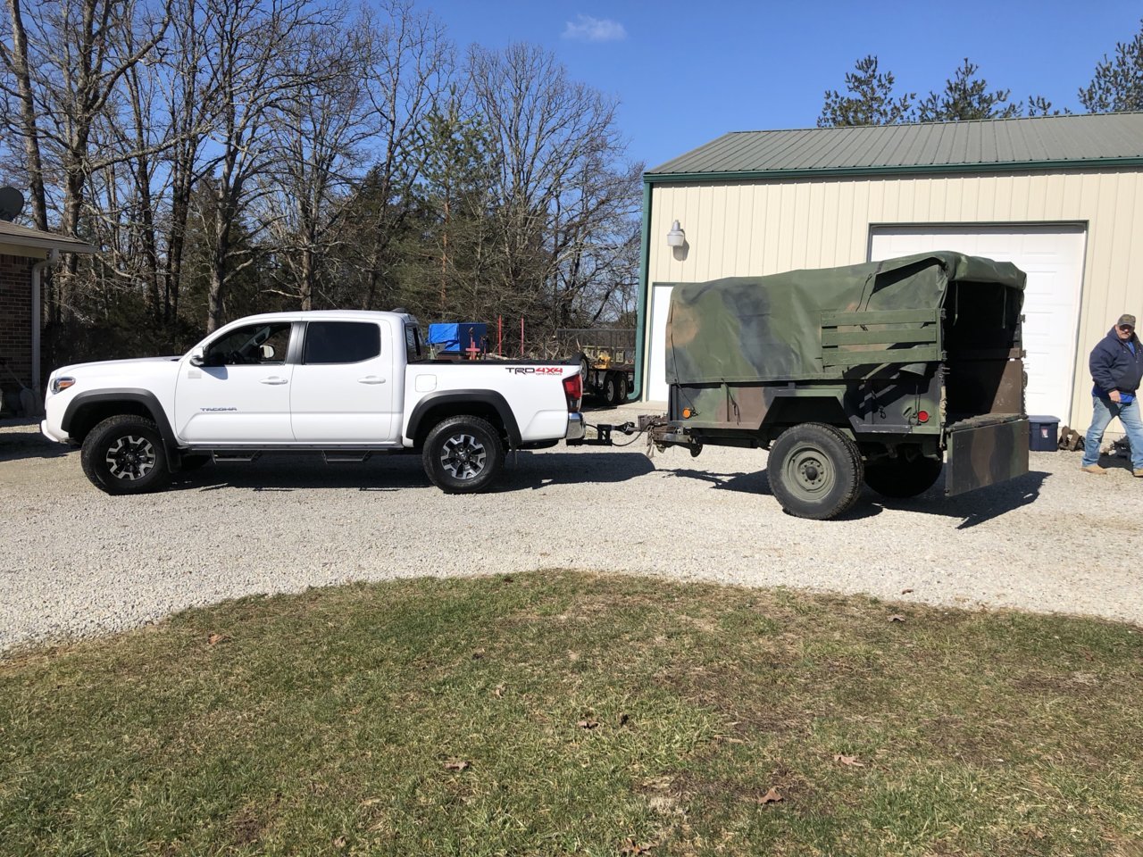

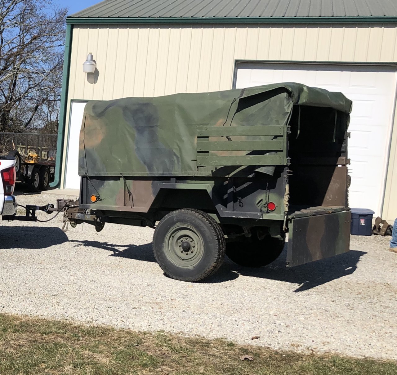

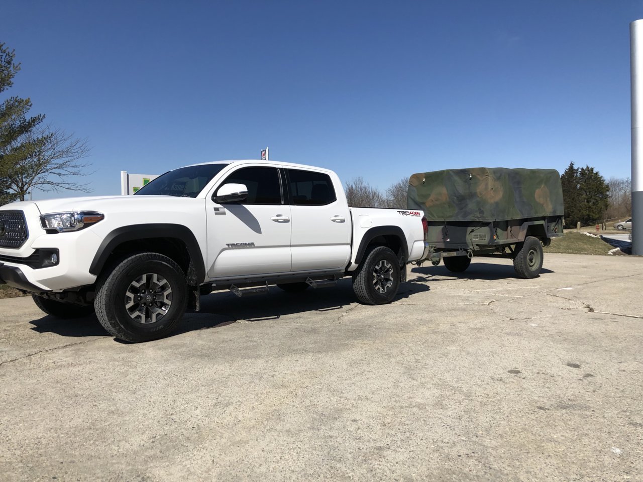

    Purchased my overland trailer today. It's an M101A2 trailer. It took a while to find the one that I wanted in good shape. I had to pay a little more for it but it was totally worth it.

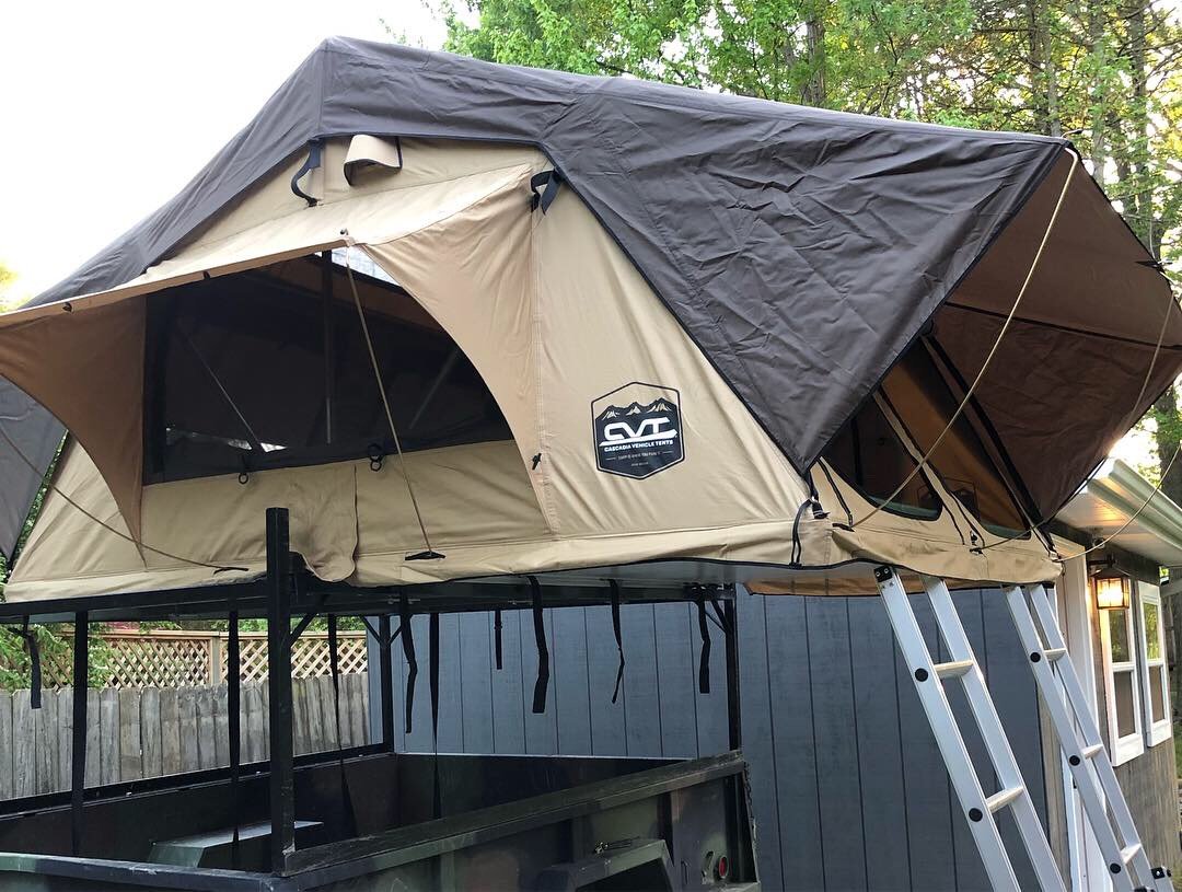

    CVT tent is on the way!! Here is a picture of what will be showing up this next week!

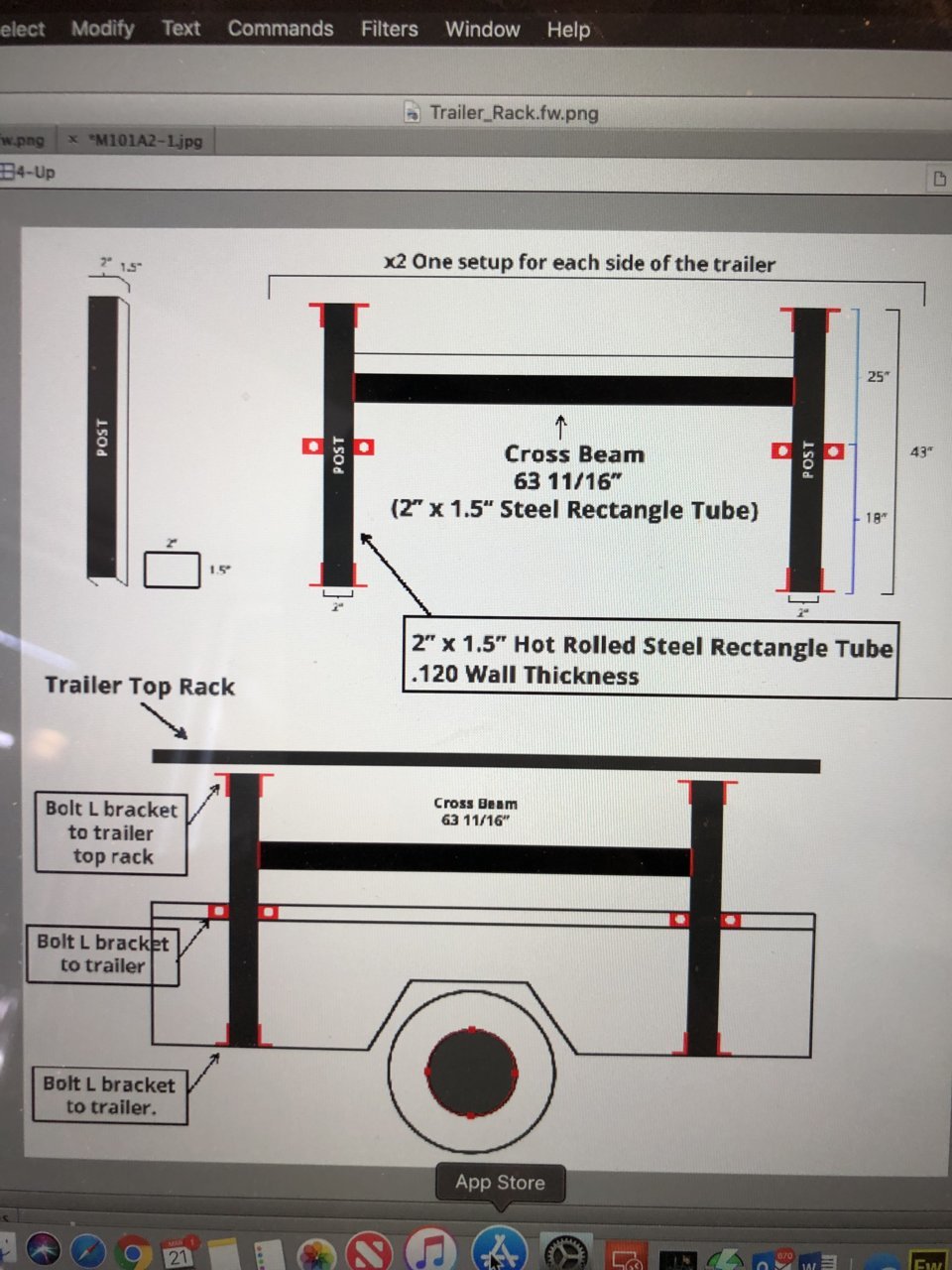

    The CVT is here!! Now to finish up these plans for the trailer rack.

    Also new pro grill is on!

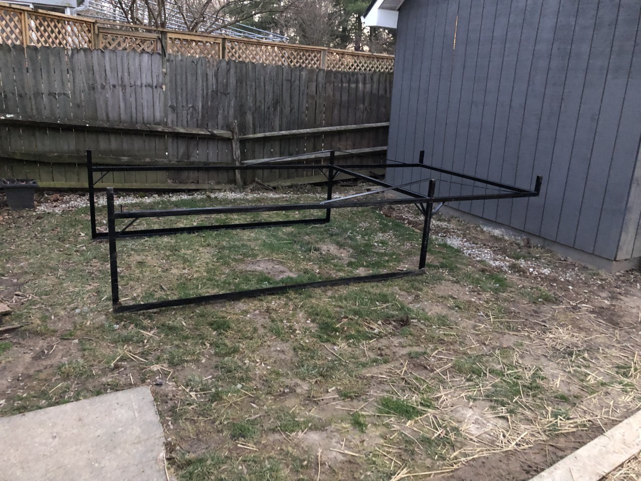

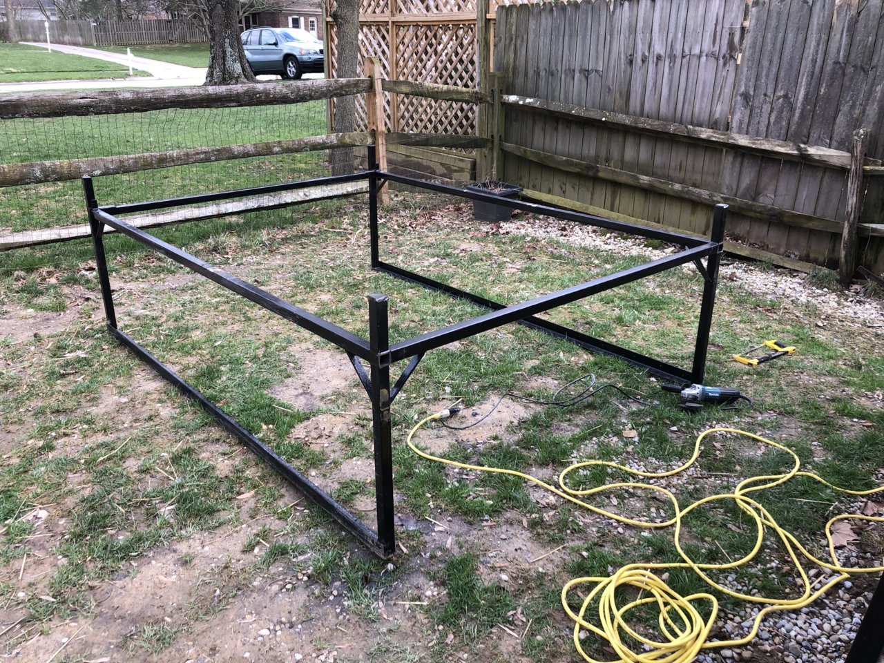

    It coming along a little slower than I originally anticipated. I found a ladder rack that I am going to use instead of going through a full fabrication. I picked up a welder and I’m going to do the work myself. I should have some more progress pics in the next week or so.

    By the way, this ladder rack fits the M101 perfectly length and width. It was a great find!

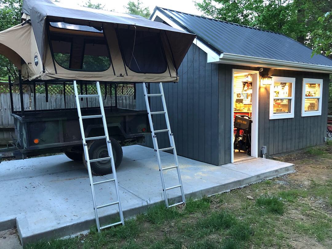

    Curious how this is going!? Im planning to buy a refurbished Military trailer, see pic. And build onto it.TRAILER WHITE 1.jpg

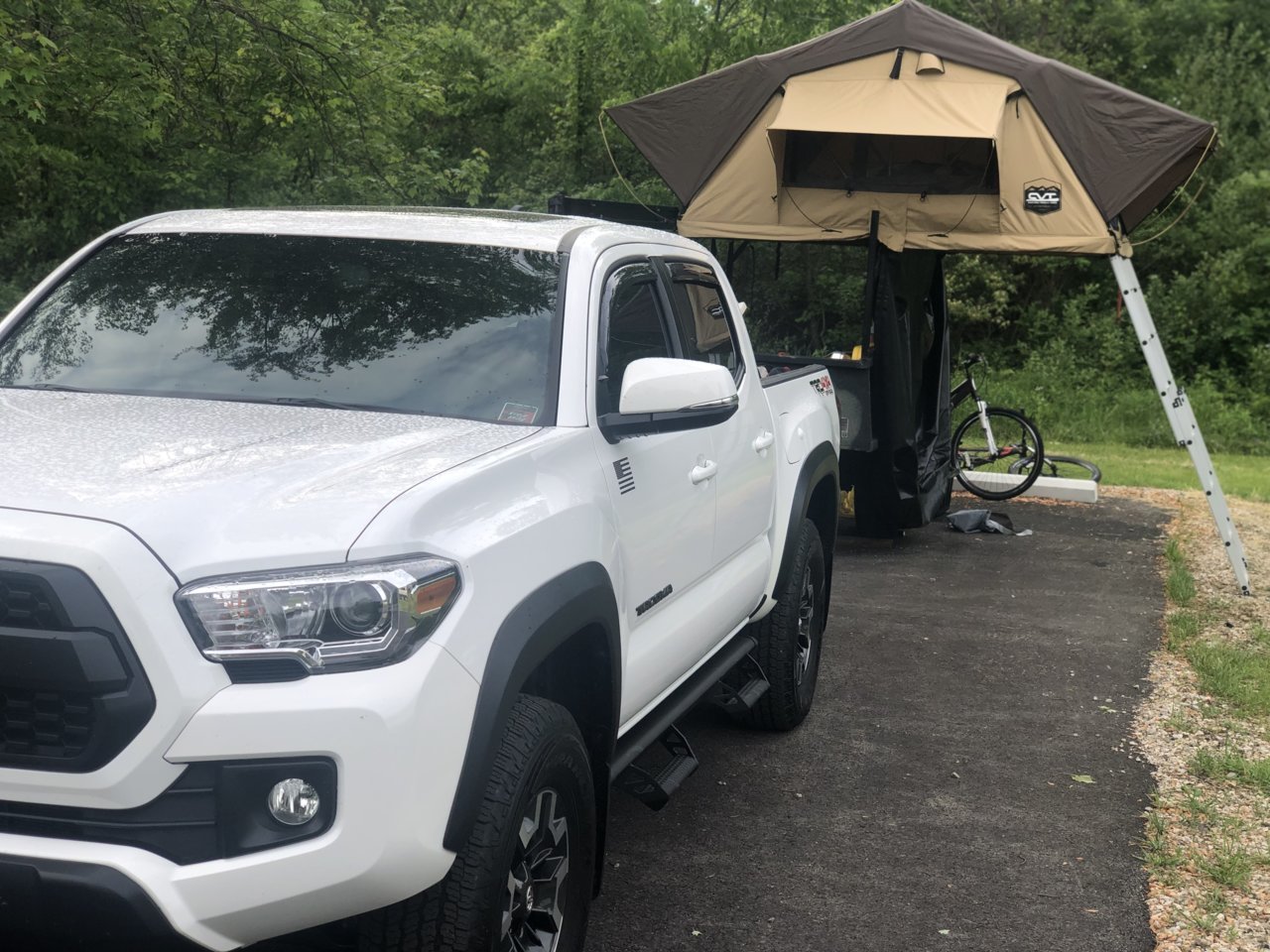

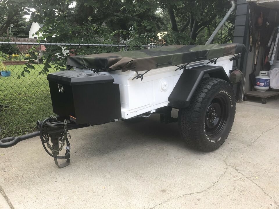

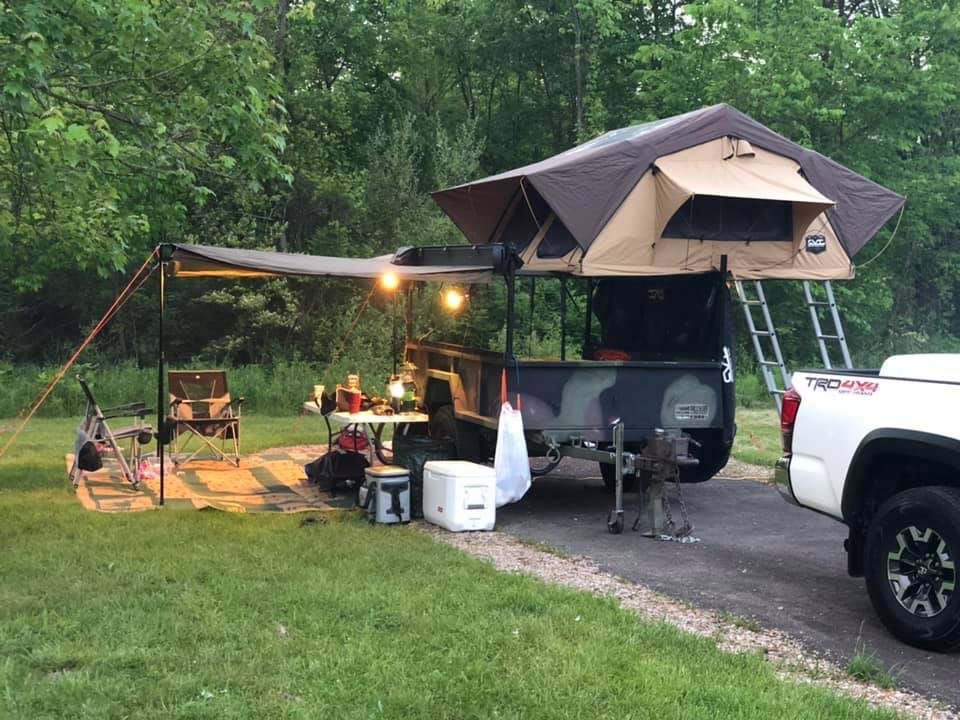

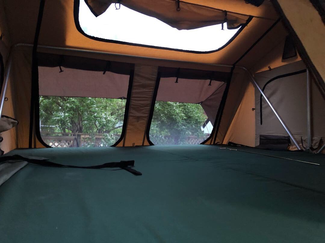

    That is a sweet looking trailer in the picture! I did get my trailer up and running and it's been awesome. I did take it in to have the bearings repacked and it turns out one of the breaks was locked and other was not engaged at all. Anyway, I decided to just disconnect everything. I towed it 300 miles and never had an issue so I probably will not worry about the breaks. I did weld new bars to my rack and paint it. It held up perfectly! I love that I can just hook it up and go. The trailer has been great. Here are some pictures. BF1EE594-2C01-4EEF-BCB6-140FFEACA4BF.jpg 883497DD-3BBF-481D-978E-91BF896AD2F0.jpg BA73E3B6-75A4-4466-BDB8-5D1BBD1ABD42.jpg BF1EE594-2C01-4EEF-BCB6-140FFEACA4BF.jpg CC04608F-B314-4806-BFBF-531E36A04823.jpg fullsizeoutput_4adf.jpg

    Just an update on the awning. It's a Batwing by Rhino Rack. I feel like its a must have for camping to get out of the sun and store your stuff if it rains.

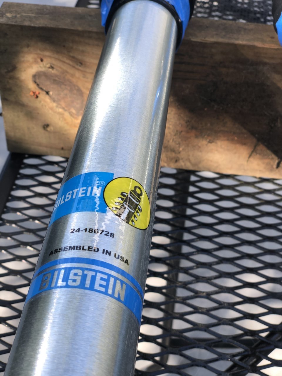

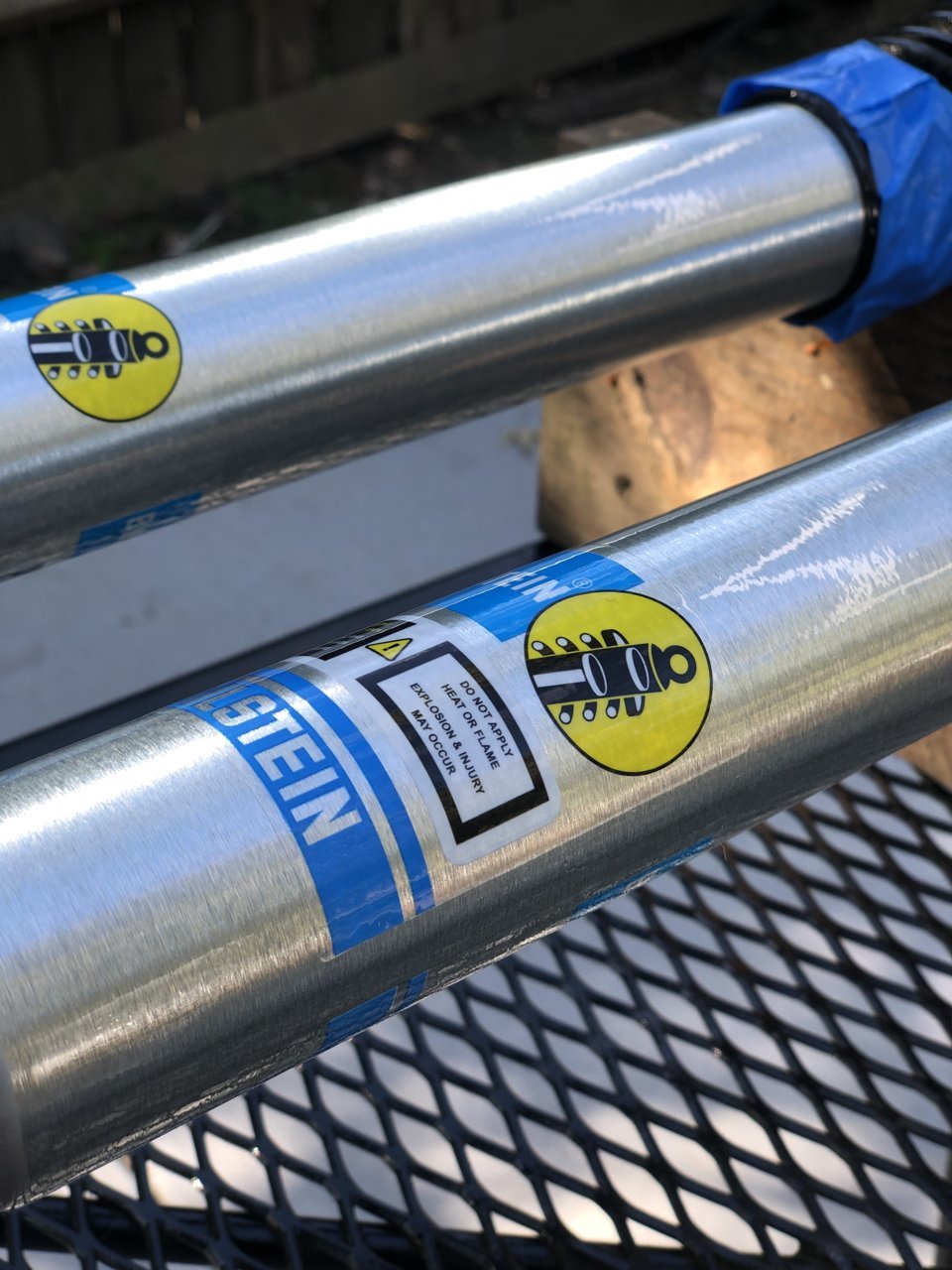

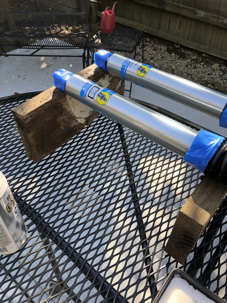

    Quick update on the truck! I ordered a lift kit for it! I decided to go with Bilstein 5100's all around. I ordered the 2887 OME coil springs for the front. In the back I purchased an Icon 1.5" AAL. Overall it should give me a nice 2" lift. Nothing too crazy but enough to get if off the ground a bit. After I save up a few bucks I will spring for the Cooper STT Pro tires. 265/75/R16. I think they are sweet looking tires for this truck and should do well in the mud. This past week I put a clear coat on the 5100's to keep them from tarnishing so fast. Hopefully they will look nice for a while.

    Ya, thx, super excited to start some mods on it. Great start for minor additions, no tent for us but man that's a crazy RTT! My large dog would pose a problem getting up there.. An awning and propane tank is 1st on the list. Looks great! Have fun!
