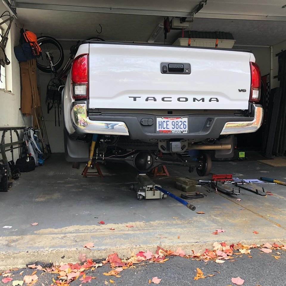

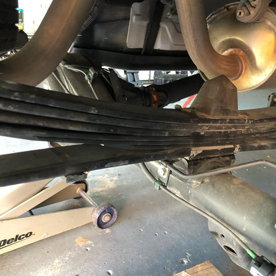

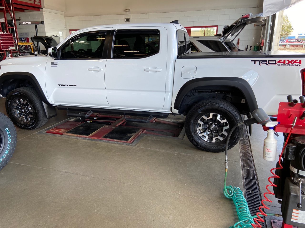

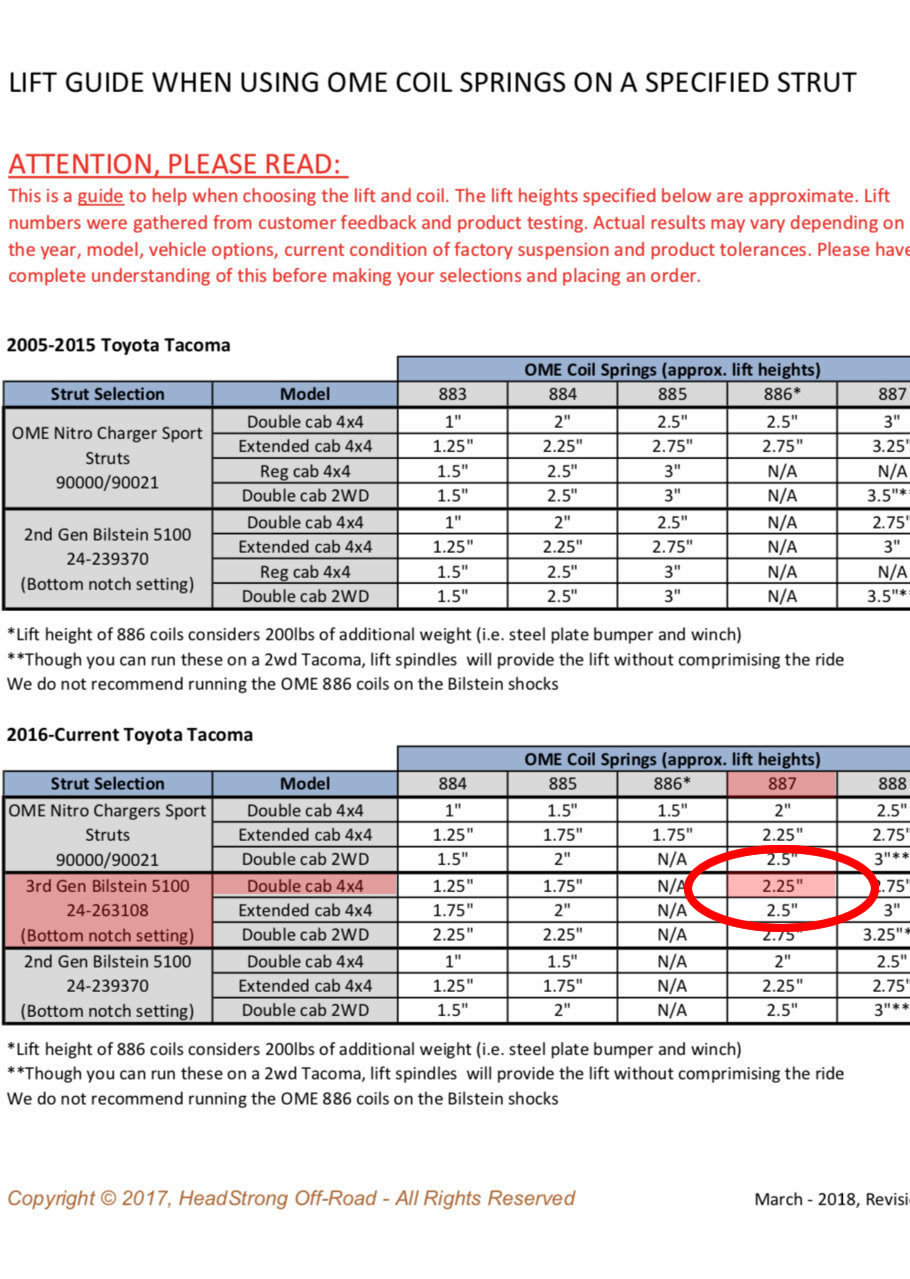

    Ok, I haven't posted for a while so I will update you on the 2" - 2.5" lift that I installed on my truck.
    I went with the following hardware:
    1.) Coils: OME 887
    2.) Shocks: Bilstein 5100 (3rd Gen)
    3.) Icon AAL with overload spring left in.
    4.) 1/4 spacer on the drivers side to account for gas tank lean. (taco lean)
    Overall, the job wasn't too bad but I did have to track down some necessary resources.
    Coil and Shock Pairing Guide by Headstrong. Super helpful!
    These were the videos that we super helpful:
    Tech Tip Tuesday - Bilstein 5100 Shock Assembly
    https://www.youtube.com/watch?v=xyQEMxDG5L4
    Removing your springs without a spring compressor
    Part 1: https://youtu.be/5E6u7dC7EHg
    Part 2: https://youtu.be/jo0FJSi-KYs
    (Note, I did take my new springs and shocks to a shop to have them assembled.)
    Installing the Icon AAL on my 3rd Gen
    https://youtu.be/9mdo-GnoVhY

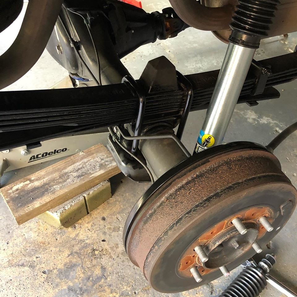

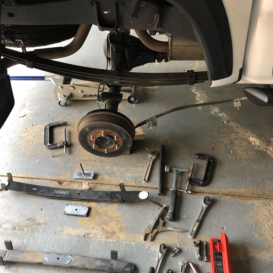

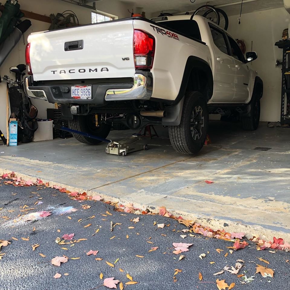

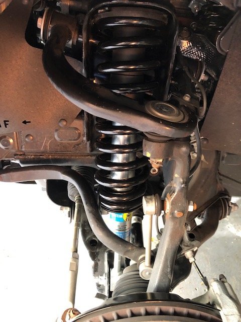

    Here is some pictures of the process:
    77233074_10157844213823669_4390591470080360448_o.jpg 74883022_10157844213998669_7524167281023123456_o.jpg 73308478_10157844213923669_3838716536508383232_o.jpg 75291718_10157844214163669_8198800441568395264_o.jpg 73482736_10157844214238669_4197875540184530944_o.jpg 75096917_10157844214398669_6202232800364462080_o.jpg 75262163_10157844214328669_583054922967154688_o.jpg

    I pick the 887 over the 888 because I still wanted a rake on the tuck. If you want to level it out while its parked, then the 888 is the way to go.

    The OME 887 will get you the rake. The OME 888 will level it out.

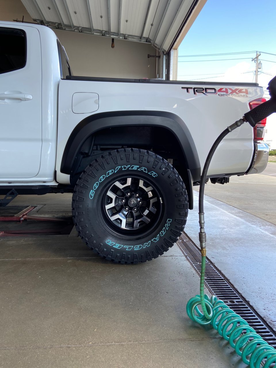

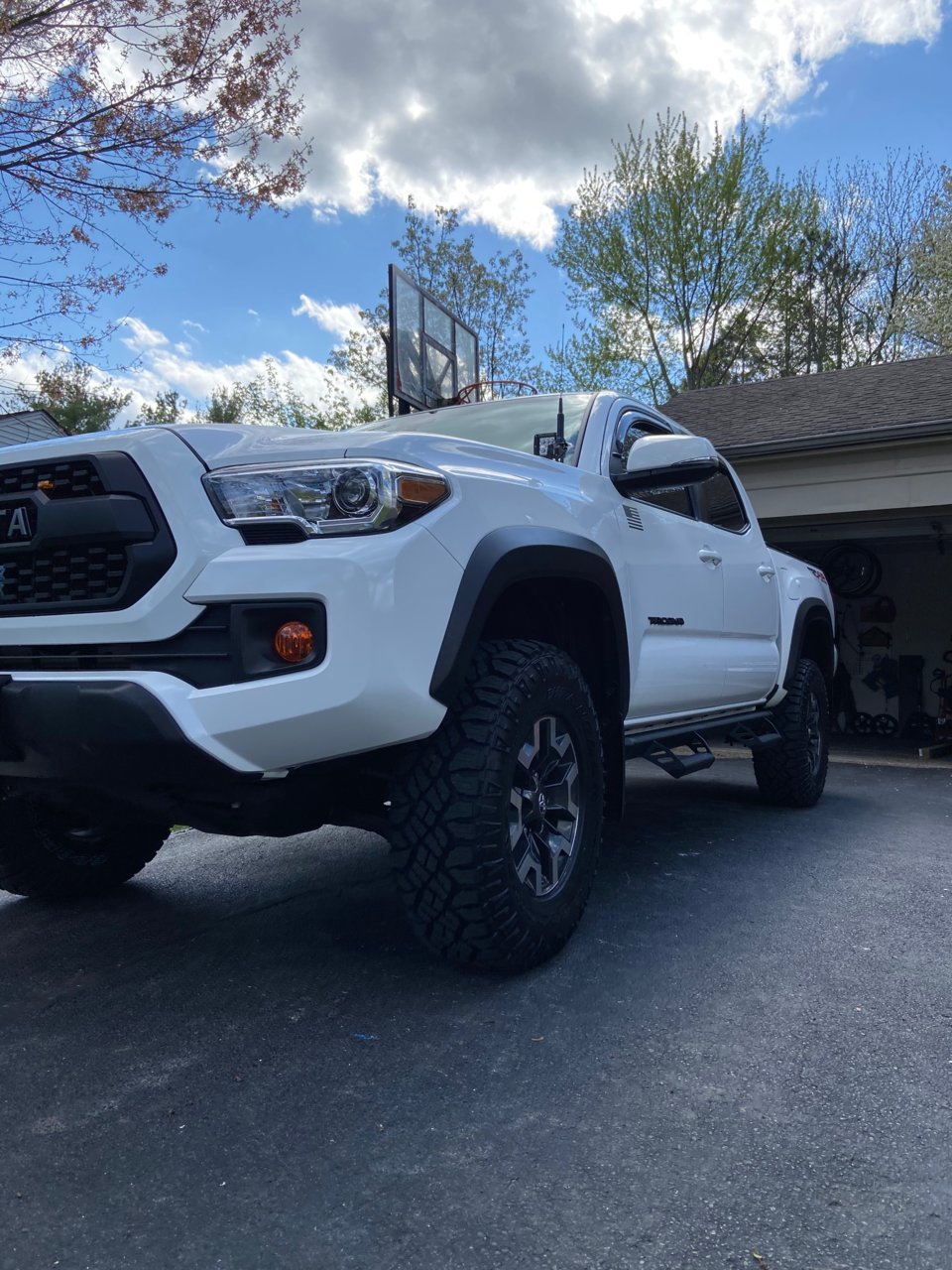

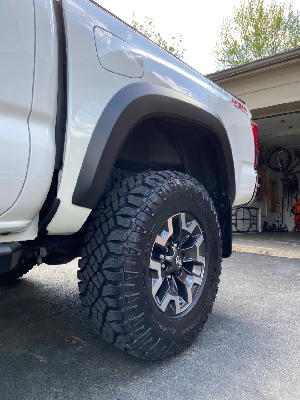

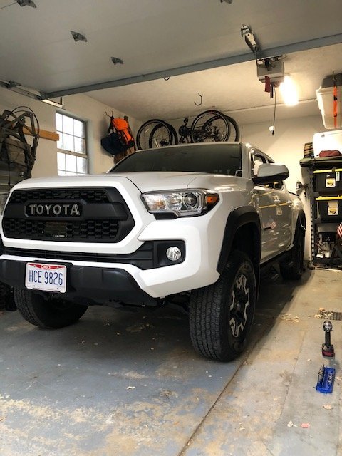

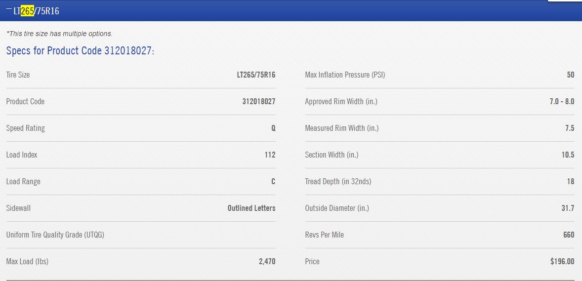

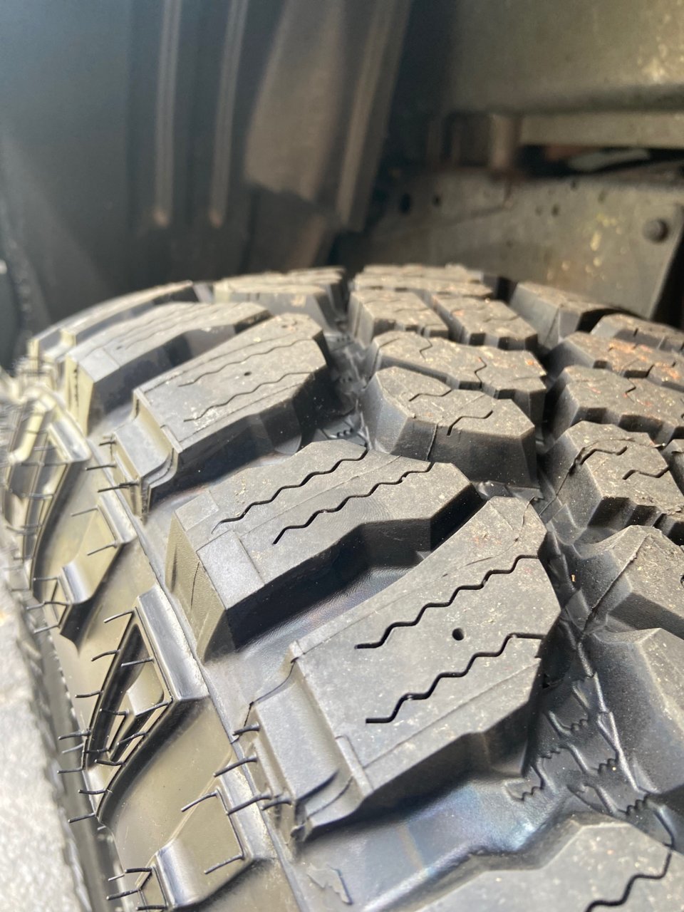

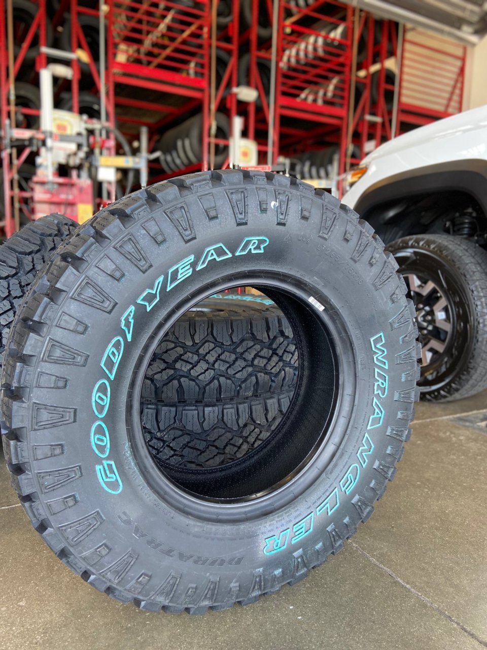

    Well I finally got tires put on the truck! I went with Goodyear Wrangler DuraTrac's. 265/75/16. I went this route because it was the most aggressive tread that I could get in a C load tire. 18/32 tread depth. The tire weight somewhere around 48lbs.
    image0.jpg IMG_8677.jpg image1.jpg image4.jpg image3.jpg image2.jpg image6.jpg

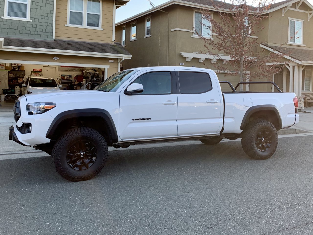

    Looks good bro. Here is mine 5100’s 1.5” front 1.5” wheelers AAL rear AE919A2C-6544-4962-936F-75D2A777534B.jpg kept factory rake 265/75/16 Yokohama X-AT

    I have 1.25” spidertrax hub centric they are great
