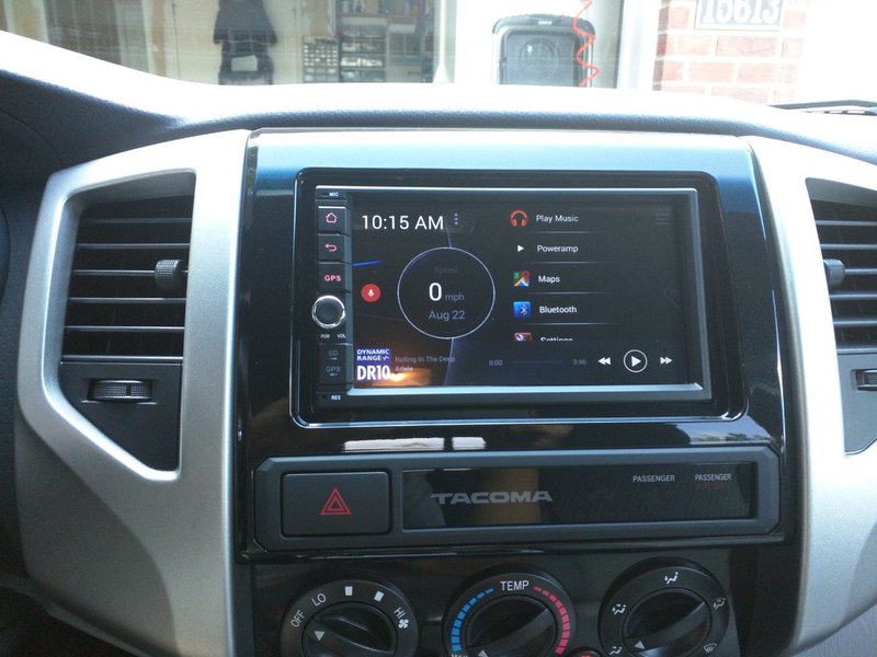

    I love the idea of android auto but having g to plug your phone in to the radio is a deal breaker for me. Considered using a nexus 7 as a head unit and went as far as mounting the tablet but scrapped that idea. It will be too much work to get the steering wheel controls working along with the backup camera. I did some research and the Chinese made android units have come a long way. The unit I got is 7 inches with no DVD, who uses DVD today anyways? It has a physical volume know, and can be programmed for steering wheel controls. All the functionality of android with the convince of a car head unit like preamps. My car already has upgraded speakers, sub's and amp. I have to say, the sound quality from.this unit is as good as any of my previous alpine units. The muddyness from the stock radio is gone, I can crank it up to ear beeding levels and its still crystal clear. For anyone considering thisntypw of unit, I say dive in. It was $300 from Amazon and has more features than the top of the line pioneer units. I loaded up a 64 gig sd card with my flac audio and im all set. When i get tired of my muaic, i jump to google plat music. Using tasker, my phone is set to turn on wifi hotspot when it connects to the car bluetooth so rhe unit will always have wifi.. I never need ro oull my ohone out. The only negative is the mic via Bluetooth is not as good, I'm working on fixing that.

    What is the make a model of the radio?

    ... And, if you could provide the actual Amazon link, it would be appreciated.
    Looks nice! It appears you used your OEM faceplate, instead of aftermarket?

    You will need a harness

    Flac through sd or USB,yes, use poweramp. Mp4 and mkv playback, yes, use mx player. The built in sound processor is pretty decent, no worst than my previous alpine head unit. I use Google play music for streaming and set it to download my music ahead of time. WiFi is pretty strong, I get signal up to 100 ft from my house. Here are some install tips:
    1. You will have to trim the metra bezel about 1/8 inch on each side for the joying to fit. The Chinese units are just a little bit wider. I used a dremel and cut off wheel.
    2. For steering wheel control, use the adapter of your choice, metra or pac. Set up for pioneer/Sony. These adapter will have a mini stereo connection to plug into the head unit, the joying does not have this connector. It has 2 wires from the harness, key 1 and key 2 so you will have to cut the mini stereo cable from the steering wheel adapter and connect to these 2 wires plus ground.
    3. Tuck as much wiring to the side so that they're not directly behind the unit, it will be a right fit.
    4. I routed the GPS antenna up through the passenger a pillar and zip tied it to the wiring connecting the map lights. GPS lock is immediate.
    5. Order a Toyota antenna adapter, just search Amazon.
    6. I stored 50gb of music on the sd card, worked fine but on occasion it was too slow and poweramp had to refresh the library which took a few minutes. I ended up only storing 16 gb on a memory stick. Video files on the sd will be fine.
    7. If you don't like the launcher, download something different but I find it works fine.
    8. Download this for the steering wheel controls to work with non native music player.
    https://play.google.com/store/apps/details?id=com.petrows.mtcservice
    9. If you can WiFi thether on your phone, Google maps navigation with satellite layer on is the shit!
    10. With the metra kit, I was not able to use the top 2 mounting holes, but the bottom 2 and the face plate are plenty strong.
    I'll update if I think of anything else, cell free to ask any questions, I'll do my best to answer.
