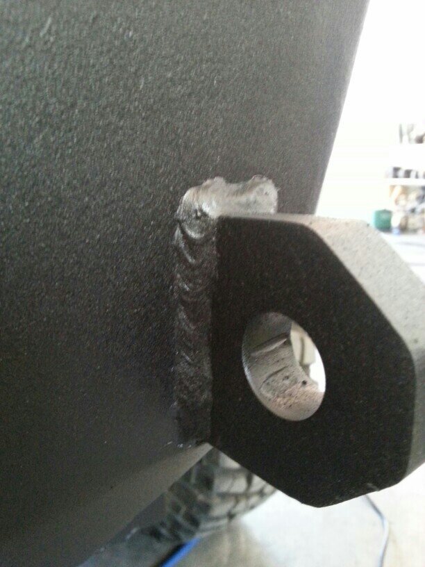

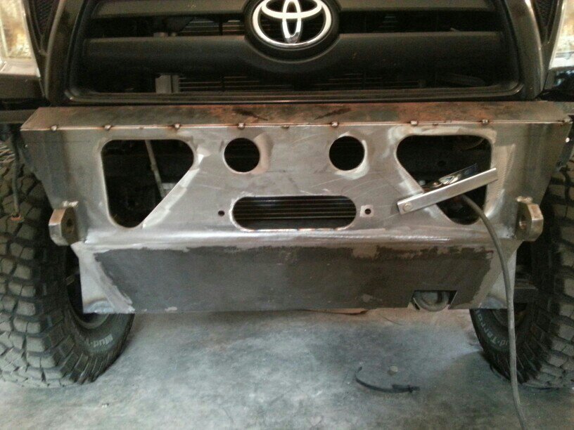

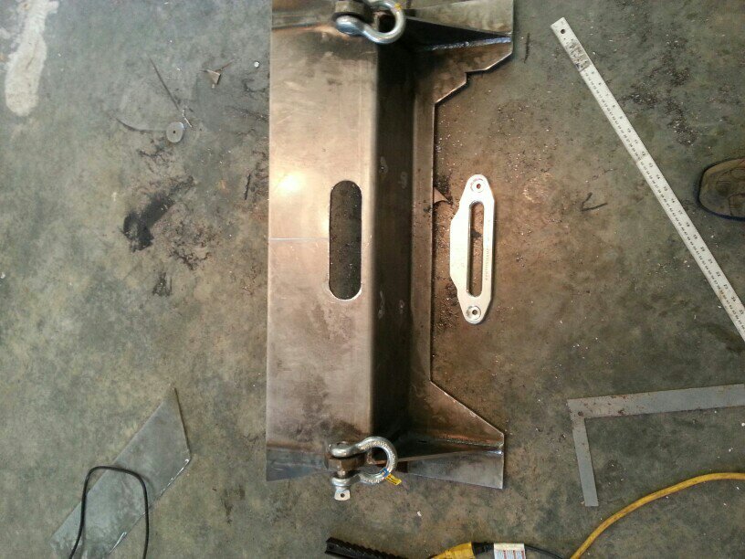

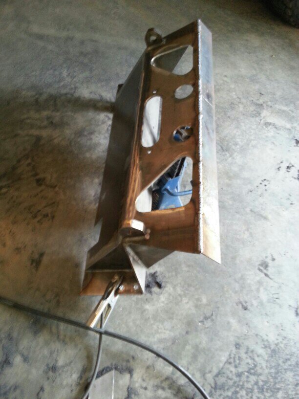

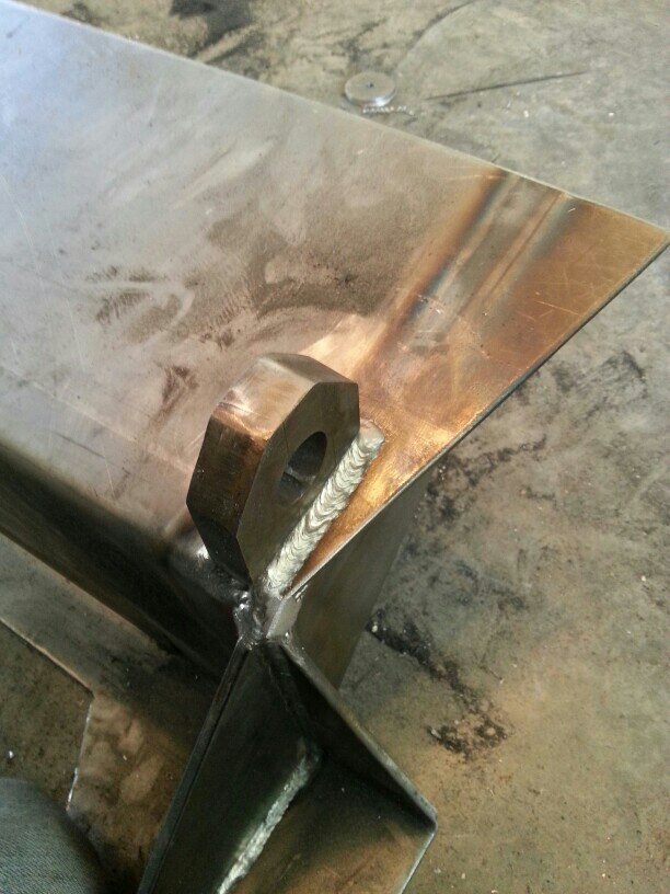

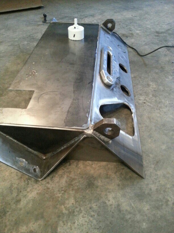

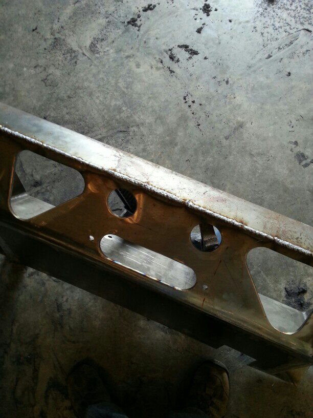

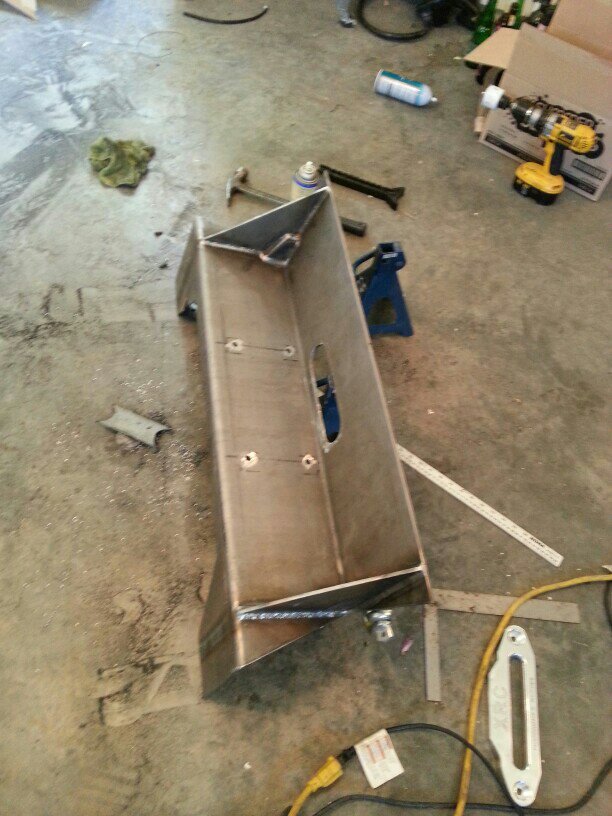

    I started building a winch bumper a little while ago. I didnt think about starting to take pictures until after the winch basket was built, but Ill try to document the rest if anyone is interested. The which shelf, front face and supporting gussets are all 1/4 and the "skin" is 10 guage (a country hair over 1/8)
    I definitely dont have a fully stocked shop. Everything is painfully cut with cutoffwheels and angle grinder. I dont have a drill press either, so all the holes are cut with a hand drill and alot of patience. 1/4 is difficult to work with without the proper equipment lol but very doable in your home garage.
    Started with a the rough idea mocked up in cardboard

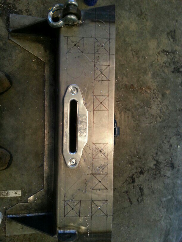

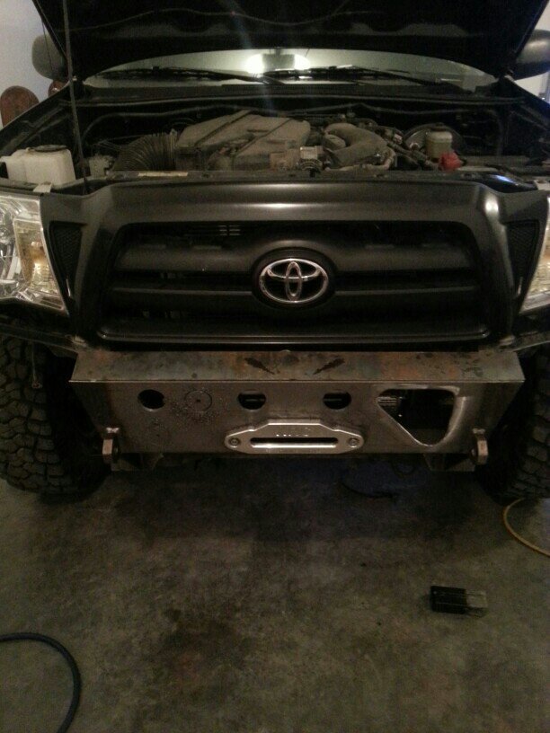

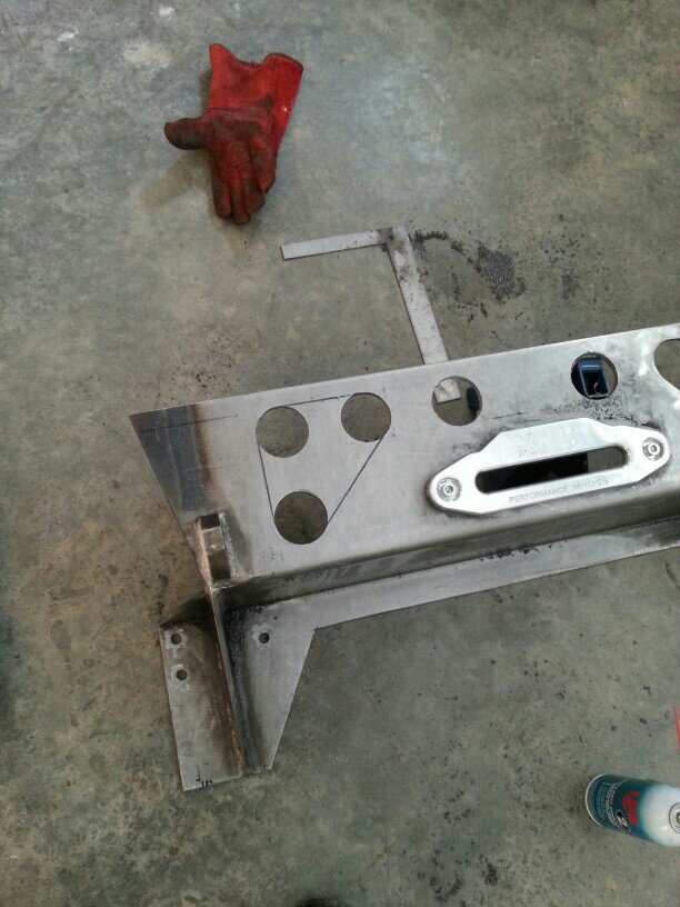

    I had a machine shop bend the winch holder into shape since I most definitely dont have a 1/4 brake. I didnt take any more pics until I started cutting the fairlead holes. 2 1/4 holesaw vs 1/4 steel = much patience needed lol
    hy4avy2u_3da0b485da5380b85b4dac75abbae87671bb7cb6.jpga2ese3at_5ad4e4817026517365717dd163fbc7fa582f80f7.jpgpegyhyqy_b62ebc159182107fc863d6bee06702f7fd4ce55c.jpg
    Measuring and cutting other holes in front face
    vu7umebe_49b2e593dd041c971aef11f966e87485449e1674.jpgjumunaje_5b128fa4d4a10b312f3af493449cad3f7e8f5918.jpg
    ANGRY MONKEY!!!
    avumugyv_efcd62c6bcb4d58c3ca1b913fbd976d8ee99e2b9.jpge9a2yqat_6e22cc1a3050fba47d6d2f6c9ab2a0c130446184.jpg

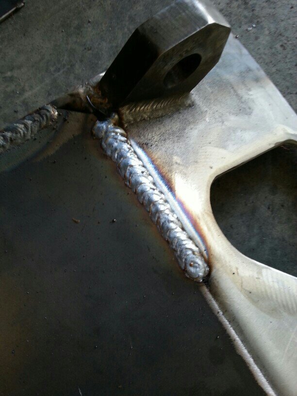

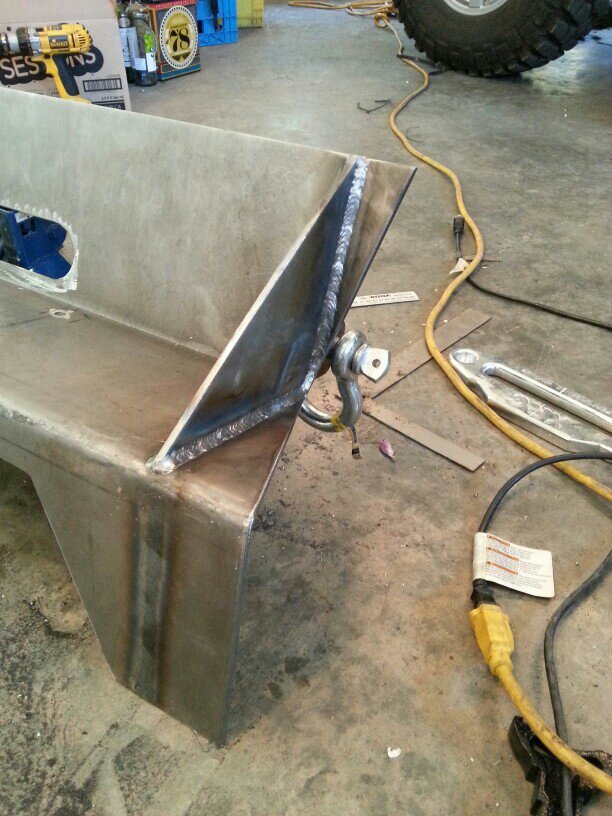

    Starting on the skid
    Welding the skid
    e7y7evaj_155fd7236627de7b022f2f7a3b93c2b6a3c5f501.jpg2yrareve_6c710808ff840baa347349fd99562ae28029588b.jpghapymaty_2b4c7ae11ed0ad015f8afdedcb64b529e677fe0b.jpg
    Welding the top
    This is as far as I have gotten now.... ill work on it some more tomorrow and update. Would love to hear your thoughts

    Great looking welds. How much do you think you will have into it when you are done? (taking into account your own labor)

    Looking good. Is the whole thing gonna be 1/4" plate? Are you gonna back gouge or just butt weld everything?

    Ill probably have 300ish in materials including cutoff wheels, flap discs, holesaws, welding wire and metal. Labour is another story. Ill tell you one thing, when your getting a $1000 bumper, its really not as expensive as you would think. A production shop will have big shears and plasma cutters to help speed things up, but I am finding quickly that everything takes longer than you would think. I am fairly new to metal work though, im sure I will get faster.
    With my time included, im sure it would have been cheaper to buy a production bumper, but I dont really count my time bcause it is a fun project for me, and I get a one off piece in the end.

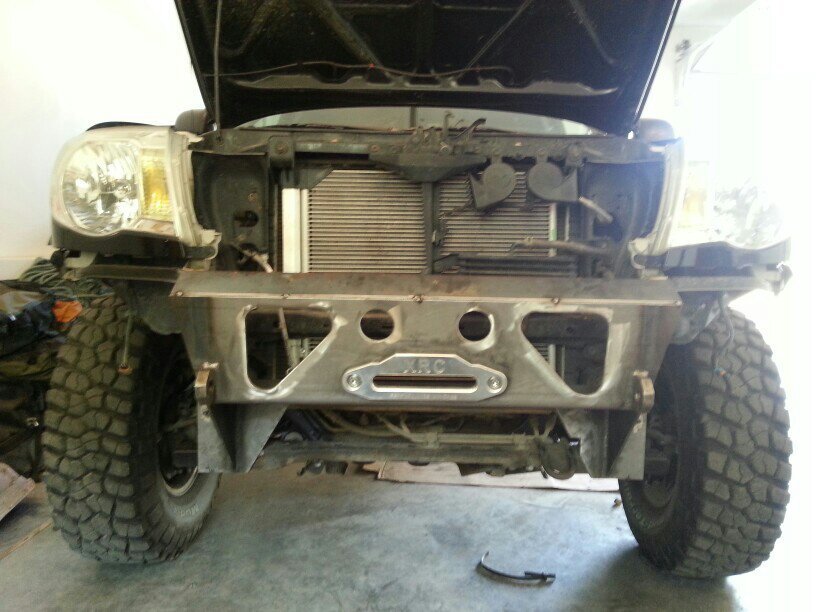

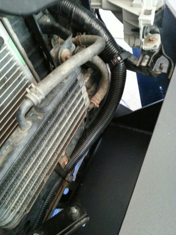

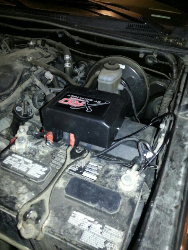

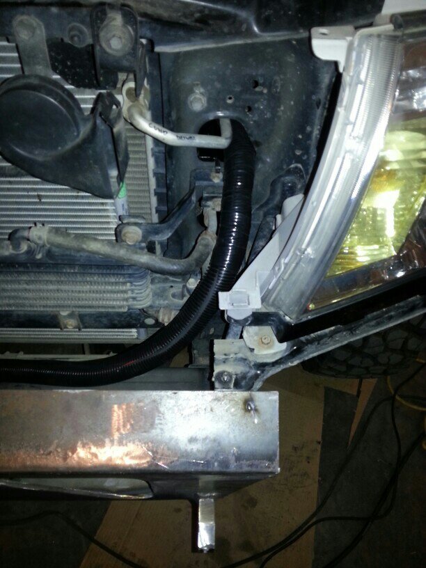

    Trip got delayed for a couple days. I wired my winch and relocated the solonoid under the hood. I have it mounted ontop of the fuse panel for now, until I have time to fabricate a braket. I can still open the fuse block if necessary.
    5yqemy2u_3e14f4fe44673e3d7a3de8ea8db769303d0b54a7.jpg3a3e9ysa_9a33c9585ab03d87e86a08aa616906e07c25a1e3.jpg

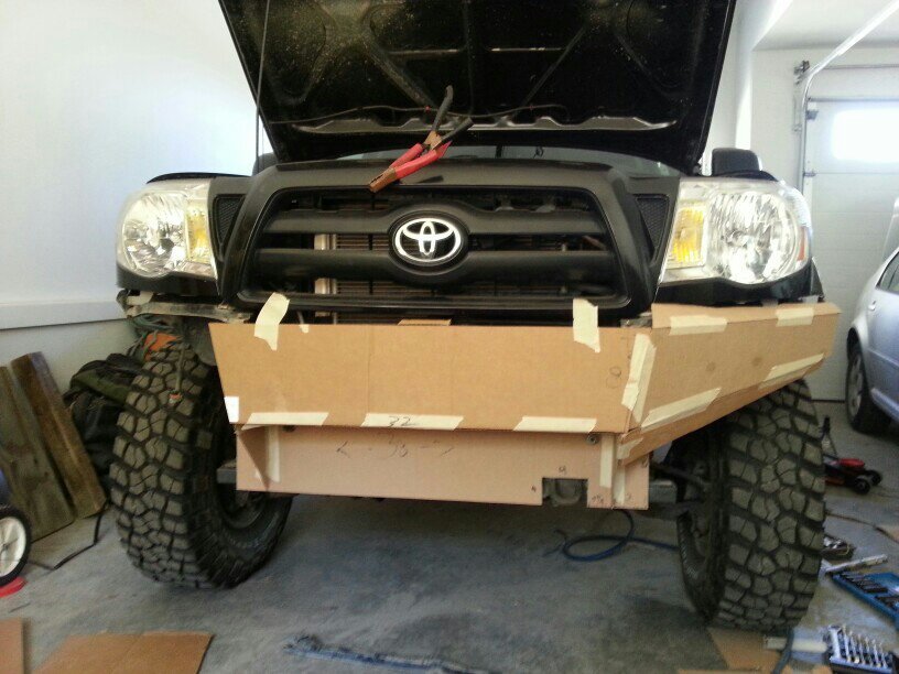

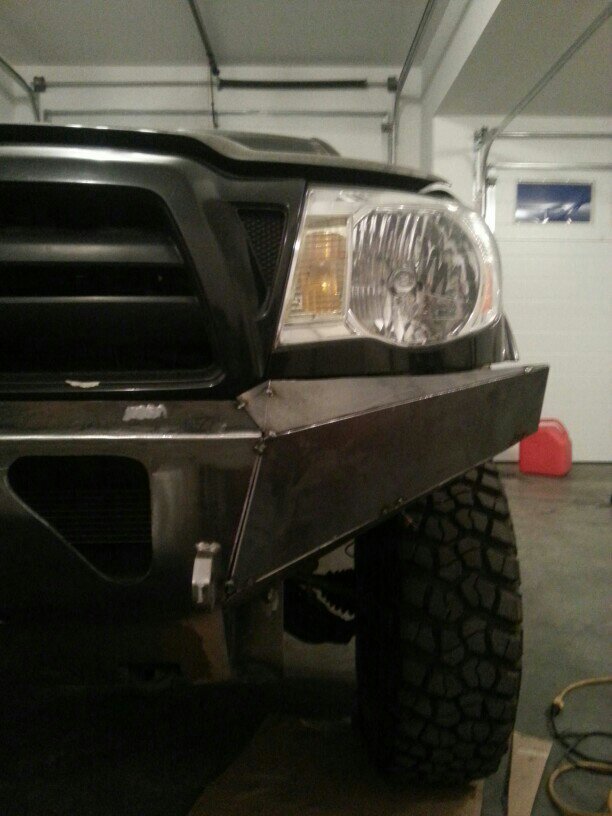

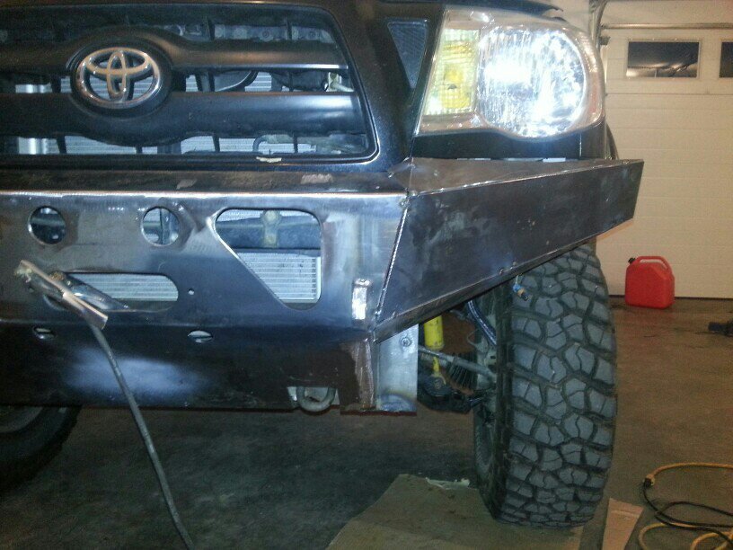

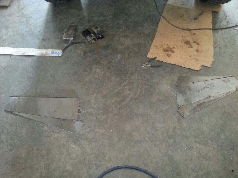

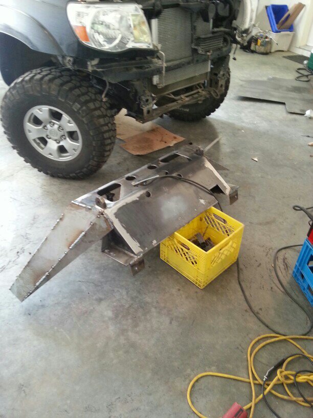

    Then I got out some cardboard and started mocking up the wings for the bumper
    3ejeny2e_48b8a7cded77056a6a0a11a7afd84677790b27a9.jpgqevabu9u_37439f5fbfd34ec2cc1587739bec43d12b9d41ba.jpg
    I took it apart and will cut out the other side and weld it tomorrow.

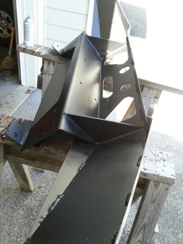

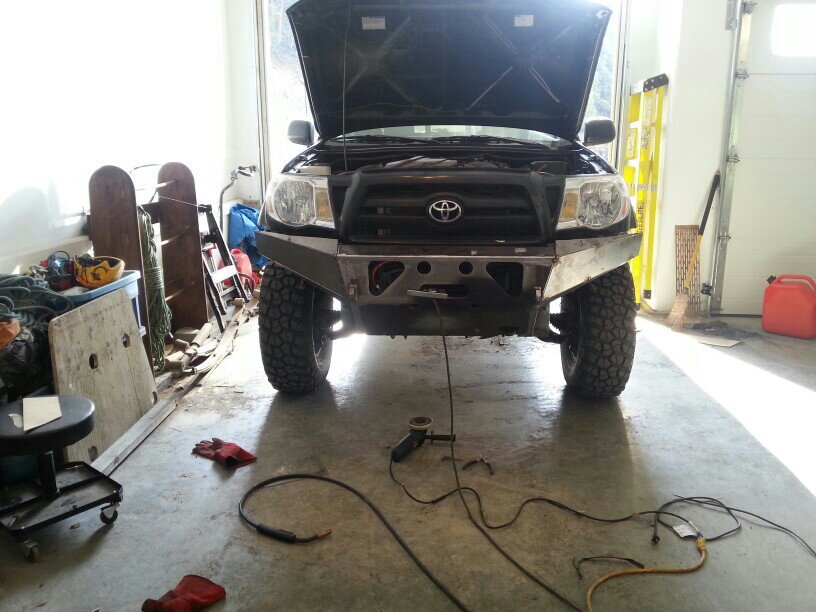

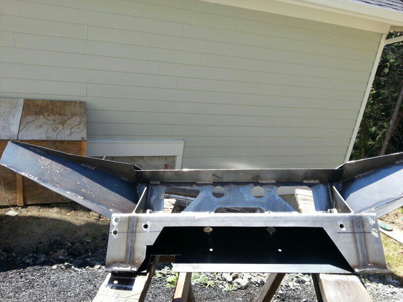

    All cut ready to go
    Tacked
    Found this on my roof. Why do cats love cardboard so much?
    Welding
    After a loooooot of grinding, getting a degreaser bath in the sun
    Some primer
    Some bed liner

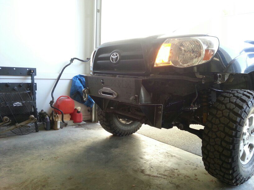

    Winch installation
    usyqa6er_cecf59c6fcf3eb2857b09711f34c79d0b7e4e5f8.jpg7y3ubane_86a3ac1501ba3461d8615a070a78c186c2538cbf.jpg

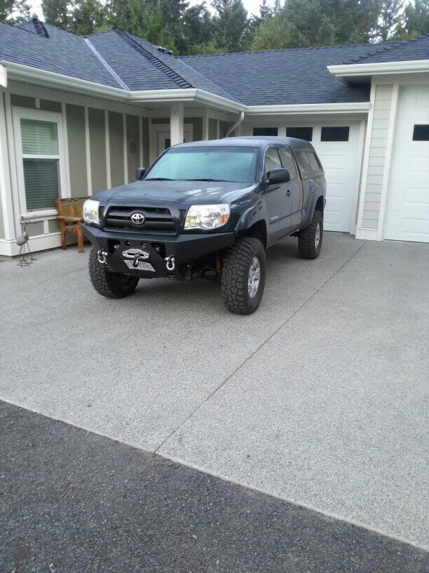

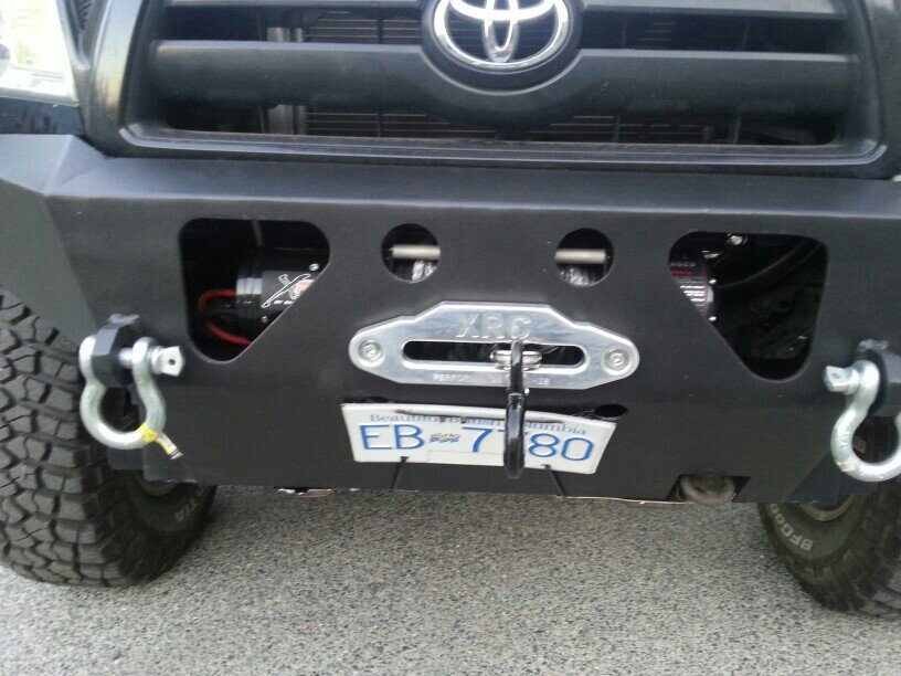

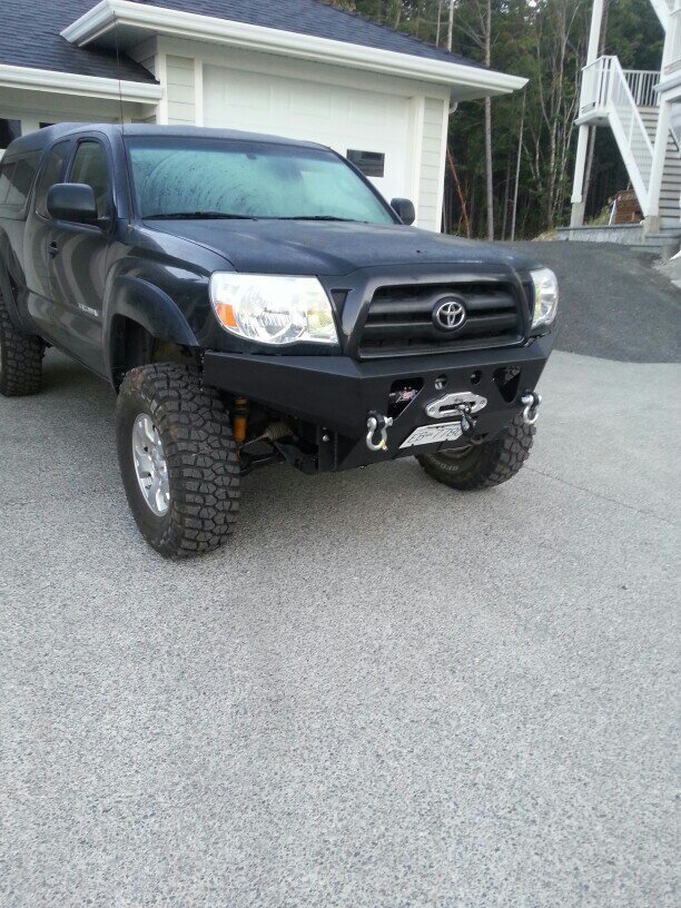

    All done, minus the sides. Ill get to that when we get back from our trip. We are going 4x4 camping in the Caribou/Chilcotin in Bc.
    Monkey Face, no longer evil! Lol. I think I'll call him George.
    qesy3a8y_297971ea4437a5a43e1cc067832b10c5b6a143a4.jpg4u2equ2u_599f051b63e7e4cb1a7eed7ba2cdbbaa78cfd6f3.jpg
    Yup after all that work my license plate is zap strapped on lol o literally ran out of time though, I worked until the minute. Ill mount it nicely in a couple weeks.

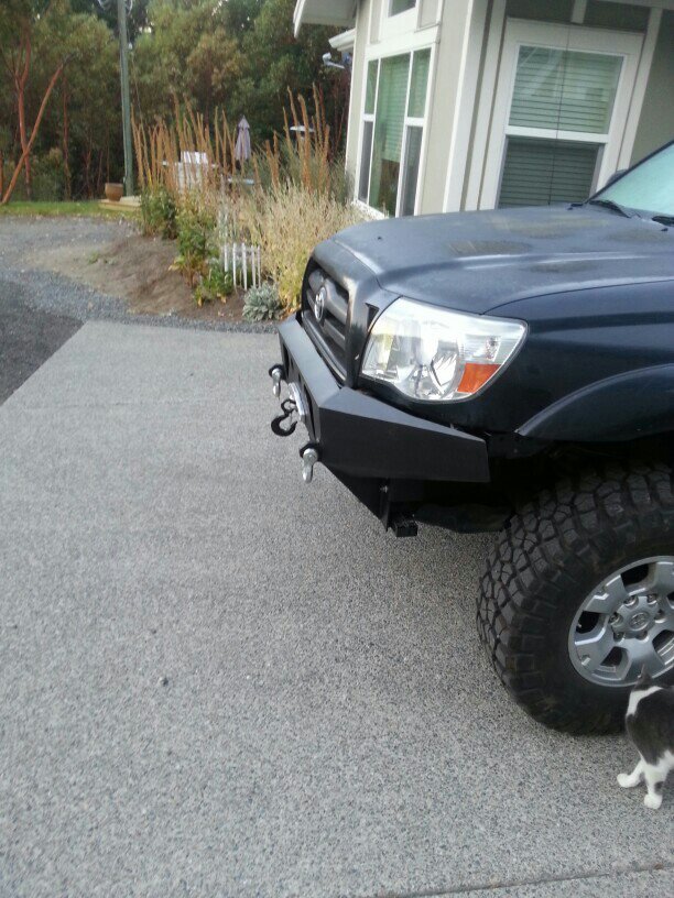

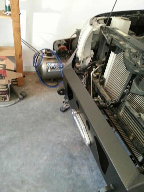

    For someone "new to metal working" that's pretty damned impressive. Great work! I can't quite tell from the pictures; is there enough of a gap to allow for frame/body flex so the bumper doesn't contact the grill, fenders, or headlight bezel?
  11. Aug 5, 2013 at 7:50 AM
    tweeek
    tweeek [OP] Well-Known Member
    Mar 11, 2012
    #74706
    185
    Victoria, BC
    2006 Tacoma Access Cab TRD OR
    Ill definitely take that as a compliment. I only started welding 3 months ago, but practiced alot before start this project. This is, however, my firat really involved metal project I have tackled.

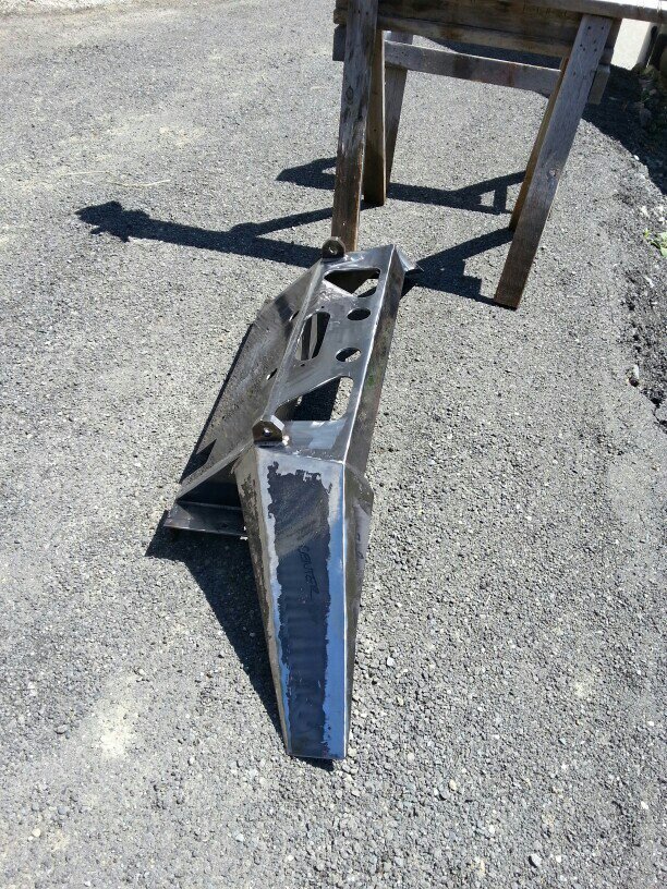

    Its tough to tell from the pics, but the bumper sits infront of the headlights and grill. Frame torsion shouldnt be a problem until I put the fender sides on. Im thinking about 3/4 inch.sa2aqy2a_e2a95656421714a92506fa76f216ab792d62aee6.jpg

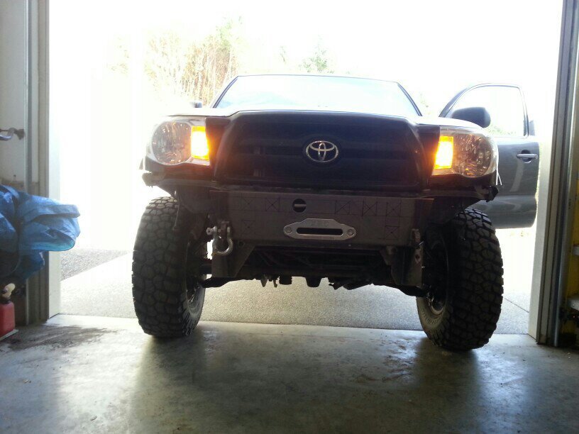

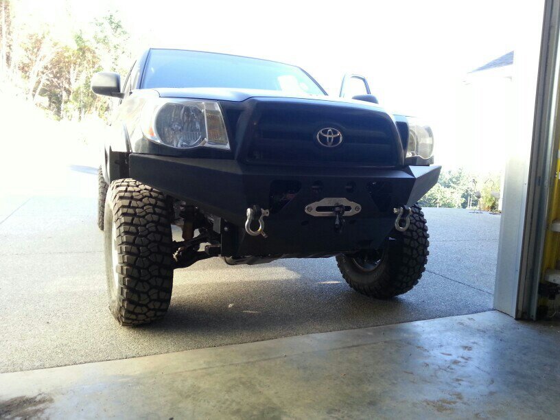

    Got a little dirt on it
    y6a7eda5_f533814e42afdb915e82633404b6fcf31288485d.jpg4a6yzemy_754d60591252691a8444e22e835504864258a1e5.jpg

    That looks pretty nice man! Were you planning on making some brackets to tie the bumper into the frame further back or is it just mounted with the six studs for the OEM bumper?
  14. Aug 14, 2013 at 9:40 AM
    tweeek
    Mar 11, 2012
    #74706
    185
    Victoria, BC
    It is mounted to the 6 studs, plus 2 on the bottom of the cross member, plus tied back to the frame with a bracket I purchased from Relentless. It mounts by 10 attachment points.
