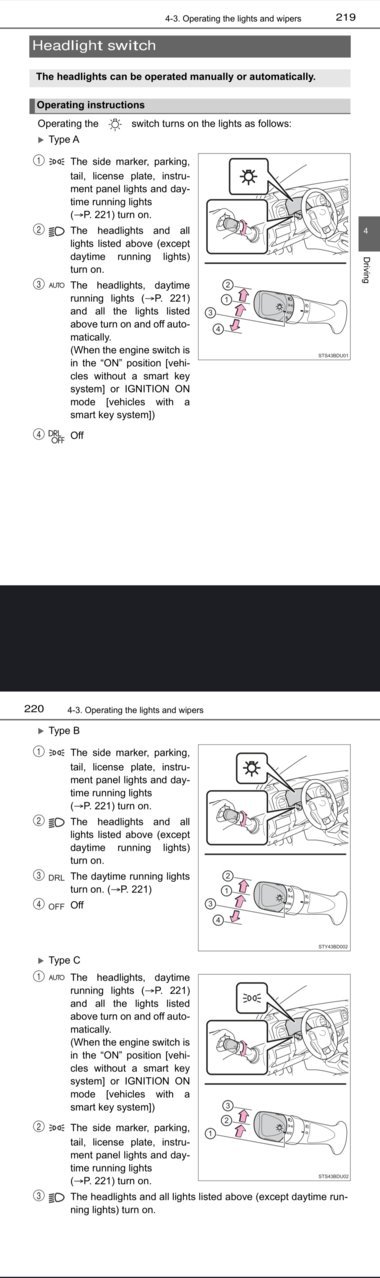

    We have the Type C switch (Headlights, Parking lights, and Auto). DRLs cannot be turned off. I'd be happy with a Type A or B.
    I think the reason they eliminated the "off" option in Canada is because too many people are driving around in the dark without taillights, so new legislation requires that manufacturers make that impossible.
    This suggests to me that even if I change the stalk, the dashboard lights would still operate off the ambient light sensor, but I could be wrong.
