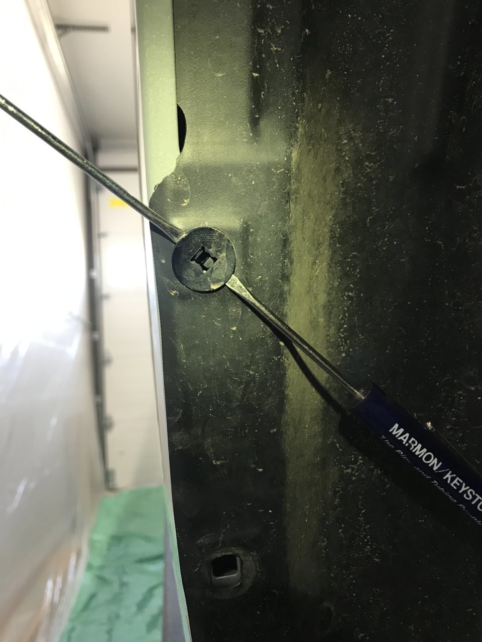

    I knocked a fender liner loose the other day. i need to clip it back in but ive never seen these kind of fasteners before and I dont know how to remove them. 1486576707468-1213209800.jpg

    anyone messed with these before?:frusty: :help:

    That looks like a push-pin type of clip, with the inner part missing.
    Similar to this (screw-in) one:
    Hit up the dealer for a few replacements.
    What's left in your photo should simply pull right out, as nothing is holding it in place right now.

    And get yourself one of these trim tools, which will make removing such things a million times easier (than using a flathead of the like):

    They just pull out, but they're a PITA to get out without distorting. Nothing is missing, that's how they are. I would suggest just grabbing the sumbitch with vise grips and pulling it out and getting a replacement from your local hardware store like the one that @0210 posted above. They would hold as little better (tighter) and get rid of that annoying rattle when you close your doors. While you're at it, do all 4 wheel wells. The rears are notorious for being loose and letting the plastic liners rattle.

    Again, there is nothing missing from that clip. The wheel well splash guards clip on using those. They do just push in and pull out (with enough force).
    If you can get to the backside (engine bay in the front- no such luck in the rear) some needle nose pliers will help push it out.

    They are a bitch to remove, have destroyed most of them and replaced them with nut and bolt.
    Those fasteners are meant to support a screw (like a nut) to hold something.

    Before i installed the snorkel, I bought new clips at the dealership. I just pulled those out with pliers

    They're aren't bad to remove once you get the knack. Take 2 pocket screwdrivers, slide them down you side of each tab that's in the center, push inward. This takes the pressure off the internal tabs. Hold that with one hand, while using small curved needle nose with the other hand, and pop them out . I removed front and back liners to oil spray. Didn't damage any, all reusable. Or, if you lack patience, side cutters with new clips

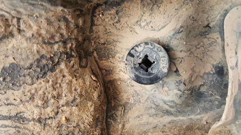

    I know this is an old thread but it is what comes up on google if someone searches "tacomaworld remove inner fender liner clips."
    This is all I need to see to successfully remove all the clips with the little empty square hole without breaking. Photo credit to Mr. 'Splitfuse' on the tundra forum- appreciate it.
    Now I just need to figure out what to replace these with to eliminate an annoying rattle. I should have just ripped them all out because this is the most ridiculously designed clip I have ever dealt with.
