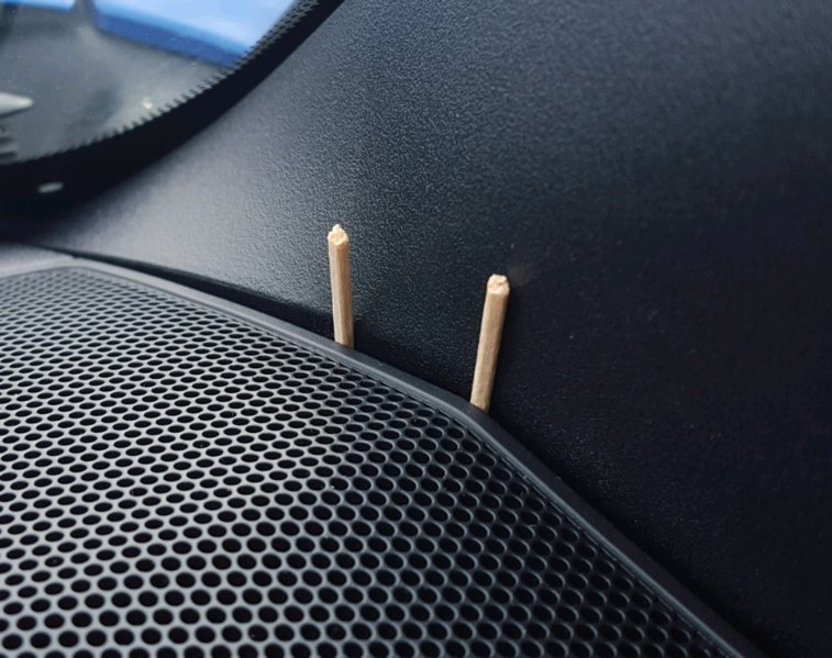

    Pulled this pic off google.. just throw some felt of padding there and it'll be gone.2016 Tacoma Front Right Speaker Toothpicks cropped.jpg

    Hah, that pic is actually from someone on TW. Had a few rattles in my 16 already. One where the crawl control console resides. They fixed that. The other is next to the A pillar, which I took it in and they claimed it was adhesive to hold some wires together not sticking. This only happens in cold weather btw. I'm still getting that ticking sound in the same area so I will have them look at it again at my 15k service. Didn't spend almost 40k to have some ticking noise annoy the hell out of me. I feel your pain, brosef!

    Better believe I am going to jam a toothpick in their as soon as I can get out of this office!
    Next question is should I plastidip the toothpick??

    I have it on my truck and the SR5 loaner I had from the dealer last week had the same noise.
    I bought a roll of felt tape on Amazon and put it between the A pillar and speaker cover. All gone.
