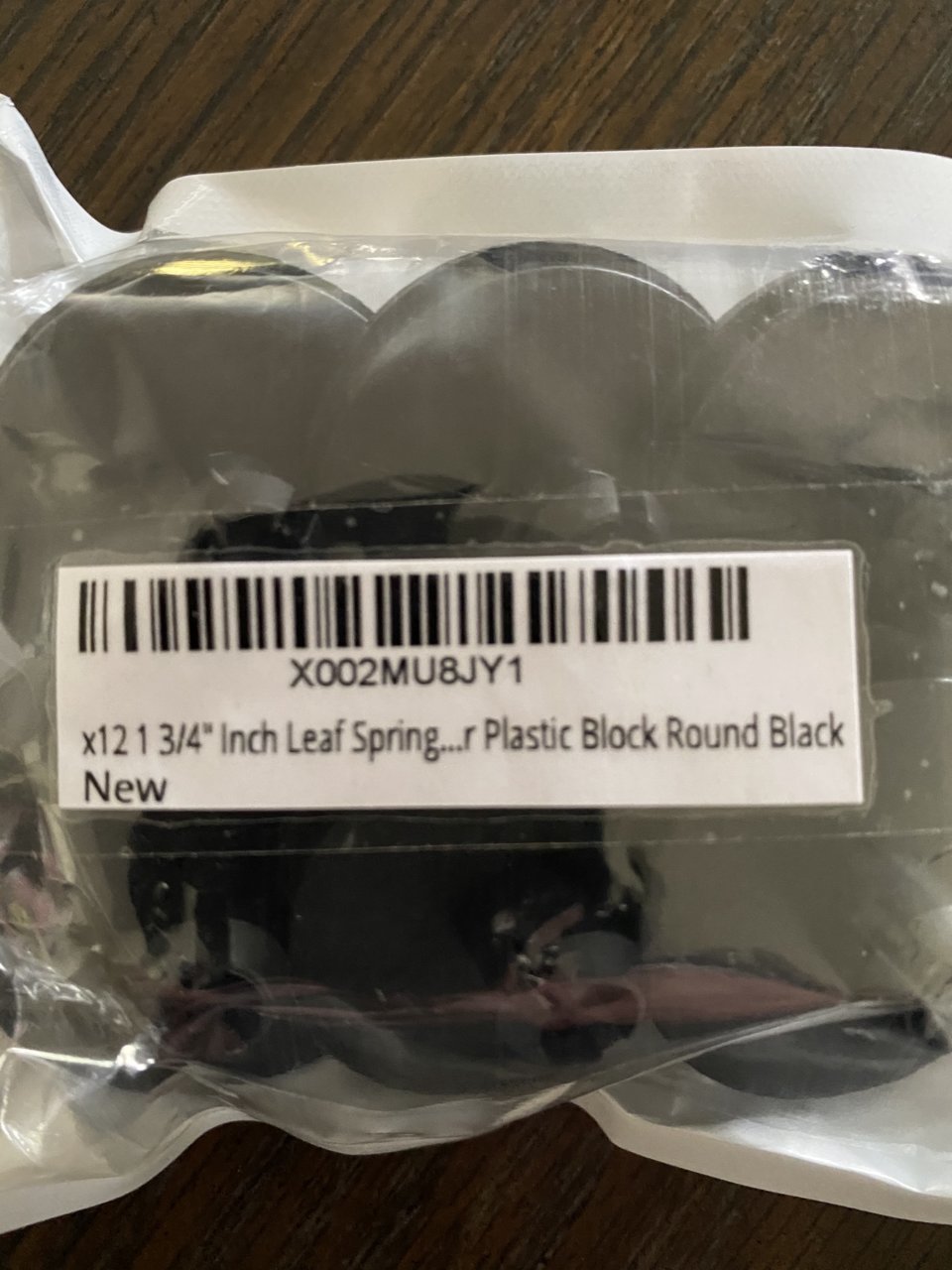

    Arrived yesterday install next week. Will update. This could be the answer for a lot of us!
