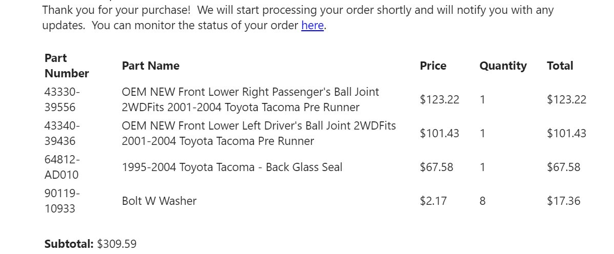

    For the record, I ordered a set of OEM + bolts last night. Here are the part numbers for future reference. It seems that the part numbers have changed slightly from what others have suggested earlier. Part #43330-39555 is now 43330-39556, and 43340-39435 is now 43340-39436. (Both increased by 1). Most online dealers show this being a 2WD part but it will work for 4WD also, I called Toyota and confirmed this is the right part #.
    Thanks everyone for the input!

  11. Sep 21, 2023 at 9:15 AM
    Kwikvette
    Feb 27, 2019
    #284735
    81,341
    Fresno County
    4 run, 2 don't
    Wyoming[OP] likes this.

  13. Sep 21, 2023 at 9:27 AM
    Kwikvette
    Feb 27, 2019
    #284735
    81,341
    Fresno County
    4 run, 2 don't
    Gotcha, I found it cheaper with the part numbers I provided but it also depends where you buy them from
    Yeah I had it in my signature for the longest time; one person in particular was always a bit passive aggressive as he insisted on getting members to buy the latest variant with boots on them so now he can go on his journey to spread the word in every ball joint thread
    Yes, the little boots provide some coverage from dirt and debris, but there are many more driving on the OEM set without the boot with no issues to date
    As long as they're not neglected like many things on an old vehicle, you'll be fine
    Filled with snow, mud, sand, it didn't matter -

    OEM and check them every oil change. I just paid around 180 for another set and 8 of the black bolts for future replacement. I've driven on long sustained stretches of rough washboard road which is quite punishing and they are solid as a rock.

    Seems like I need to get better at looking for deals!! :facepalm:My excuse is that I was sick of shopping and just pulled the trigger on what seemed to be a good price (Boch Toyota South). Prices aside, I'm definitely excited to end this mental debate for a while...
    I'm glad to hear that you guys have put them through the wringer, It sounds like they will hold up fine for what I plan on doing. It looks like the ones I ordered show a boot in the diagram, so we'll see what shows up.

    I bought mine from the same place but used part number 04005-03235 instead. It comes as a kit for both sides. Bosch did reach out asking which side I needed but I told them that it is a set and to place the order as-is. You can reuse the castle nut but get a set of new cotter pins at lowes for like 2 dollars. The price difference spread out over all the mileage is negligible frankly.
