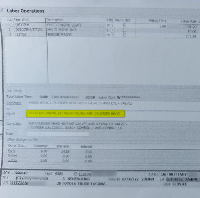

    Poor machining.

    They used the words "burnt valve" to me. As in: the valve was not seating properly and the hot gasses blowing by when it was supposed to be closed burnt the valve material, slowly worsening the problem until the compression was bad enough to trigger the code and engine stumble. So either a defect in the head or the valve I guess. If it's a recurrent issue in one bank seems more likely to be a head manufacturing defect? I'm not a mechanic. This is how it was explained. I have no way to know if this is correct or bullshit.

    2019 with 59k miles, just got the p11ec and confirmation of burnt exhaust valve in cylinder 1. 3 other 2017-2020 tacos at the dealer for the same issue. Definitely becoming more common with increased mileage. Had the fuel pump recall done about 10k ago. Vin starts with #3, not sure on mfg location, guessing Mexico. No word from toyota on an actual cause or if replacing the cylinder head will be a perminant fix.
