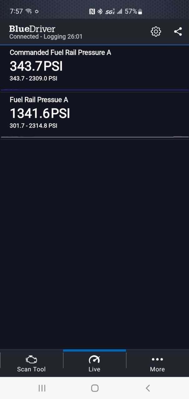

    New to me. 2018 - Tacoma - #3 VIN - 95,000 miles (may have had a repair previously based upon receipts I saw at purchase)
    Mine is intermittently coding P11F0. No other codes. Garage reader says rough idle, but I don't get a code for that. Based on reading from this site I had compression done on cylinders 3 & 5 and results were not stellar, but cylinders were within 3 lbs. of each other. #3 is not coding so I assume #5 compression is OK too. I have periods when the time between codes clears is enough, they go off the permanent code list.
    I run Bluedriver OBD reader so I can log and clear the codes mainly because I use cruise control except when in traffic.
    The code snapshot from Bluedriver shows a ridiculously high fuel pressure on Fuel rail A of the high-pressure system. Bluedriver lets me monitor that live and shows commanded versus current fuel pressure. Most of the time the pressure commanded, and current align, but at idle and lower loads the actual can be substantially higher (I have seen as much as 3,000 when commanded was less than 400). Makes me wonder if that has something to do with the coding.
    Fuel pressure B is always within a few lbs. Fuel trims look fine.
    Anyone else monitored their fuel rail pressures and seen something similar?
    As part of trying to remedy this I have been running fuel treatments and installed a catch can. I suspect valve deposits may be part of the issue. If those are not managed or remedied long term, I suspect they will be a problem.

    I looked at toyota PIDs and there are no PIDs for each bank. You are getting Generic PIDs reading that could be misleading.

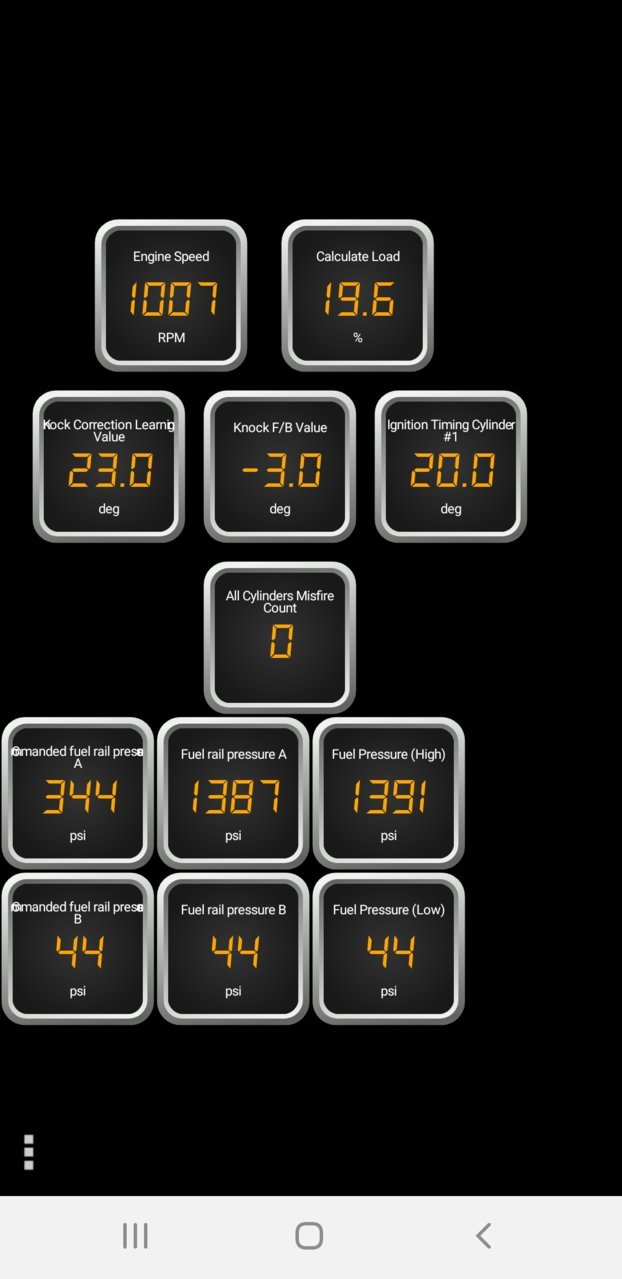

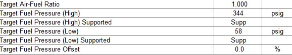

    Toyota PID for that is Target Fuel pressure High and it is the same value at idle 343.6 on Port injection mode
    It is about 1000 at Port+DI injection Mode
    So looks normal.

    I don't think it is reading pressure on banks. I think it is reading pressure for the direct injection system (Rail A), and port injection (Rail B). That is my guess. I'll post a photo of the two on one screen next time I have it warmed up. The Rail B system is always on the money. The Rail A system wanders quite a bit at idle and lower RPMs. That is also when my P11F0 code seems to turn up most frequently.
    I read that one way to check injectors was to over/under pressurize them to cause a fault. Overpressure would cause a leaker to go rich, under pressure would cause one clogged to go lean. If my cylinder five has a leaker the high pressure might be goofing up the fuel mixture causing the code. Of course, a burned leaking valve might do the same:-(

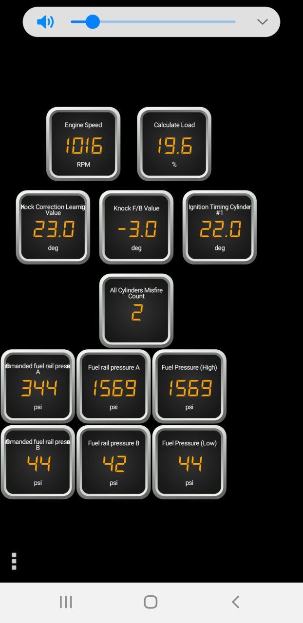

    Rail A is Toyota's High, B -low.
    Add injection mode to the monitor and you'll see why it is fluctuating on Rail A. Also add High pressure Fuel pump duty and it is spiking as soon as Injection mode go from port to Either (Port+DI).
    Your posted hunters are the same as mine on the cold idle. Bottom rows
    Can you get a freeze frame when the code is set?

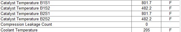

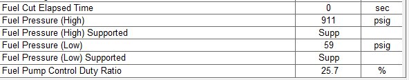

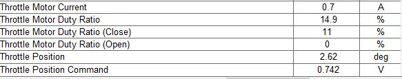

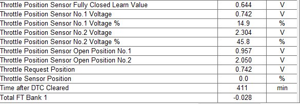

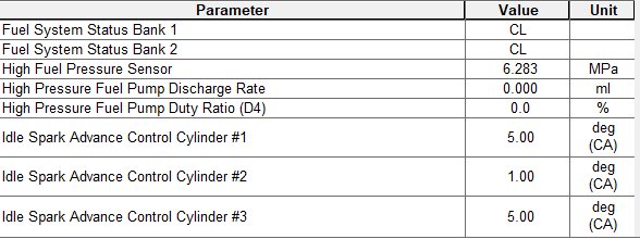

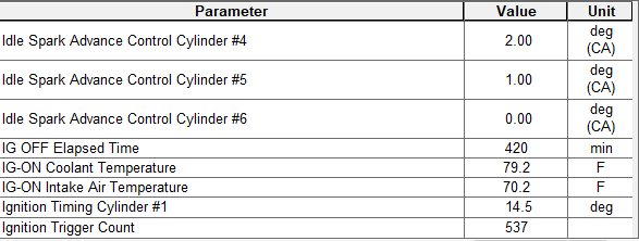

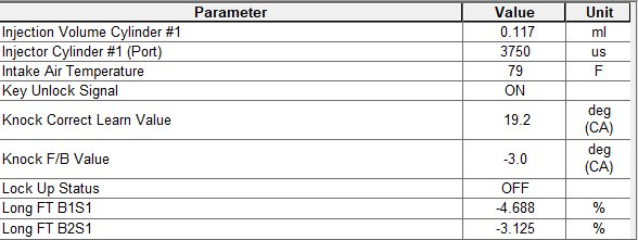

    so I browsed through my logs and found similar idle condition. I could not export the data to a file from Techstream.
    The only item stands out is LFT B2 value.
    Mine have been sitting in minus for many many miles. This is data when truck had 19K miles
    O2 B1S2 do look a bit different. See if you spot something else.

    12.10 . It is up to 2018, but I used it on 2022
    Yes, you can do everything in TS.
    For some reason the export did not work on that file. I only got headers exported.
