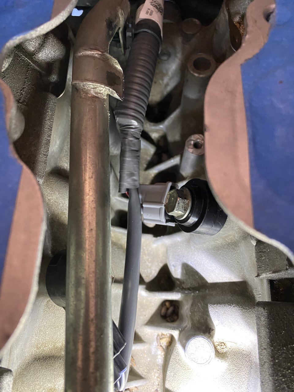

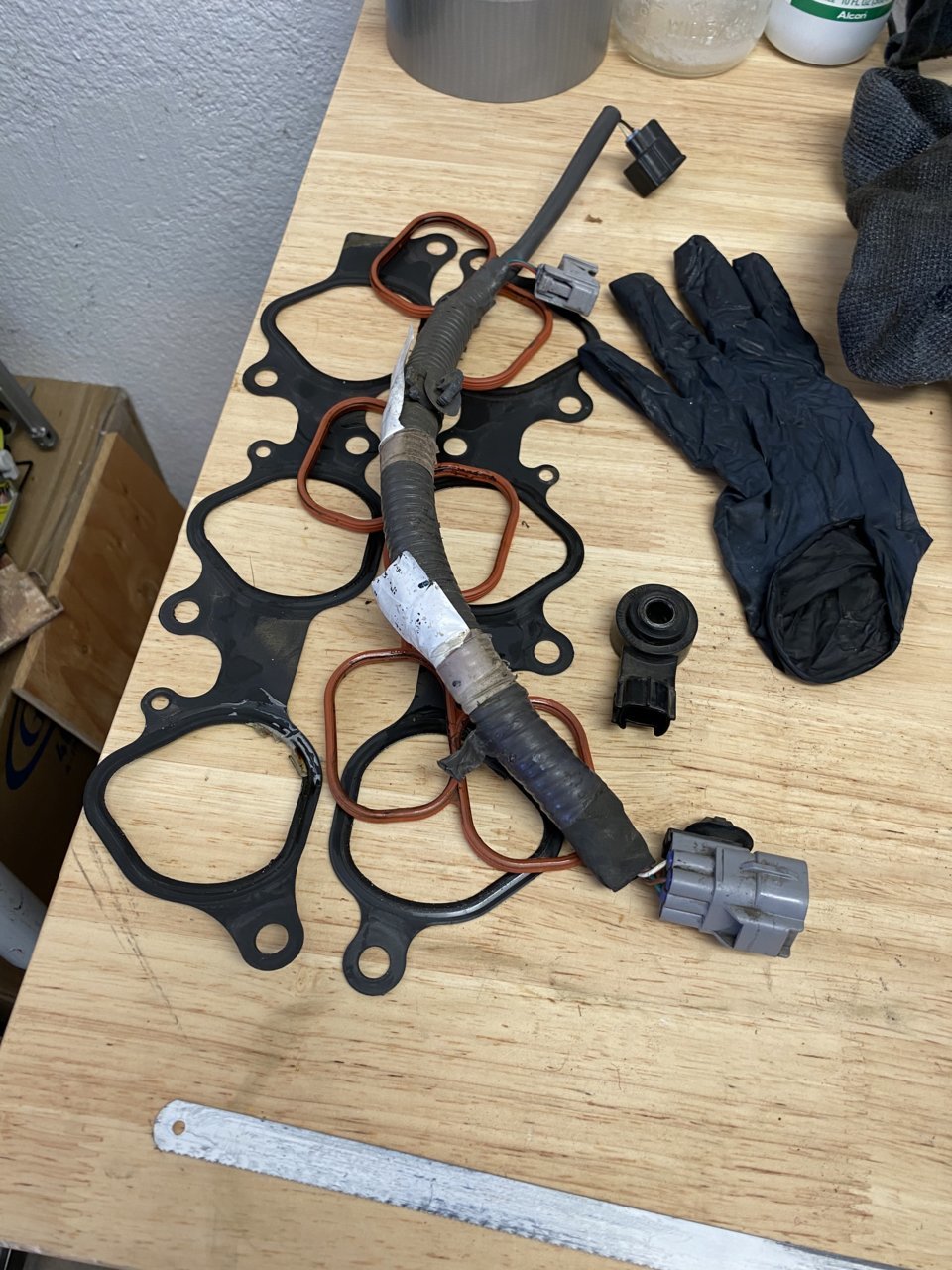

    It recently started tripping the CEL and code much more frequently, so I decided to tackle the project of digging in and repairing the "rodent damage" so many others have experienced. Pulled the intake manifold and all associated stuff as per many other posts, and finally got eyes down into the "V" where the knock sensors live. Only to find the wiring looks fine. P0333 is for the bank 2 sensor, and the connector looked perfect, there was a small amount of rodent evidence in the "V" but no obvious damage on the wiring except, oddly enough, a small amount of seemingly cosmetic wire damage to the bank 1 sensor wiring.
    I had already bought a new connector and sensor, so because of the lack of damage to the bank 2 connector and the actual damage to the bank 1 connector, I decided to replace the bank 2 sensor plus the entire knock sensor harness. I returned the single connector, and bought the whole harness.

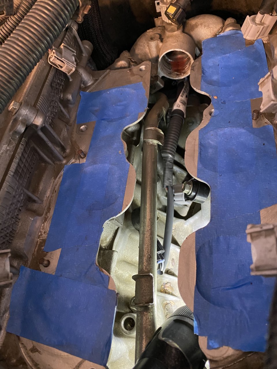

    This is where it got tricky, because it's fairly easy to pull the connector out and repair the existing harness, but replacing the sensor itself as well as the harness means I had to get in there deeper. As most know, per Toyota FSM, in order to remove the coolant pipes, you have to remove the heads (not gonna happen). So I did a little more research and found some guys online were actually cutting the bracket that holds the 2 coolant pipes together in order to remove the 1 big pipe. After much deliberation and trying to figure out another way, I decided to go for it.
    I cut the brackets using a hacksaw blade held by hand (no room for an actual hacksaw), pulled the coolant housing off the front of the motor, and removed the big coolant pipe. It was actually much easier than I anticipated... and now, if I ever have to get in there again, it's much easier to do. From there I popped in the new sensor (SUPER easy once the coolant pipe is out of the way) and replaced the harness. It plugs into another connector located at the back of the bank 1 head (a little tricky but not super difficult to get to).

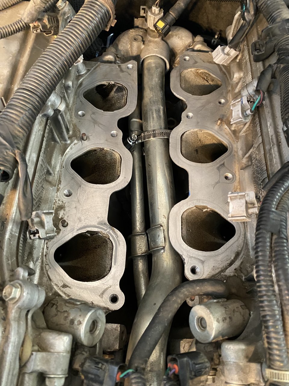

    At this point I replaced the coolant pipe O-rings and re-installed everything with new gaskets on the intake and plenum. Also quick side note: because I cut the brackets holding the 2 coolant pipes together, I took a big hose clamp and re-clamped them together to avoid potential vibrations between the 2 pipes.

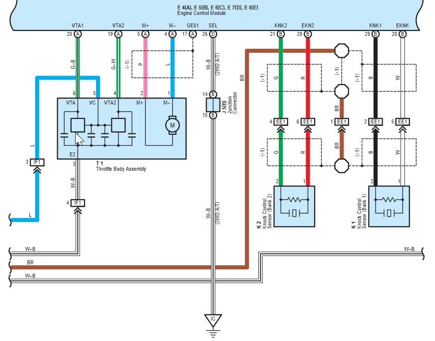

    Anyone have access to a wiring diagram that shows where the wiring goes between the jumper harness and ECM? I’m suspecting I’ve got wiring issues elsewhere.

    This should get you where you want to go.

    Thanks… so it looks like there are no other connectors or anything between the mini harness and ECM.
    Hmm. Gonna have to take a closer look at the main harness…
    ECM is inside the cab behind glove box correct?

    3 total
    The K2, K1 (at sensor), the EE1 (between senor and ECH, and E5 connector. (At ECM)
    Biscuits likes this.
