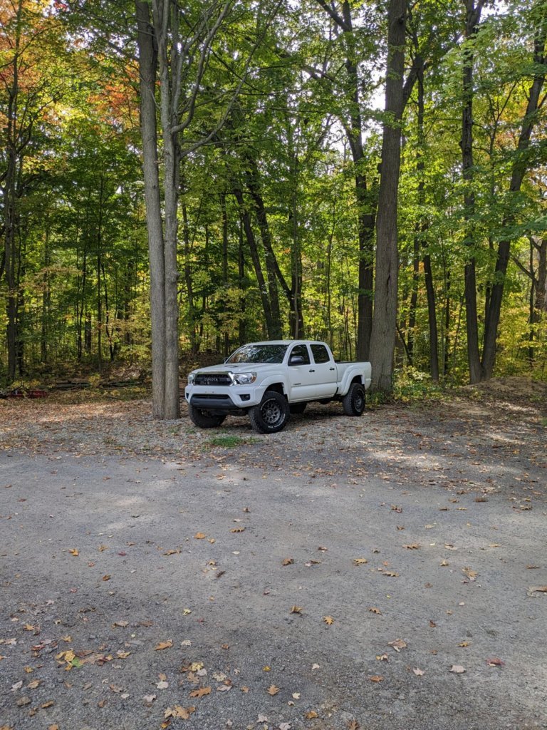

    Thanks for your time and I'm hoping I'm doing this right, pics of the truck shortly after I bought it:

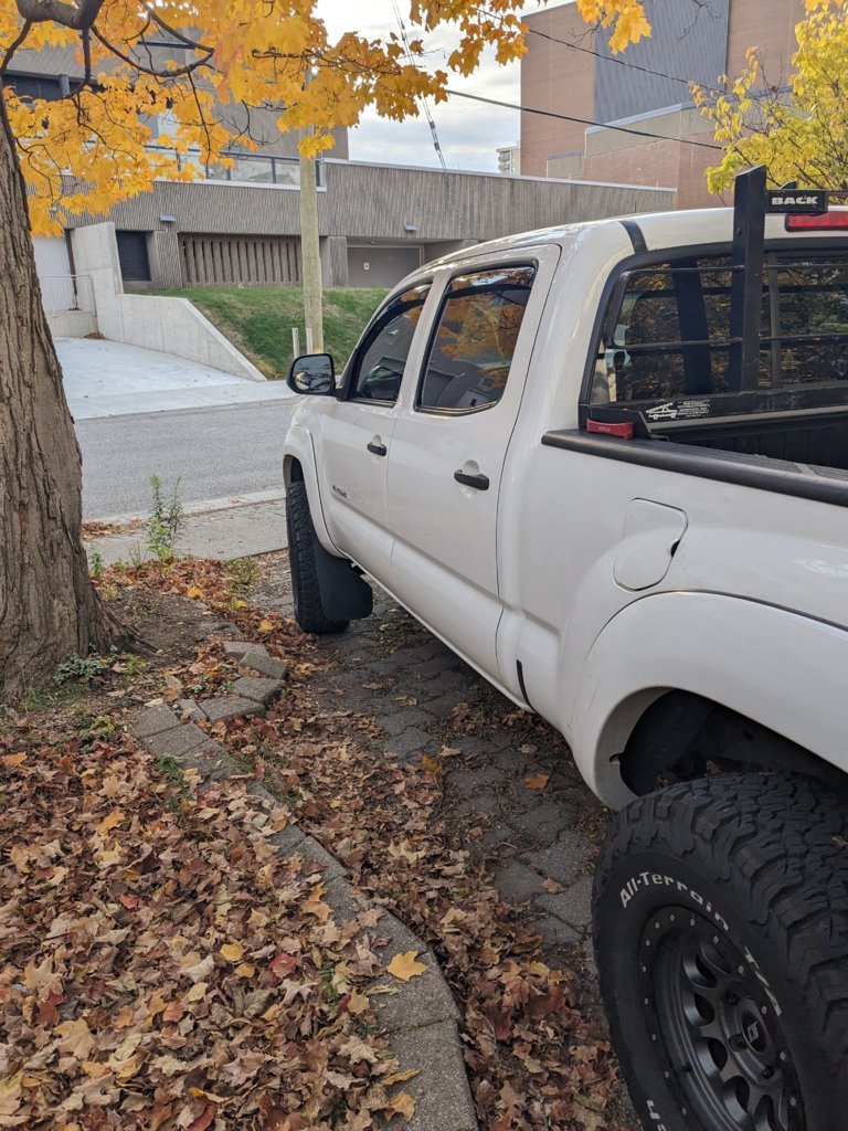

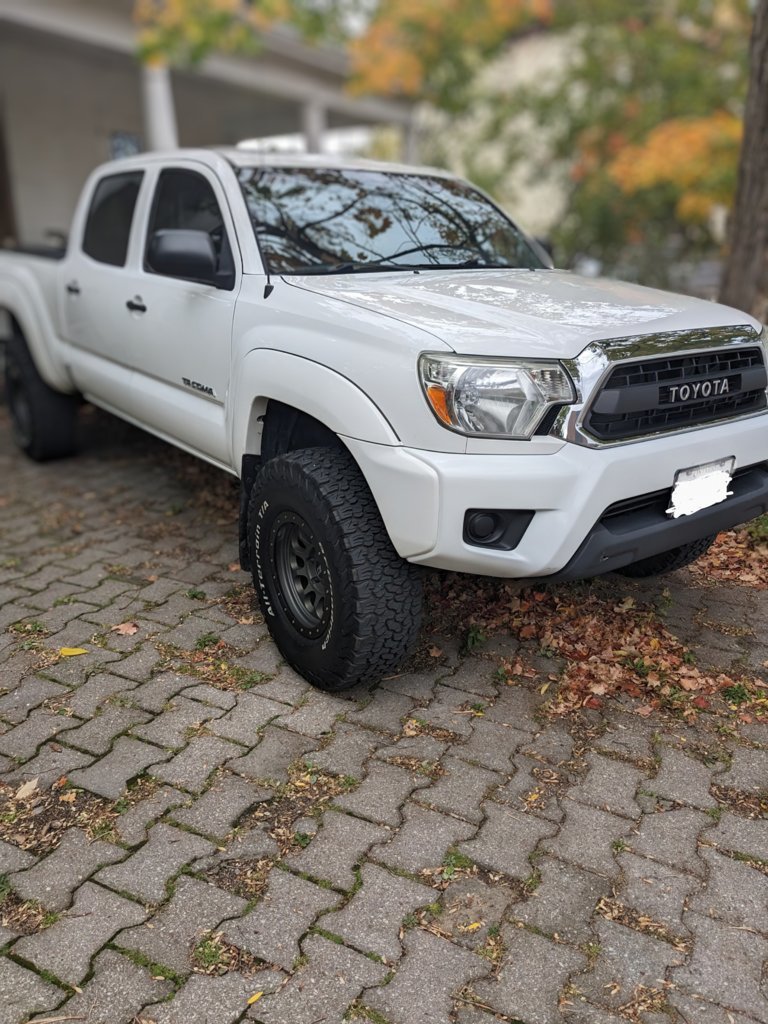

    More pics just cuz:

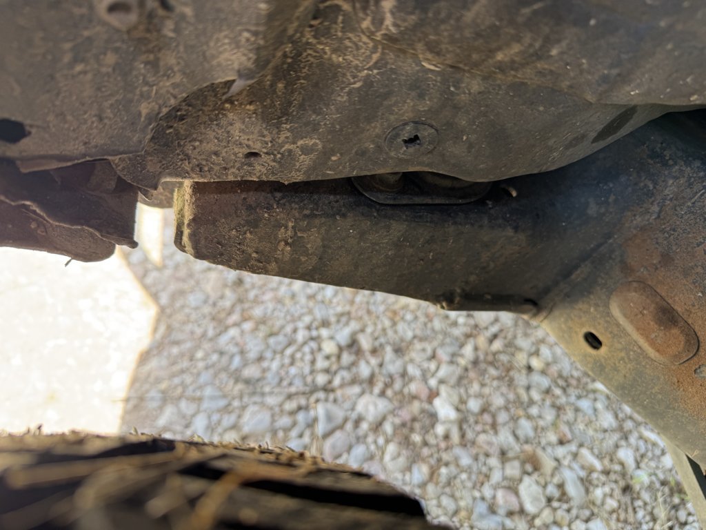

    That minor. Not a relocate, just trimmed and welded a plate up.

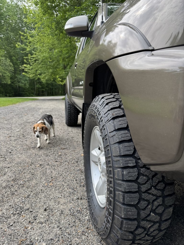

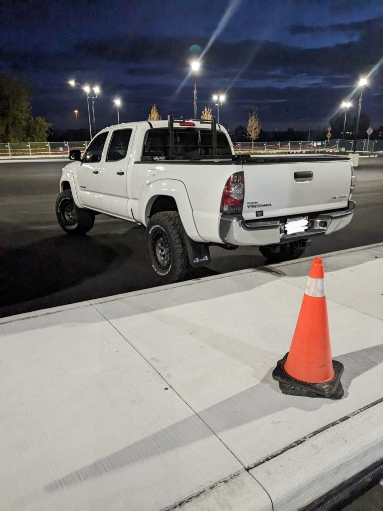

    I just put on 1st gen tundra wheels with 265/75/16. ~2” lift. The wheels brought tires out probably close to 3/4”. I’m like you and don’t particularly care for many of the stock wheels but I do like these quite a bit. Finding a pair might be difficult. 255/85/16 would look awesome on these wheels but I didn’t want 33s.

    Looks good! I thought the older tundra wheels had a crazy high offset, you have wheel spacers on? Any rub so far?

    no wheel spacers. From what I was able to gather online/tundra forums, the 16x7 1st gen tundra wheels are +15mm and 4.5 backspace.
    These will clear your calipers and I have no rub currently under all normal driving conditions, even with mudflaps on. I only go offroad occasionally to cut wood or get deer out of the woods so I’m not able to report on rubbing while flexed. But I anticipate there will be no issues
    D3ADLAST[QUOTED][OP] likes this.

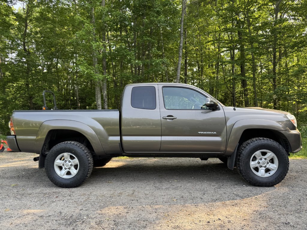

    I was surprised how much the change in wheels altered the overall look. I wanted to keep the “stock” look as much as possible. I was second guessing myself before I put them on because I thought I had to go black with the pyrite mica. But I’m actually liking the contrast with the silver.

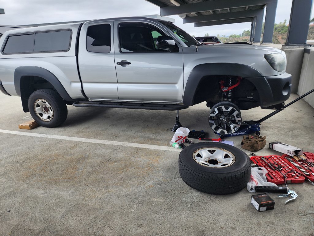

    I'm going with these 3rd gen wheels for the time being. They're +25mm offset. Just a temporary set for the time being, but they'll look good.
    I'm wrapping them in 235/85r16s, I'll have pictures tonight
    I've got a 2.75 6100 lift up front and 2.5 out back

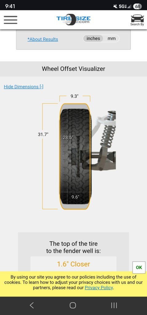

    I have the stock tire on right now, but when Im tire shopping I use this site to compare. It's not perfect, but it'll give you an idea Screenshot_20250612_094158_Chrome.jpg
