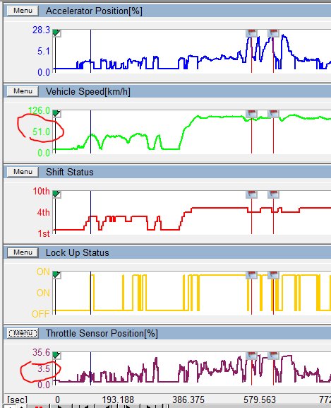

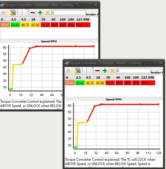

    I've been using obd2 monitoring since 2018.
    Even on some tunes it locks up at 40 on the freeway on-ramp.
    oem settings for tc full lock in S4 map is the same as D4 map
    Here is locking up TC at low speed (30mph) at 3.5% of throttle on some tune

    Can you explain those graphs in the 1st pic? Speed is on the X axis and what is on the Y? Engine load? In which case everything under the curve is locked up, including all the way down to 0 speed?
    Also is the 3rd gen on/off lockup, or does it vary with PWM? The data log says off, on, and on-on :D

    Throttle position.
    SR-71A[QUOTED] likes this.
