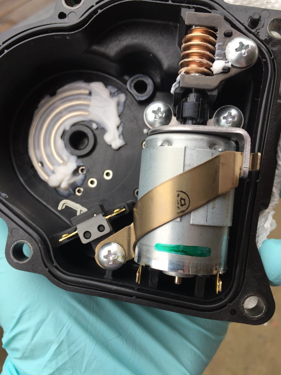

    Dealer ordered actuator, replaced it and still not working. Afrer they tested the new one they found it was defective. I did not want to wait and decided to order it myself. Took off the old one. Motor works fine when i put power to it. Gonna solder the connections. Anything Else I can do to it? New one will be here tomorrow if I cannot fix this one.

    Replace all the grease in the actuator, spray some lube in and push the ball bearing in and out on the limit switch. If the motor works, every other part in the system is replaceable. I would not, under any circumstances pay the dealer to put in a new actuator. If you look on ebay, used but perfectly working units are available for around $200. It is 3 bolts to take the thing on and off- dont need jackstands or anything. The dealer told me they wanted to replace all my actuators and the transfer case!!! I said no, cleaned and lubed all actuators, and they all work well now. I bought a spare on ebay in case they go out eventually. I am less than $400 in and now I know how it all works. No idea why they thought it would be appropriate to replace transfer case- best answer the tech could provide was "sometimes they cause shifting problems too"... Good lord.

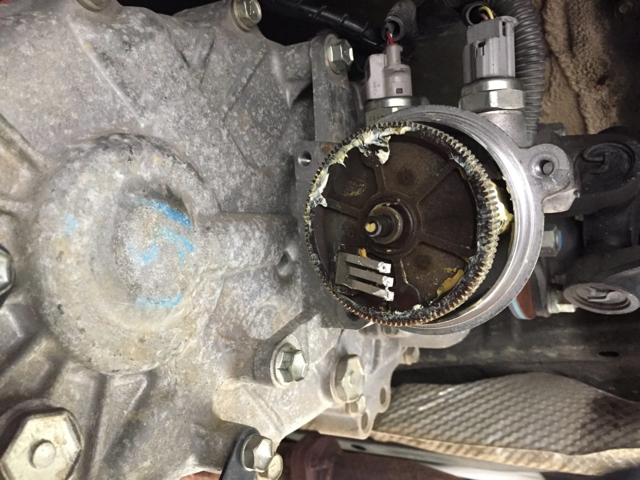

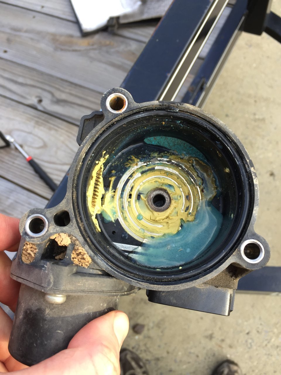

    I worked on this thing most of the weekend. I put a new front actuator on it and it still was doing the same thing. So I think the odds of 3 different units being bad is unlikely. Maybe the dealship is wrong. I took off the back actuator (on transfer case) and it is full of water.

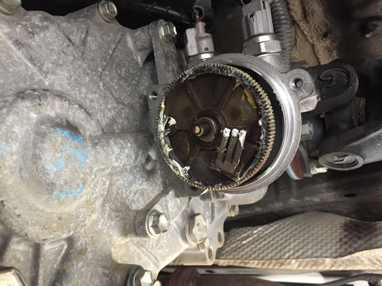

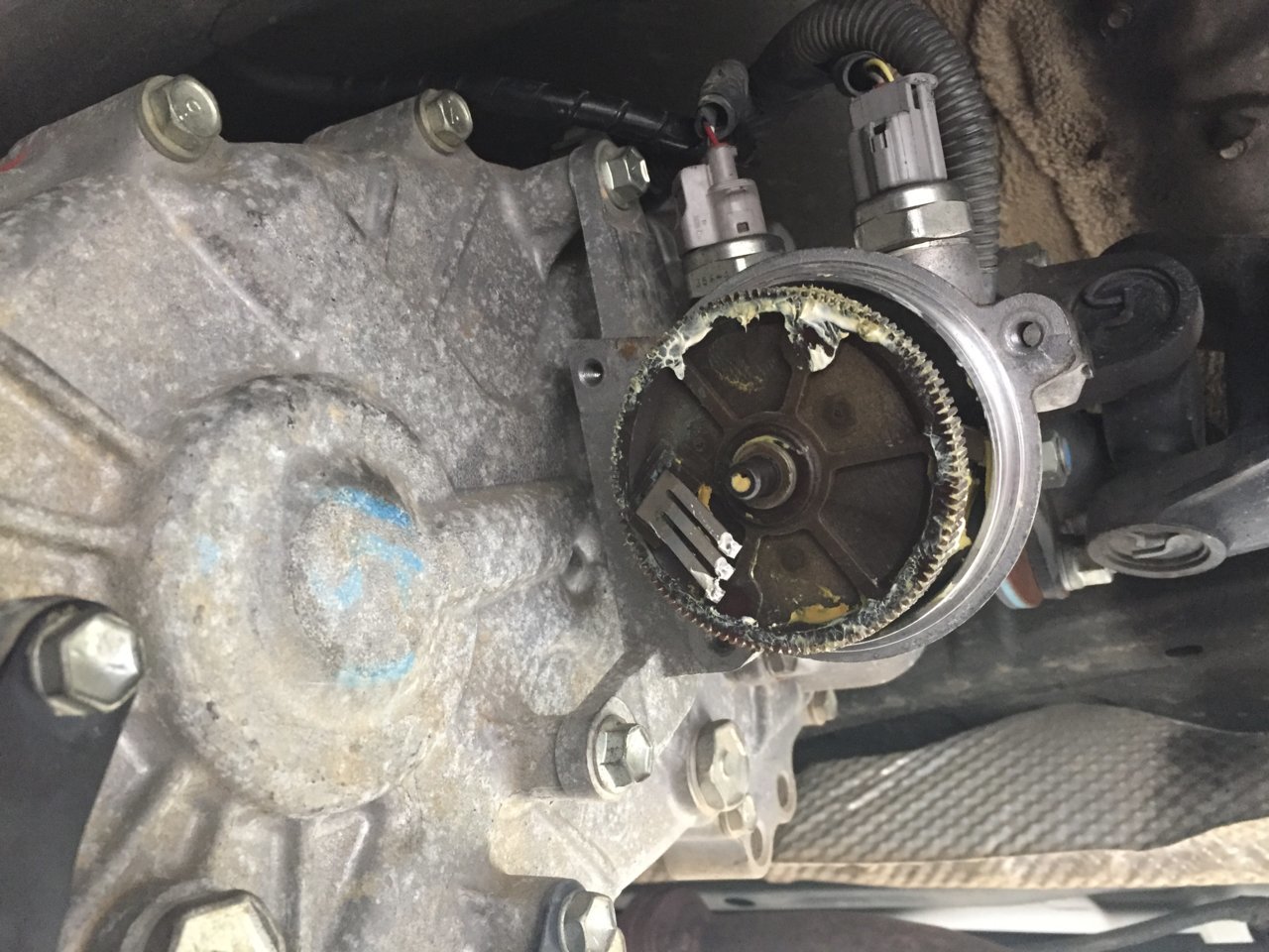

    So I cleaned it up, put new grease in it and put it back in place. Still not working right. I decided to take it back off and try and make sure I removed enough corrosion. Upon removing it the gear system falls out. I dont know where to position it as the contacts as reference.

    Now it is in the wrong place and I am stuck in 4 low after messing with it a few hours. Any ideas what to do? Even if I get it back into 2wd my problem is still mot fixed. The motor in the rear actuator works fine. Not sure if I have a bad switch in it, too much corrosion, or maybe the ecu.

    -First I took off the old one and the motor worked fine when I put 12v to it. I soldered the connections and put it back in place and it still was not working correctly.

    -I took the case off the rear actuator and it was full of water. I felt I knew this had to be the problem. I cleaned everything very well and applied some new grease. This did not fix the problem.
    -After trying to remove the case from the rear actuator the second time the spindle came out with it and this is where it really became a PITA because the 4wd was not working and I could not tell how to place the spindle correctly.
    -I took the truck back to the dealership and told them everything. They put the new front actuator on the truck that they had reordered and everything worked correctly. They also took the cover off the rear actuator and adjusted the spindle for me. Everything works well now.
