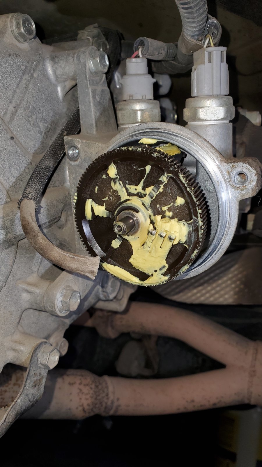

    Just for reference this is where the gear should be with the Transfer Case in 2wd (shift rod all the way in).

    If I take that cover off, is that gear going to stay on that shaft or is it looking to fall off easily?

    If your careful in taking the cover off it should stay there, also take care not to cut/roll the o-ring when reinstalling the cover.

    So got that cover off. Only snapped one of the 10mm. Inside was surprisingly pretty clean. Lots of yellow grease, hardly any contaminants. Cleaned everything off, gear stayed in place. Put it all back together to test, with no grease since I still have to drill and tap for new bolt. Still no joy. Same situation. 2hi to 4hi, green light blinks, front drive shaft engaged, front add not engaged. Tap on tx case actuator and front add engages and green light goes solid, into 4wd.
