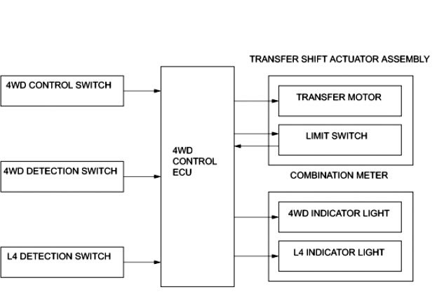

    Unfortunately I haven't... I was really hoping it would be the failure of either of the 2 transfer case indicator switches that are located on the transfer case #84222 forward switch and #84222b aft switch (Easy cheap fix). I tested each switch and they show no resistance which means they should be working properly. However, i looped a wire (paper clip trick) to complete the circuit on the the aft selector switches and was able to get the 4hi light to stop blinking but it also illuminated the 4lo light and than would not allow me to operate the 4x4 system at all...
    My next guess is the shift motor on the transfer case. Maybe its not actuating all the way since the transfer case seems to be getting electrical. Or maybe there is an issue with the vaccuum system? Starting to think the $105 isnt such a bad price for pinpointing the issue...

    Well i cleaned inside the transfer case actuator with electrical contact cleaner and no luck. It was pretty clean and there seemed to be plenty of grease on the contactors.
    I posted on ih8mud.com the problem and a toyota service guy posted the electrical diagram for the ADD. Referencing the sequence of the 4wd on these trucks he believes its the indicator switch on the ADD.
    I have since tested the ADD switch indicator wire and it shows resistance while in 4hi (grounded). If this confirms what the toyota service guy believed my next step will be to take apart the ADD (pain in the ass) and clean the electrical contactors on that actuator. Hopefully this does it... other wise i might just take it to the dealership and have a diagnosis performed because i would hate to replace the ADD without that actually being the problem (since it does engage the 4hi).

    Well a little good news i guess... The system is now working properly (not sure for how long though).
    I posted the same thing on "Ih8mud.com" and a very knowledgeable toyota tech service guy posted the electrical diagram of the ADD and his guess was the indicator switch on the ADD was not relaying back to the ECU that the vehicle was in fact in 4hi (due to the sequence of the 4x4).
    So My brother (electrician) tested the indicator switch wire on the ADD with an ohmeter and it was showing significant resistance. Therefore the switch wasn't closing or completing the circuit which is why the light would continually blink eventhough it was in 4x4.
    My next plan was to open the actuator and clean the electrical contactors in hopes of it just being a contactor issue that could be cleaned. However, It warmed up out here last week and i washed my truck including the underbody (wash the salt away) and for whatever reason the 4hi light works now (stays on) and i am able to once again engage the 4Lo. Not sure if its because it got warm out or the water did something or it was electrical contactor cleaner i had sprayed a week earlier inside the ADD electrical actuator housing that had finally settled. Either way it works but im sure ill end up replacing the ADD at some point in the near future...
    Also, it would have been wise to actively engage the 4x4 actuators every month rather than just the winter season to ensure smooth operation.
