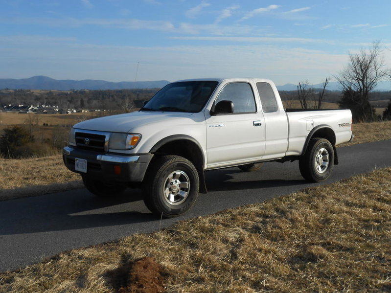

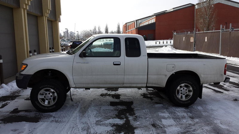

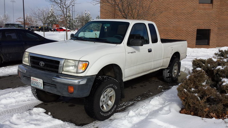

    After strut install, toe went from 1/8" to 7/8", with plenty of positive camber. So first got an alignment. Sure enough, the adjusters on one LCA were frozen, but the top had just enough to get camber back in spec. Even with the temporary bro lean, turn-in is crisper and there's a lot less body roll. Now to get the AAL.
    Hope these pics show the difference in front height:
