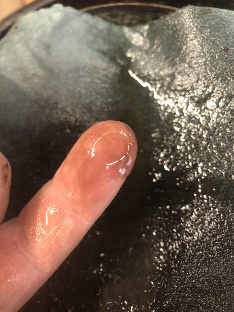

    IMG_0365.jpg This is what was on the drain plug.IMG_0364.jpg This is what was left on the paper towel after running the oil through it.

    Most likely bad master or slave cylinder. With the master cylinder being plastic on your truck I’d start there. It won’t be anything to do with the shifter or trans fluid.

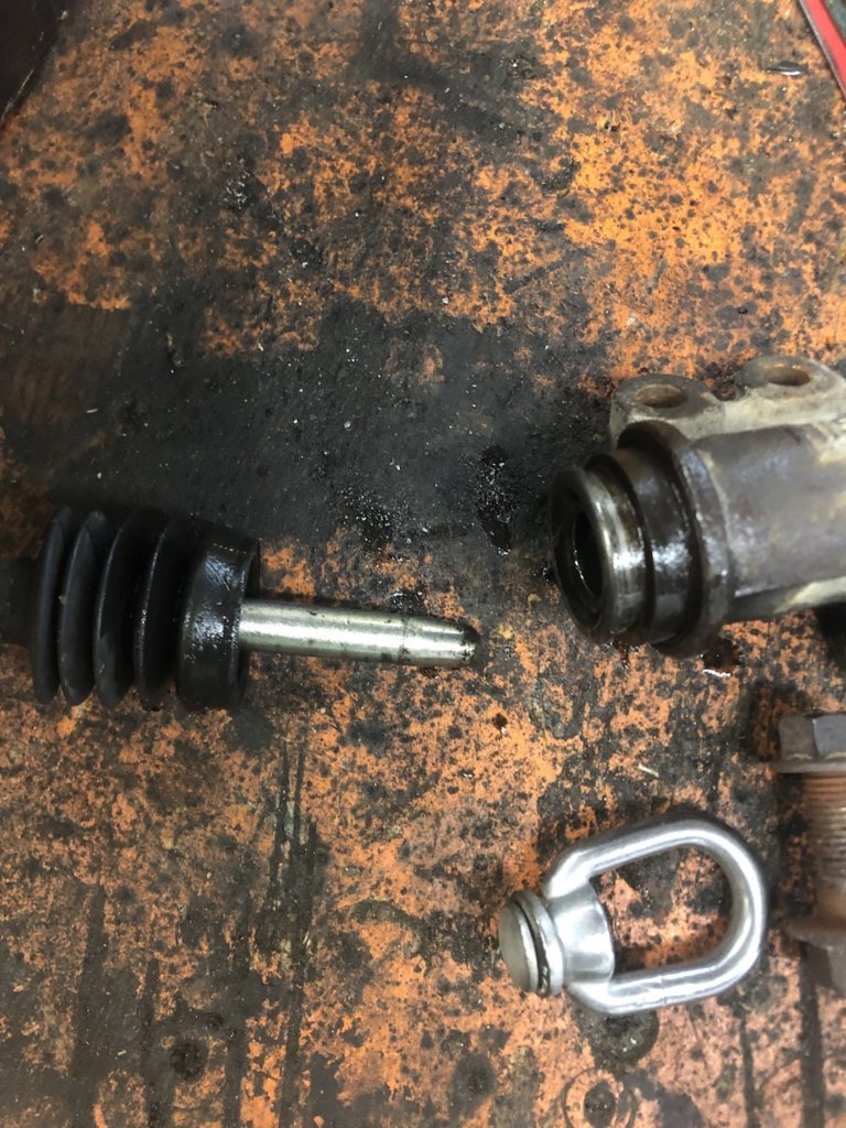

    IMG_0367.jpg May have found the culprit. Fluid poured out the boot when I pulled it apart.:fingerscrossed:

    Wasn’t the problem. Not getting locked outta gear anymore but that noise didn’t go away. Opening day of deer season is tomorrow and I’ll mess with it later.

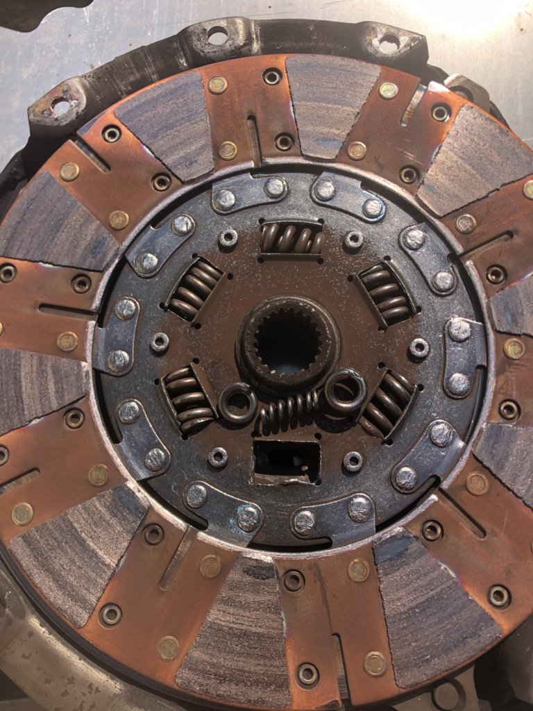

    IMG_0379.jpg I think I found the culprit.

    Yeah, that’ll do it. I figured that was unlikely but it’s always a possibility. Pressure plate going bad is also a possibility. Sounds like you had two issues between the leaky slave and the bad disc.

    I can’t believe as bad as that clutch looks it never slipped. The day it became a problem I had driven over a steep windy mountain pass in the Cascades ( also drove over the other way two days before) and was trying to pull out from the last stop sign to my house and I wouldn’t go into gear. Guess I got really lucky there.
