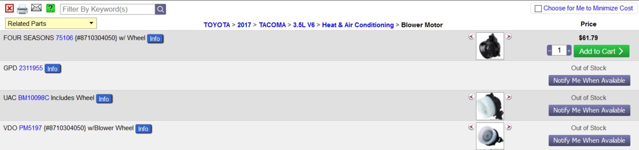

    Not sure if aftermarket units will be any better. Looks like we have some choices when they come back in stock:
