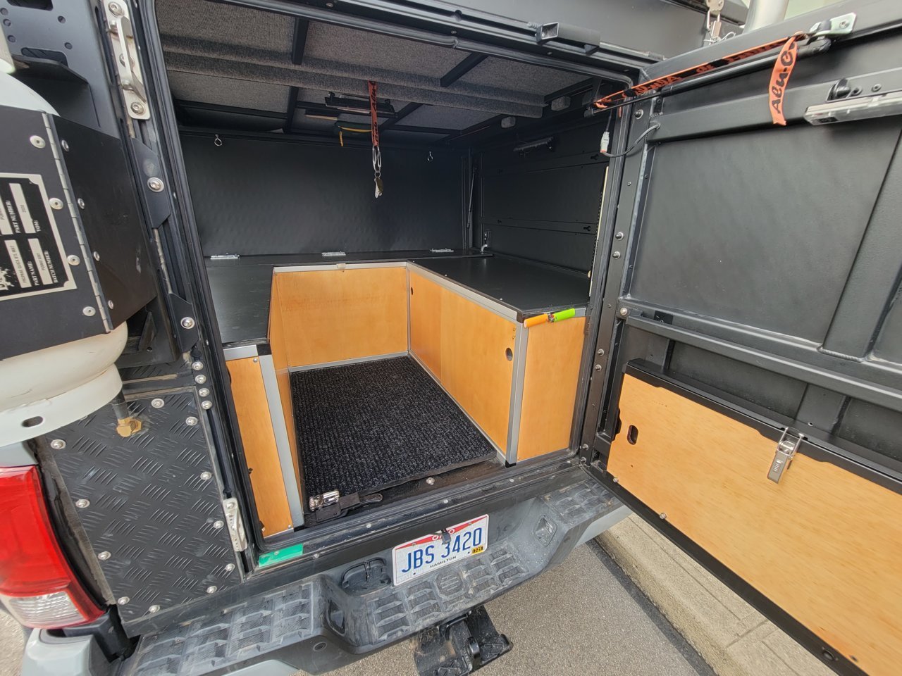

    A bit more work has occurred since the last posting.
    I was able to wire up the entirety of the power system to the best of my abilities.
    All systems are a go, with juice being sent from the alternator to the house battery while I am driving the truck around, keeping it charged up.
    The inverter ran my blender in the mornings, and the BlueSea DC panel powered the lights that are built in to the ACCC during the night. Multiple power ports throughout the ACCC allowed us to charge our cell phones at night, just like we would if we were in a regular house. This is so ridiculously convenient.

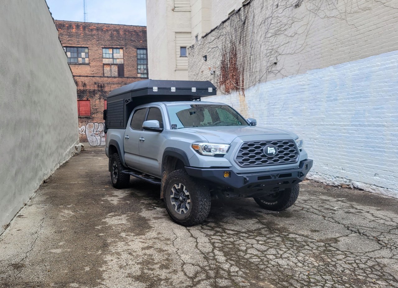

    Picture from this past weekend, outside of Superior, AZ near a popular climbing spot called The Pond and Atlantis.
    [​IMG]Tacoma near Superior AZ by Michael Rickerd, on Flickr
    Another two nights in the camper just made me enjoy it even more. It is still remarkably convenient. The power setup was wrapped up before leaving on this trip, and that made the experience even better.
