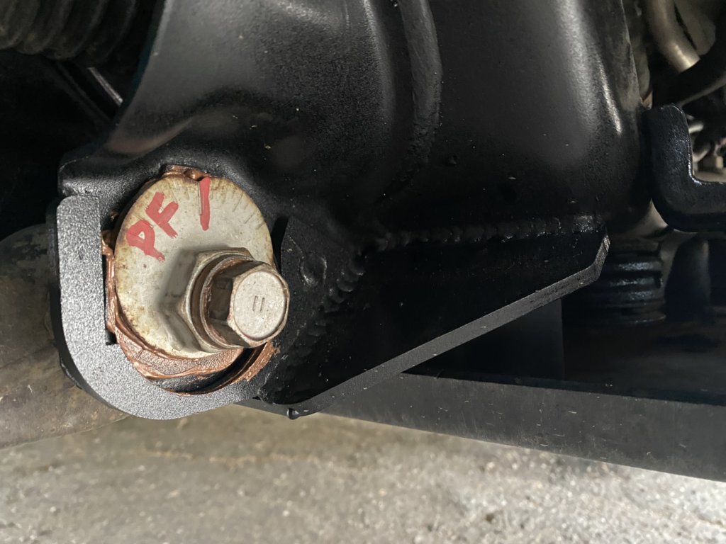

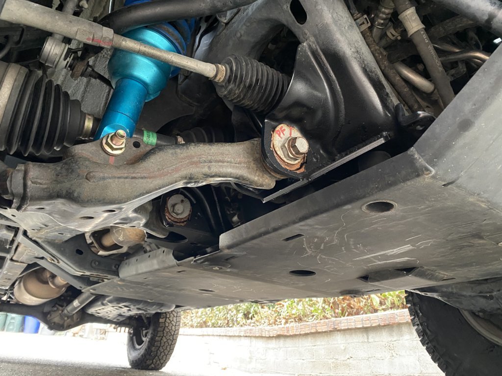

    @MR E30 I recently had the Marlin Crawler lower frame brace kit installed, and it is beefy. My buddy had to trim the skids slightly to clear the braces, but the alignment is pretty stout now. The kit does req a bit of welding, but it ties the frame and cam tab supports in. That summer trip looked amazing by the way!

    Can you explain or show me where the skids needed to be trimmed? I can't tell from your picture.
    Do you have the dual shear UCA plates installed? What are your thoughts on that upgrade?

    The skids had to be trimmed for the aft LCA mount support plates(about 1/2in trim on fwd skid and trans skid), so very minimal trimming required(i have RCI skids, others have said they didn’t req trimming with different skid configurations). I do not have spindle gussets yet(RC fab has some that fully box the spindle and clear stock wheel backspace, although the weld work would be around $800 by itself(in the futures for me)), and haven’t done the dual shear upgrade for the UCAs. Those are the few remaining upgrades i still have to do, but my steering is having play so ill have to replace/upgrade that rack first(tundra upgrade looks good, but it significantly reduces turning radius). Almost forgot to add a photo!IMG_0373.jpg

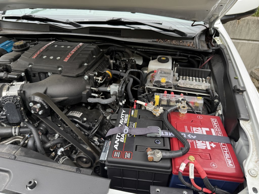

    I have decided to install and experiment with this Dakota Lithium battery. I will begin by simply lacing it under the hood and using it to do nothing other than starting the truck and driving around for a while. As my confidence builds in it, and I can trust it more, I will look into incorporating it into my house battery system, or at least the trucks power system, in some way.
    There are a variety of reasons for this upgrade, but two main reasons stick out. One is the lighter weight of this battery, which is nice, especially with the OEM battery tray being known to fracture/split/tear from frequent offroad use. Hopefully this will cut down on that happening. The second is an additional 135ah for no extra space.
    In order to sync up the battery and the Victron Smart Shunt, the battery needs to be at 100% charge, so I am using the included 10A charger to top it off.
    [​IMG]Random by Michael Rickerd, on Flickr
    I will touch more on this process further along in this post.

    I’m interested to hear your findings on the Dakota Lithium battery. I have the Genesis 4x4 dual battery kit that I just had converted to dual lithium batteries with a Redarc battery controller on the Dakota Lithium house battery. The starter battery is an Anti-Gravity lithium battery that has a built in restart function.

    Nice, do you have any photos you can share?

    Very nicely done!
    Thank you for sharing.
