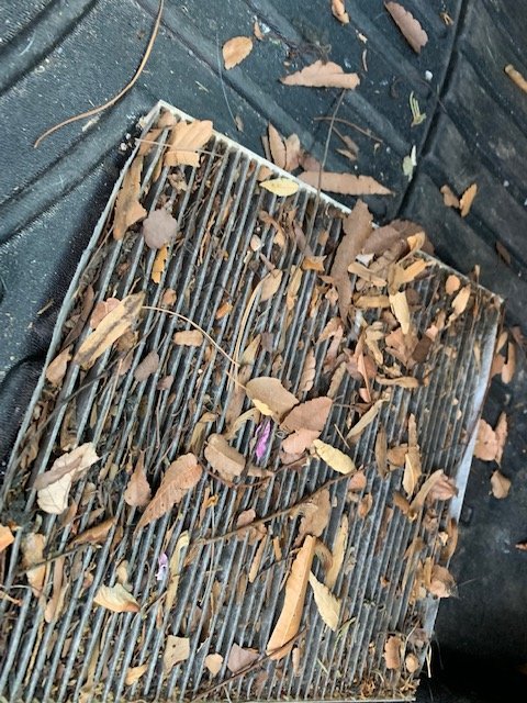

    Not saying this is directly connected but...Check your cabin air filter, make sure its fresh and that mice haven't been piling terds and pine needles on top of it. Happened on my 2nd gen

    Not a bad idea since I don't recall the last time I replaced it. But almost certainly not mice since this is my DD and lives outside.

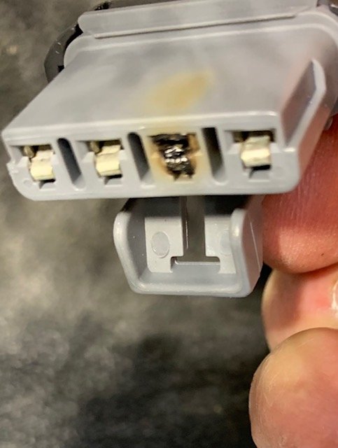

    It is likely not the resistor. It’s either a loose resistor connection or a loose/burnt fan blower connector. I have had both issues but never a bad resistor.

    Well, I got into this today and Chuy was spot on. Not the resistor. I wiggled the connector and the fan started working in all speeds again. It was indeed that same bad burned contact as mentioned in another thread here and that you see in everyone's photos from doing this job. The wires are fine, just that one fried contact. I'd like to replace just the contact but I don't have the tool for popping those out, nor do I know which tool it needs. So I am probably going to just cut the old plug off and solder up the new one. Not going to bother swapping the resistor for now.
    And thanks to Archive for reminding me to change my overdue cabin air filter! Egads!
