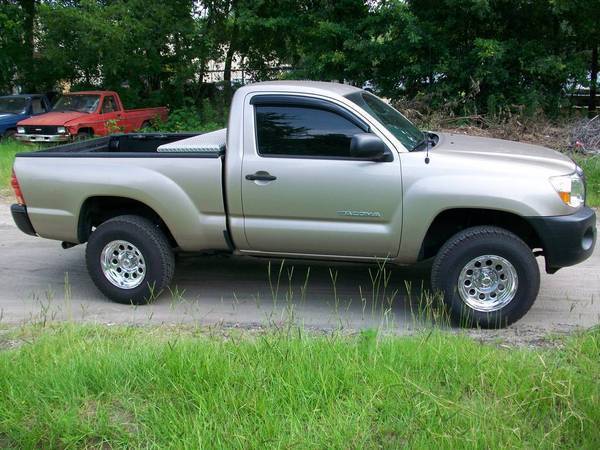

    THATS WHAT I DID AT FIRST I DIDNT CHANGE SHOCKS WITH THE LIFT[​IMG]

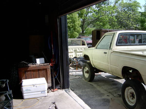

    THANKS! T[​IMG]HIS WILL BE MY OFFROADER WHEN I GET IT FINISHED. HOPEFULLY IN A COUPLE MONTHS

    I take it that's the SST kit ?

    Not too bad cept i cheated a little. I used a lift at the repair shop next door for the front. I gave the serv mgr 100 for helpin me and mountin and balancin my tires and lettin me tie up a lift for a couple days . It wouldnt have been any harder on jackstands tho. I had to put it back on the ground to bolt the brake lines back on. It goes just like the readylift video on u tube on the frt. The back centering bolts they give u just taper the ends and smooth em theyll go right in. The botoom shock plates under the axle hafta have the center hole reamed out. I had a big taper bit no big deal. I also had another truck to drive so i had plenty of time. It could be done in a day with 2 people. Watch the video a coupole times

    Yes. Sst kit i weighed a stock wheel they weigh 26lbs my new ones weigh 19 my tires weigh 37 . I havent weighed my spare to see what the factory combo weighs. My 18" wheels m tires weighed 52 lb. I bought this truck 6 mos old the 18's were on it already. I used the stock tires on somethin else so i didnt have them to check weight.
