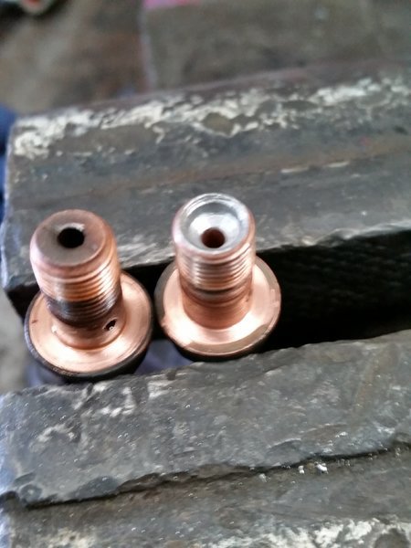

    20161029_140401.jpg If your banjo bolts bottom out before the line is tight and quits leaking. You'll have to drill the bolts out a little. (This is when using original hose and banjo bolts)

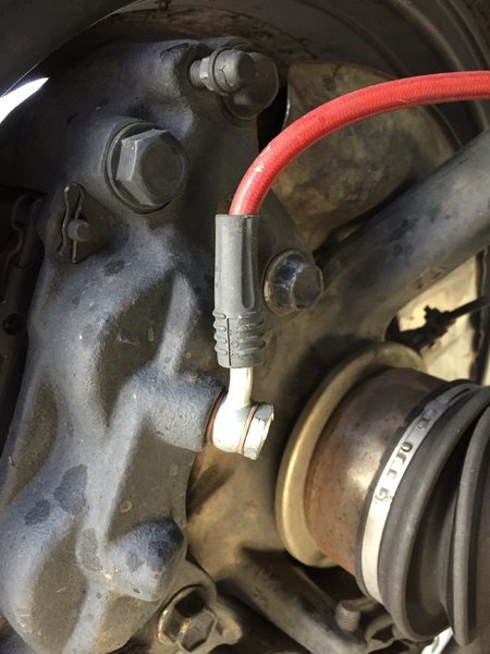

    My wheelers lines

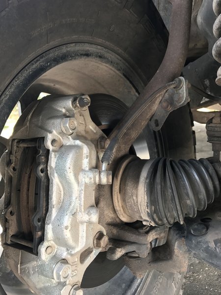

    just took a pic of the package.
