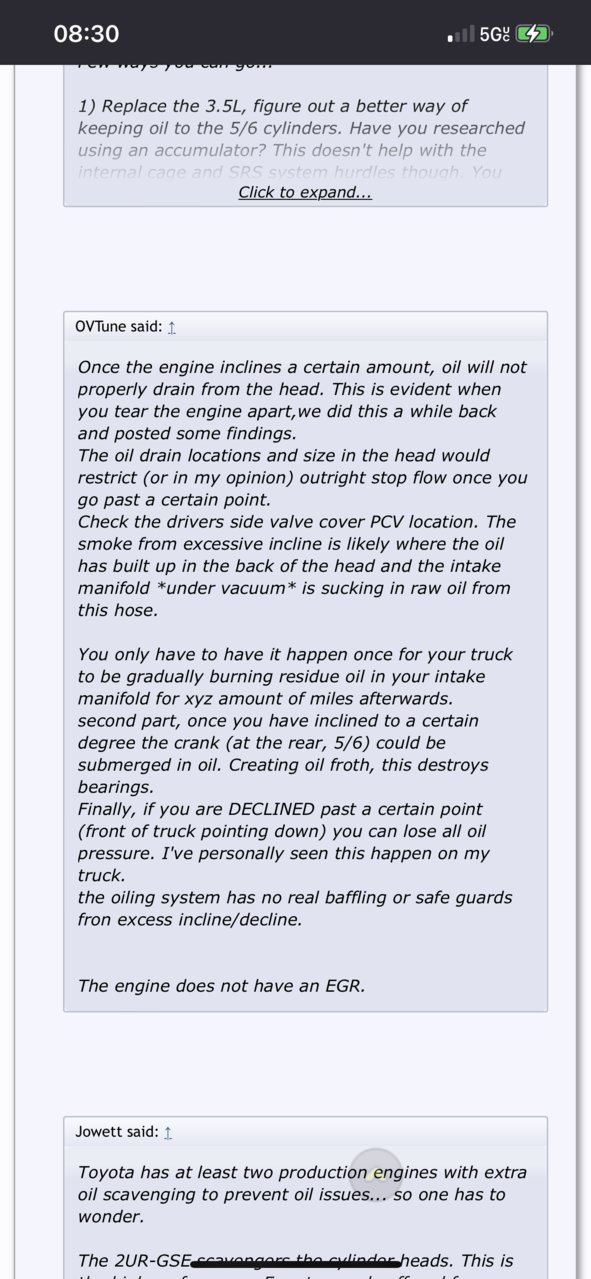

    The bummer to me is, there’s two issues. There’s the pooling in the head (grey smoke, pcv etc). Then there’s starving the pickup tube. Which is what I think this was.

    I thought I recall ovtune mentioning that in certain attitudes (uphill vs downhill) you can either “over flow” the drains in the head so that it gets sucked up by the pcv (this is where a catch can would help), or starve the oil pickup. I could be remembering wrong tho.
