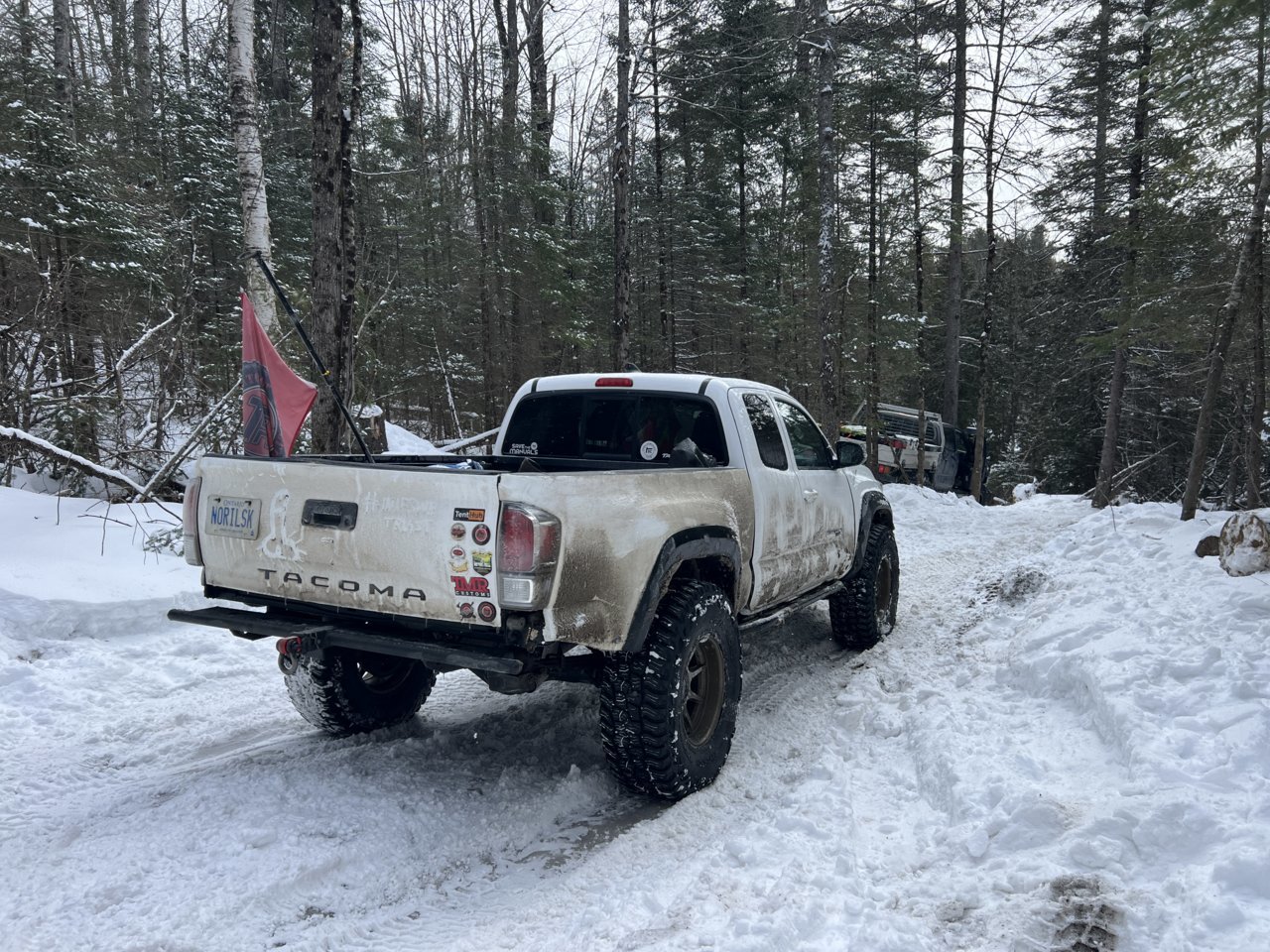

    I wheel with a group of largely 3rd gen guys who beat the PISS out of their trucks, more extreme than anyone could reasonably expect. @Norilsk is on 37s, and wheels the shit out of his truck on the most extreme inclines possible. Buggy lines, etc. Hes also at 180k km without a single issue.

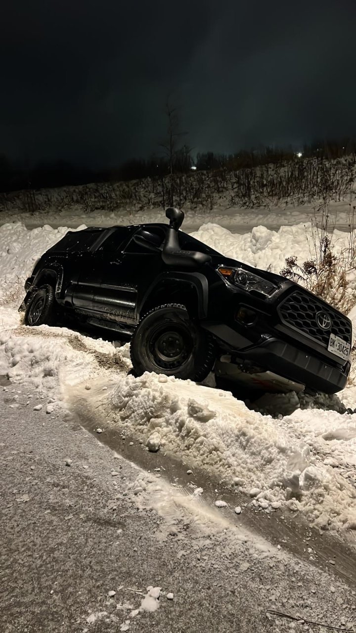

    My point is, 3rd gen issues are extremely overblown on this forum, because of how many trucks have been sold. 99.9% of these trucks won’t have this issue. I have personally flipped my truck nearly on its side and only had cosmetic damage, no oil made it somewhere it shouldn’t be. The truck idled like this for half an hour without issue (-20, it was that or freeze, I did t have a coat)
    You will without question be able to do what you pictured and more with no issues in a 3rd gen.
