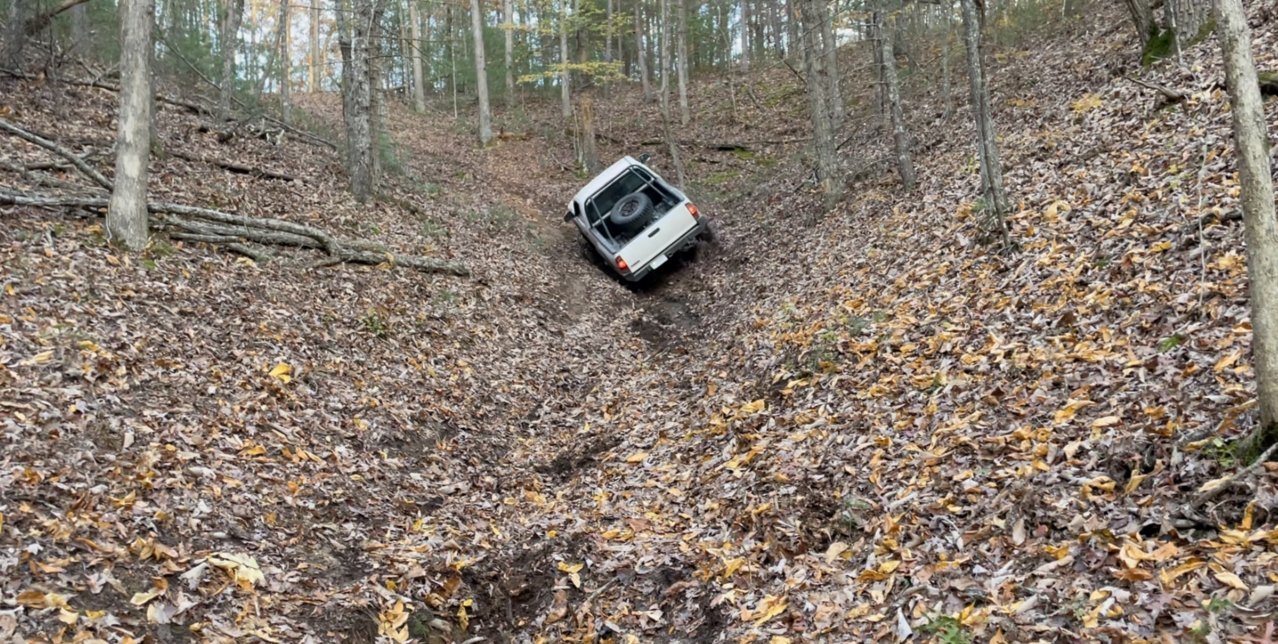

    Definitely puts the trucks in a tough position

  3. Mar 9, 2022 at 9:50 AM
    #43
    the.sight.picture
    the.sight.picture Wishes he was in the woods.
    Jan 22, 2012
    #71180
    7,992
    Nick
    Blue Ridge
    2018 QuickSand
    Check out my build thread (Beginning of Money Pit)
    Pictures dont do that thing justice

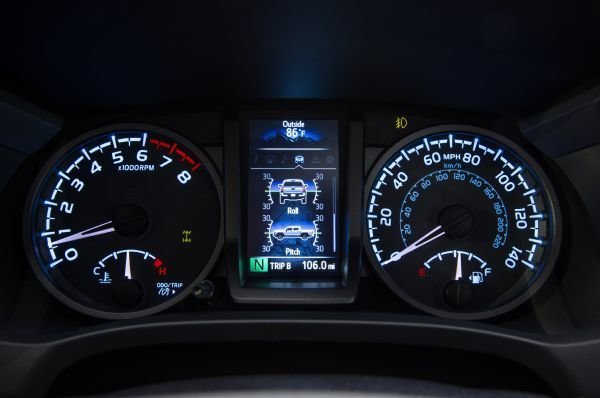

    Does anyone have an inclinometer and a ramp? Seems like it would be easier to avoid if people knew where the line was.

    Hmm, if only we had a pitch and roll indicator...

    Yeah I'd assume (and really hope) you'd have to be above 30 degrees for any issue to arise

    Funny that the Speedo maxes out at 140 but the inclinometer at 30. One of these is way more likely :laughing:
    Guess it doesn’t help figure this out then.

    If I had to guess, there is a spot in that hill that puts your truck over 40 degrees

    I've never paid any attention to mine off road, I always assumed the truck stayed level and the bezel rotated and would go higher if needed.
    Well, they'll do 125mph stock and most tunes raise it to 155...so I guess the limits of both could be raise a little.

    Wonder how much a lift and tire size could offset the angles of the factory inclinometer vs stock

    Shouldn't affect it by more than a couple degrees unless you've got some crazy bro lift or Carolina lean going on
