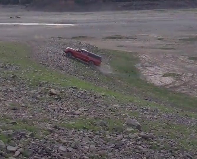

    Interesting. I believe that I have been way beyond that, but no data to know for sure. One climb did give me a pucker of worry about a smoke show. Thankfully nothing.
    This didn't feel particularly steep compared to other climbs, but I did goose here more than others:
    It makes sense that pure side-hilling would do the same, given the noted issue.

    The bearing failure would be possible on a very steep decent. The uphill situation is oil getting forced past the valve seals due to pooling in the back of the valve cover and also getting sucking into the PCV, back to the intake, and hyrdolocking in the worse case.

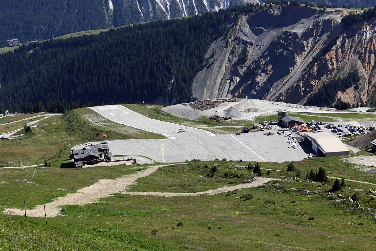

    I heard the word top speed, so I’m here to confirm that with a very long runway, proper tune, and a lot of patience you can hit just about 145mph. Never dared to go faster.
    44-16 Taco and Thunder Fist like this.
  15. Mar 9, 2022 at 11:38 AM
    #75
    tonered
    tonered bartheloni
    Sep 25, 2017
    #231055
    31,316
    tony
    Lynnwood, WA
    What were you doing in France?
