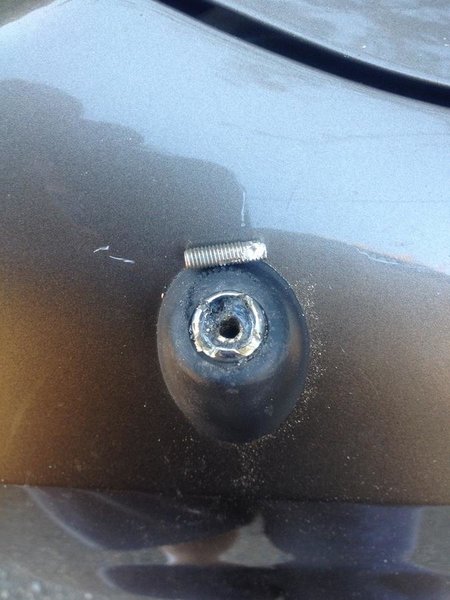

    A final update: After trying AGAIN to get the stud out (first saturating it with PB Blaster and letting it sit a couple of days) I ended up drilling AROUND the stud to free it (see pic).
    In the process, I discovered that the part of the antenna base that makes electrical connection with the mast is actually near the TOP of the base. I learned that when I put the new antenna in and it didn't work. Ideally the entire base should be replaced (about a $40 part) but I just pried out some of the metal surface and it makes good contact with the stud. Problem solved.
    Thanks again to everyone for their help & suggestions!
    FYI - an area stealership quoted me $278 to fix it.
