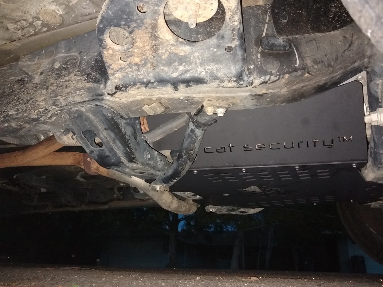

    I installed the Cat Security and it is fairly beefy. I also like that there are a lot of bolts that are used to attach it. My logic is the same as yours: no matter what I do, if someone is motivated, they're going to get the cats, but just maybe they'll see the cat shield and just move one car over. The lifted Tacoma is just too easy to get underneath so I felt I needed to do something. I didn't want a the weight or the rust of steel, so I'm happy with the aluminum.
    I painted it black, and the cut out side letters aren't super visible with it this way.

    What did you use? Did you primer? Sand the aluminum for adhesion?
    Obviously, I don't know much about spray painting without getting paint bits that peel off. lol

    Oh don't look to me for painting advice. I just grabbed a can of black Rustoleum and painted the outside areas. I did sand an area to increase the texture and compared it to another unsanded area, but I didn't see a difference so I painted the rest without sanding. Seems to be holding up well so far, and the areas most vulnerable to abrasion (the bottom) aren't really visible anyway.

    Might want to consider a heat type of paint...just saying .
