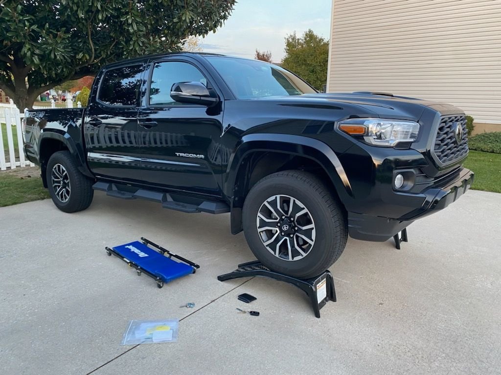

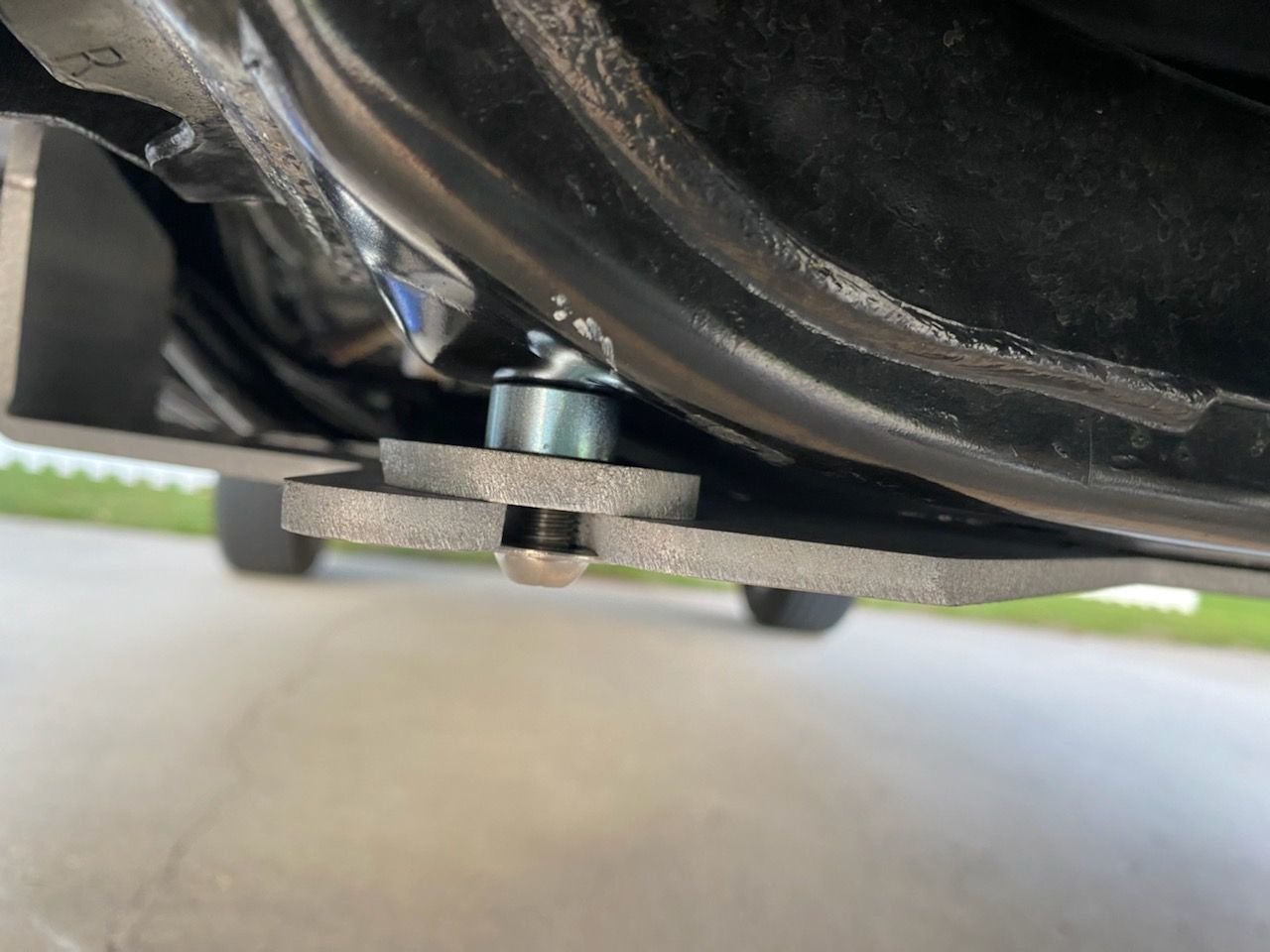

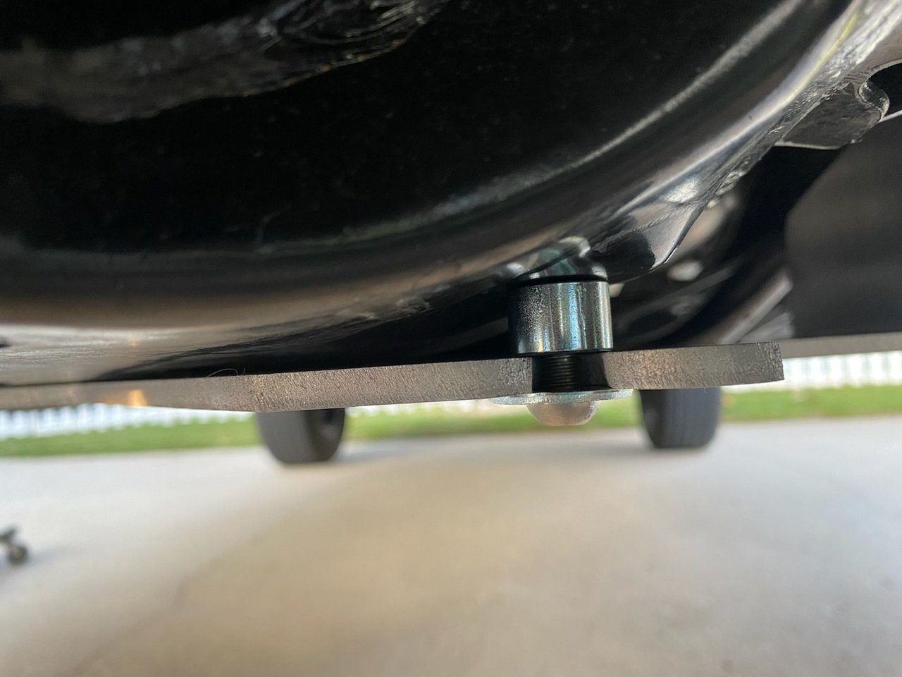

    Here's the 1/2 inch spacer:
    3/8 inch and 1/4 inch spacer:
    Full view of both fittings:
    I put back the original 3 (3/8 washers) but the 1/2 inch seems flusher than the 3/8 + 1/4 inch spacers which bows just a tad.
    The security bolts contents plus the spacers provided separately.
    I had to use my HF ramps since the Auto Hobby shop on base was closed for Veterans Day.
    Gave some decent clearance for me to move around with the crawler.

    Just to review...
    #1 The 1/2 inch spacer will suffice for the 3 (3/8 inch washers I used) better than the 1/4 + 3/8 inch.
    #2 The 1/4 + 3/8 inch spacers creates a bend/bow meaning it is not flush.
    Soooo,
    I am surmising your suggestion of #1 being the better fit with the 1/4 inch plate.
    Are you suggesting a 1/2 inch Talon plate from the 1/4 inch you are currently building? (BOLD letters above)
    Otherwise,
    my suggestion is the 1/2 inch spacer which closely matches the 3 (3/8 washers for thickness) with the 1/4 inch Talon Plate as the preferred match.
    This does not take into consideration adding a TRD Pro skid plate which is sandwiched below the Talon plate so shouldn't make a difference with the 1/2 inch spacer.
