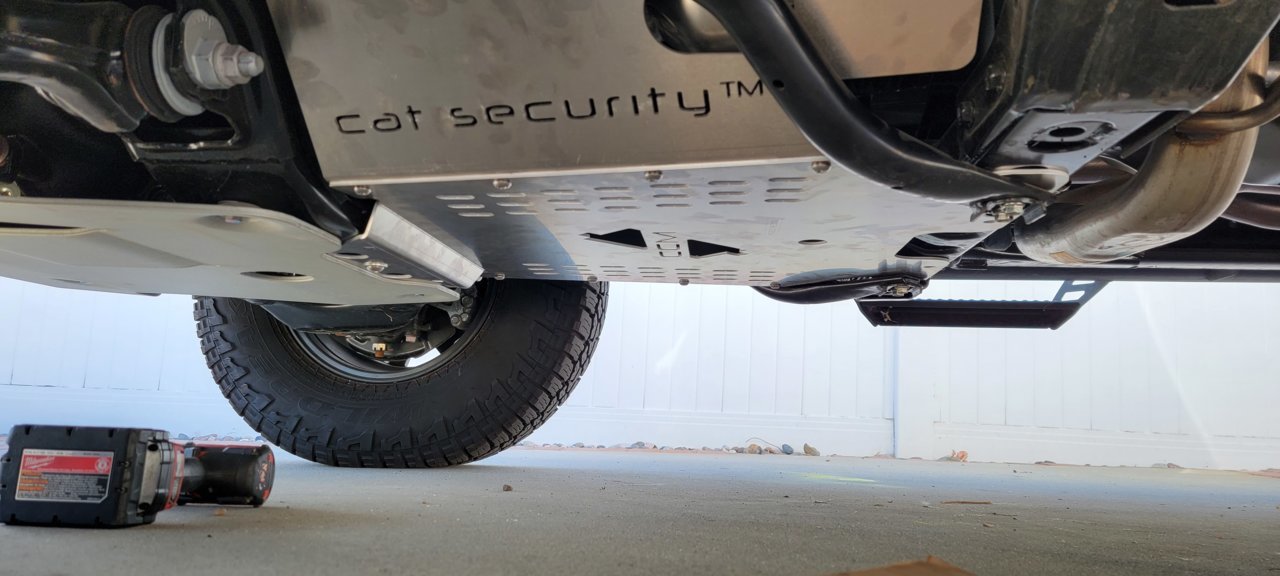

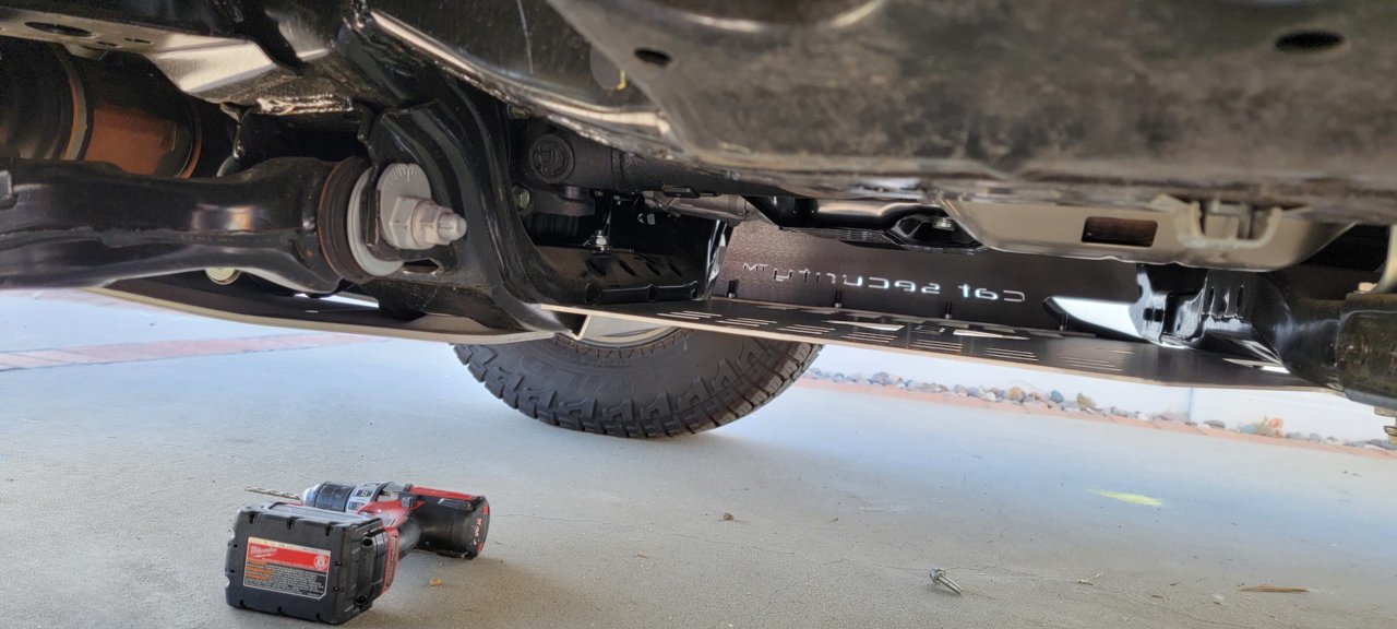

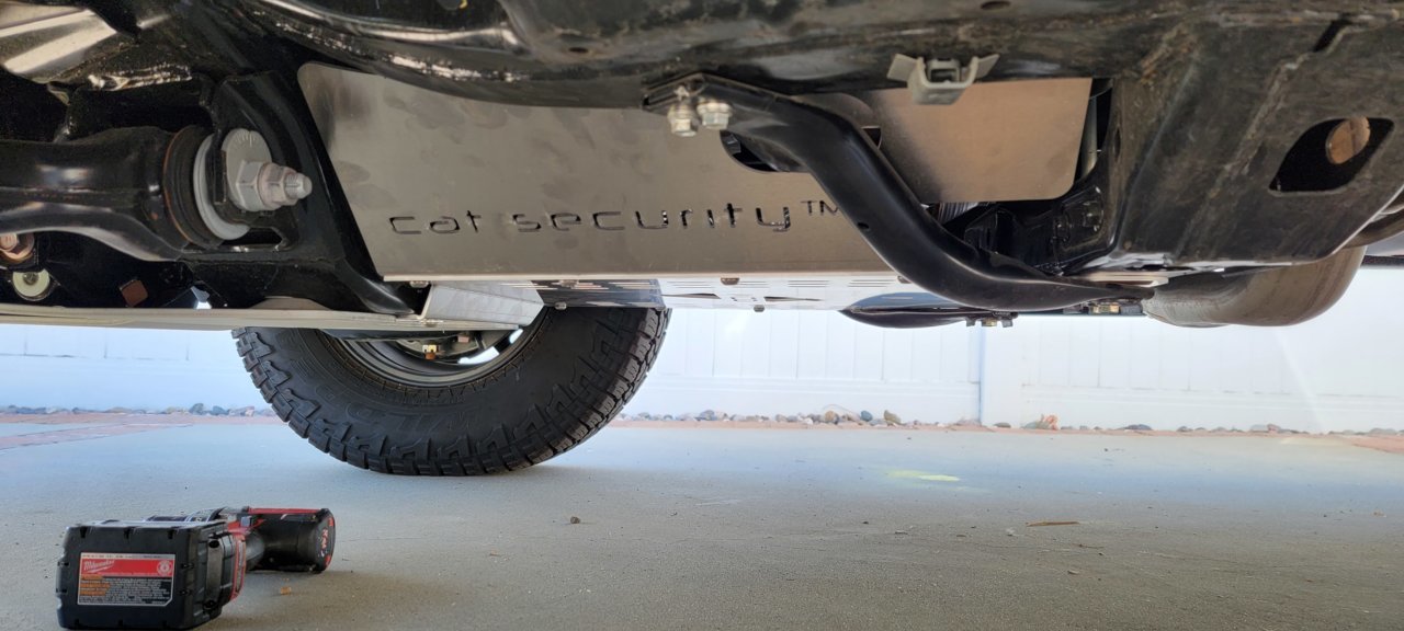

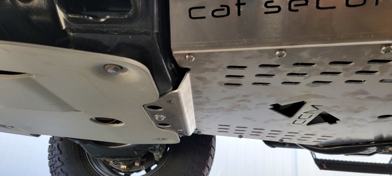

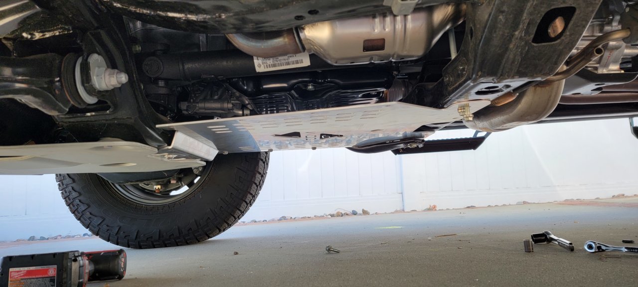

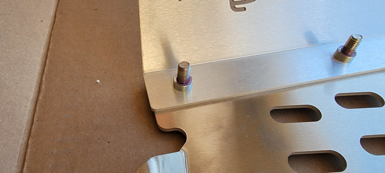

    Installed, didn't drill the extra holes. Loctite they provide is good stuff. Just wish there was a little more.
    Note to those with the skid plate. Only assemble one side plate until the bolt and plate are secured in the front otherwise you can't get to it. Install side plate and brace and done.
