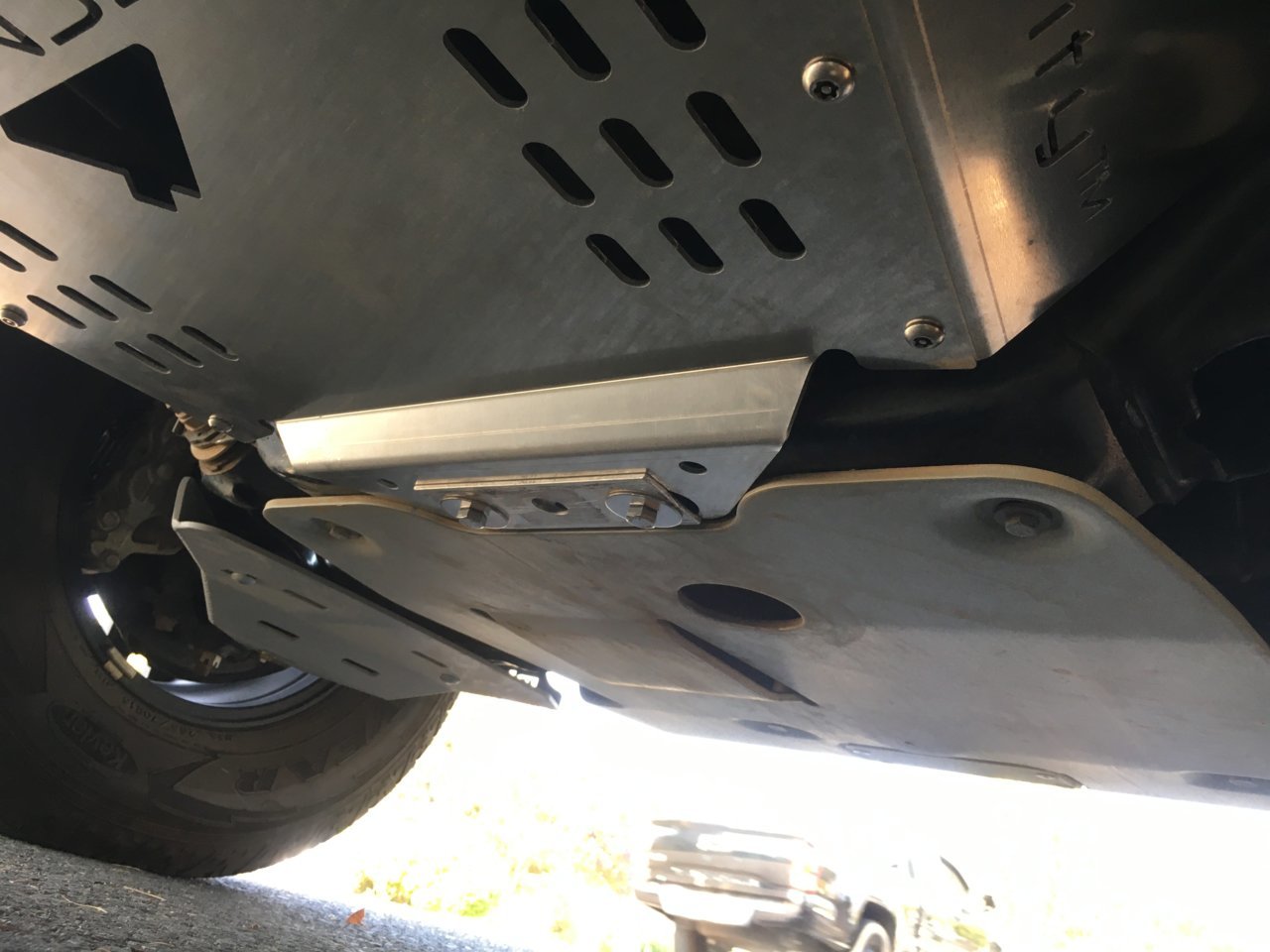

    It does angle down the TRD pro skid just a little. The thickness of the spacer/washer provided and the cat plate itself. I made I video on the install it’s been shared a few time on here.

    Any chance of a side shot picture on what the sandwich looks like?

    around the 11 min mark in the video. And I have this pic 22253B79-7B0B-4EDA-8A3A-72E737D8CA9E.jpg

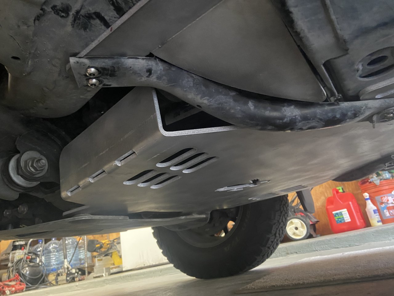

    I installed mine without drilling any holes in the frame. There are already 4 bolts at the back without the frame drilled ones, at the front side I cut an aluminum piece to fit below and above the frame so I could mount two bolts instead of one there, leaving the center hole and sides of the outer holes partly open for drainage. This has to be done before attaching the outer angle plates though, since you have to be able to reach the top of the frame rail there.

    Idk what the heck you said since i dont know shit about cars but i would like this in my truck lol

    That's a nice install!
    Don't have to mess with the skid plate because of the cutout.
    Another security measure to fund for my Taco. (I'm good with it...the wife, not so much...lol)
