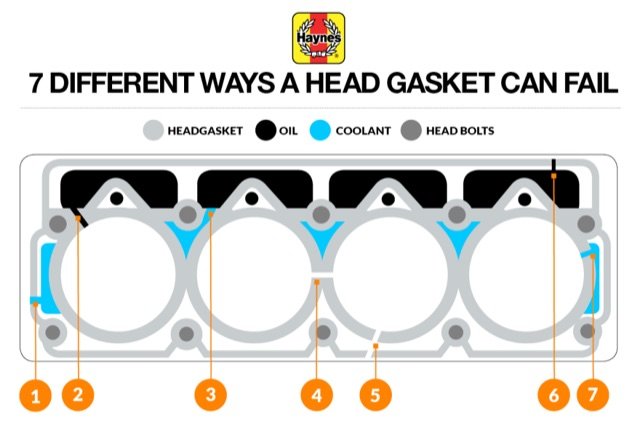

    There are seven ways a head gasket can go bad. It appears you’ve checked for #7 on the list below. You can probably rule out # 1 & 6 if you have no leaks. Start with a compression test.
    1) Coolant to outside leak
    2) Compression leak to oil galleries
    3) Water to oil leak
    4) Compression leak between cylinders
    5) Compression to outside leak
    6) Oil to outside leak
    7) Compression leak to coolant

    Thanks for the replies guys...oil is clean/blackish, no indication of water at all in the oil *except for just the slightest bit of milkshake under the filler cap- which i assumed was just condensation. Just color really..
    Like I'd have to clean it out the corners with a q tip. I know everything points to head gasket but was hoping I may get lucky by some off chance! Changed the valve cover gasket aswell and no milkshake underneath either. Has been taking about a quart of coolant per month or so...but some of that gets burned and some overflows the overflow!
