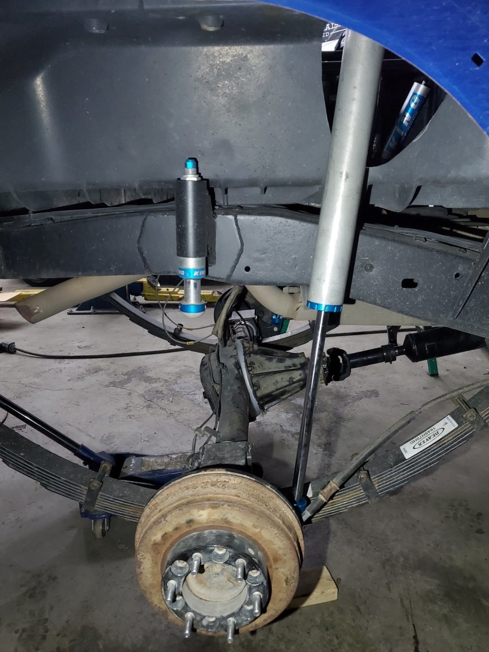

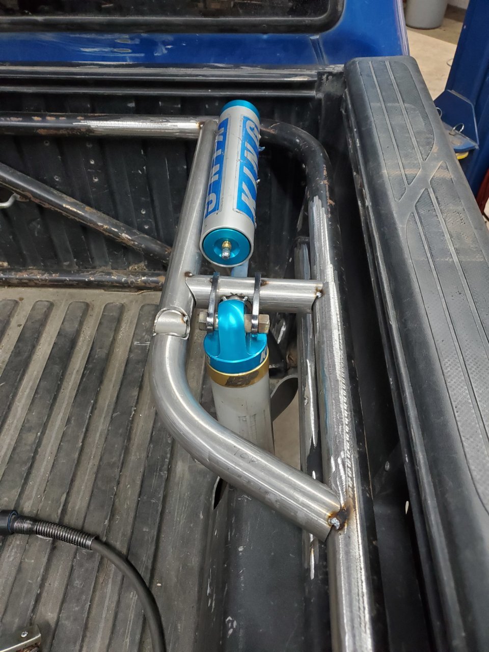

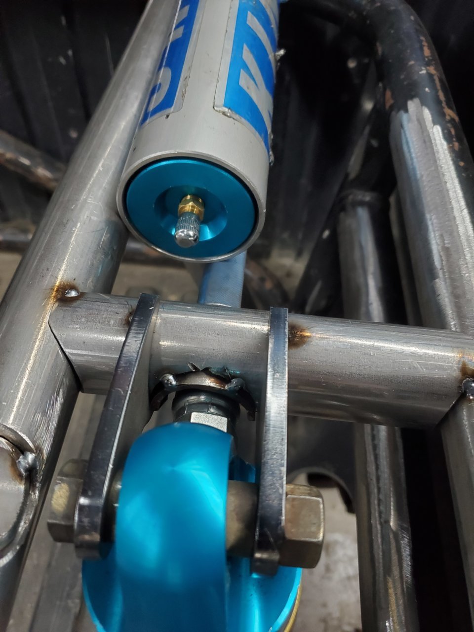

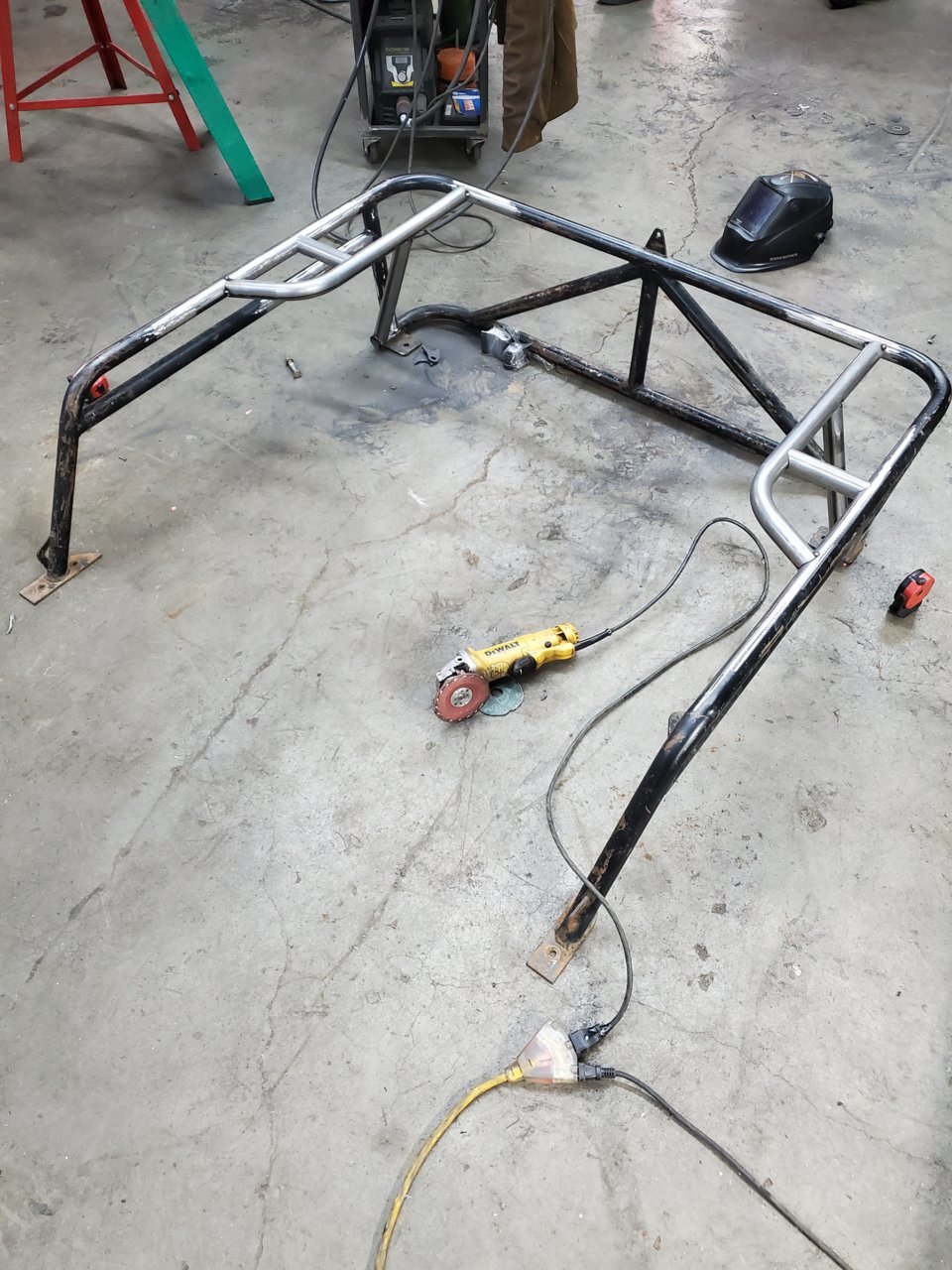

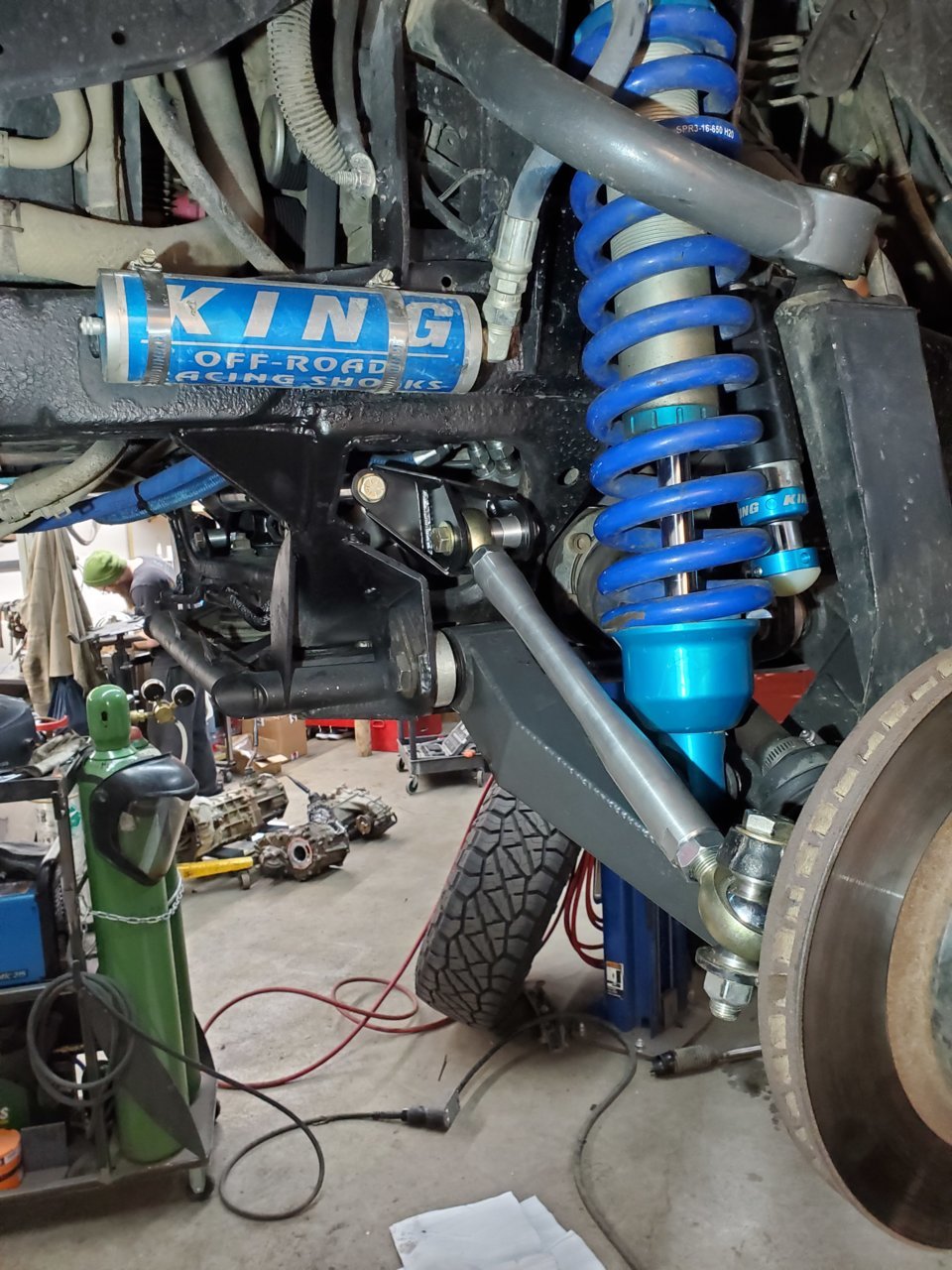

    Almost! Still working out the bed cage.
    I think I have a plan that will work for now and got one side tacked up how I think it will go. Not perfect, but I'll gusset the top of the shock tabs to make up for the giant notch out of the tube. I'll probably build a whole new cage soon anyway.
    20211220_220128.jpg 20211220_220119.jpg 20211220_220111.jpg 20211220_220928.jpg

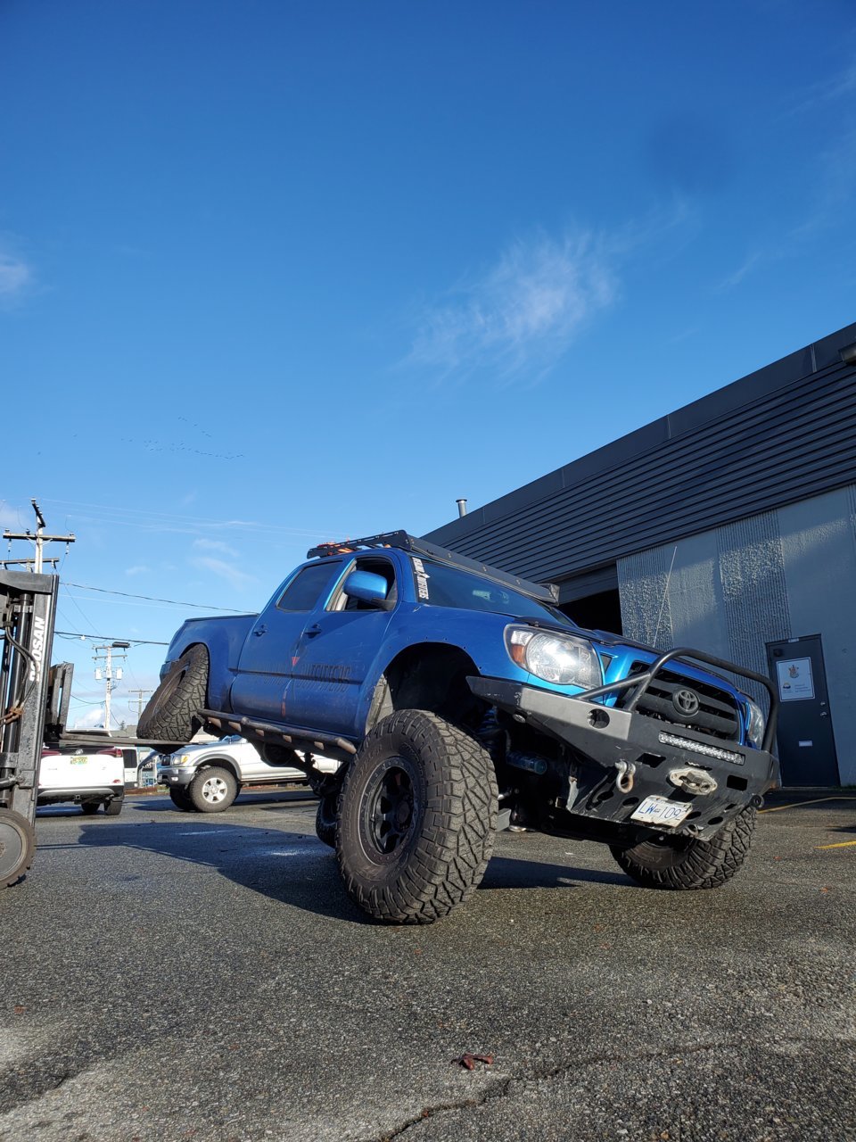

    All back together finally.
    And back to work...
    And just cuz...
