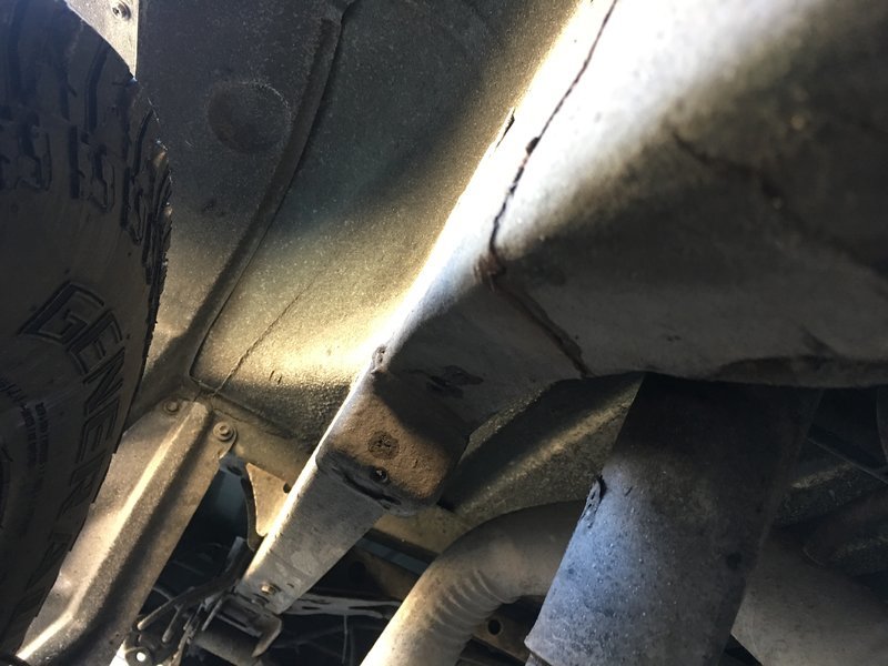

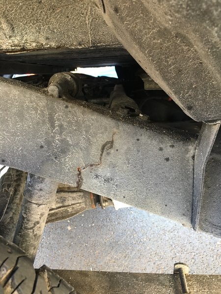

    Just when I was about to pull the trigger on a lift kit UGH
    Was doing a quick look around to see if I needed anything extra that didn't come in the OME Kit, I stumble upon this disaster.
    Assuming I'm past the recall time?
    I have a tire carrier recall open that needs to be addressed.
    Is this worth the fix? I'm more worried about the structural integrity of the frame. I don't mind spending the money getting it fixed since I'm planning on driving it until it dies.
    2001 Double Cab
    123K on the clock
    Stock Suspension
    No other signs of frame damage.

    Friend that looks pretty damn bad to me. I just see the whole thing jack knife-ing

    Looking at your photo, I don't see a lot of cancer on other parts of your frame. It appears to be a stress crack that over time has allowed rust to develop inside the crack. If the frame rails are as solid as they appear, I think that could be easily fixed. Treat and stop the existing rust in the crack, and then weld steel plate over the outside and the bottom. To give you a little peace of mind, you could also cut and welding a boxing plate on the inside of the frame rail.
    I would take a look at the frame rail on the other side and make sure you don't have one there as well.

    Done it doesn't look like it's separating at the crack (other than the crack itself), I think dressing and welding and welding a fish plate over the repair would be sufficient. The key would be to repair the crack and remove any rust so the problem doesn't reappear after the fact. They've been doing similar repairs in the low-low scene when notching a frame to lower cars. You should be fine- there. No need to over complicate the repair if the picture you posted is the only damage.
    That being said, that crack is a result of a failure or stress point somewhere else in the truck/frame. I suggest you try to find it and address that as well. It'll pay off in the long run.

    You're in a 01 the window for replacement if it was even eligible has expired. The program states that if you had the corrosion inhibitor sprayed per Toyota's notice you'd be covered for 15years past the "in service date".
    Time for fishplating or gussets.

    Obviously we can't tell what kind of condition the rest of your frame is from 2 photos, but if what we can see is indicative of the rest of the frame, that's not a difficult repair. In fact, I think you can make the repair plates yourself and save some money. Take some cardboard and trace the frame, going out about 6" on each side of the crack, buy some steel plate (I think 3/16 would be plenty thick), use your cardboard pattern, trace it onto the steel plate. Use an angle grinder and cut out the plate. If it were me, I'd make 4 plates, 2 sets of inside/outside plates, and weld reinforcements on the other side as well, just to be safe. Take a wire brush to the areas that will be welded, then take the whole kit and kaboodle to a good welding shop and have them weld them in. Follow it up with a good primer and sealer. And you should get many more miles out of your truck.

    Yeah man, I'd either make a frame plate like BKill said or buy a set of CBI Frame Plates for $70 plus shipping. If you do the prep work a welder can have the plates on in no time and then just paint them really well. Or rent a welder and do it yourself.

    Not a big deal to repair that at this point. Drill end of crack out, grind into crack slightly, weld it up. Flap disc the weld down, fish plate the whole rear of frame. Paint. Drive.

    That area of those frames is weak. That is the stress point. Nothing causing that but fatigue from being a weak ass part of the frame.
