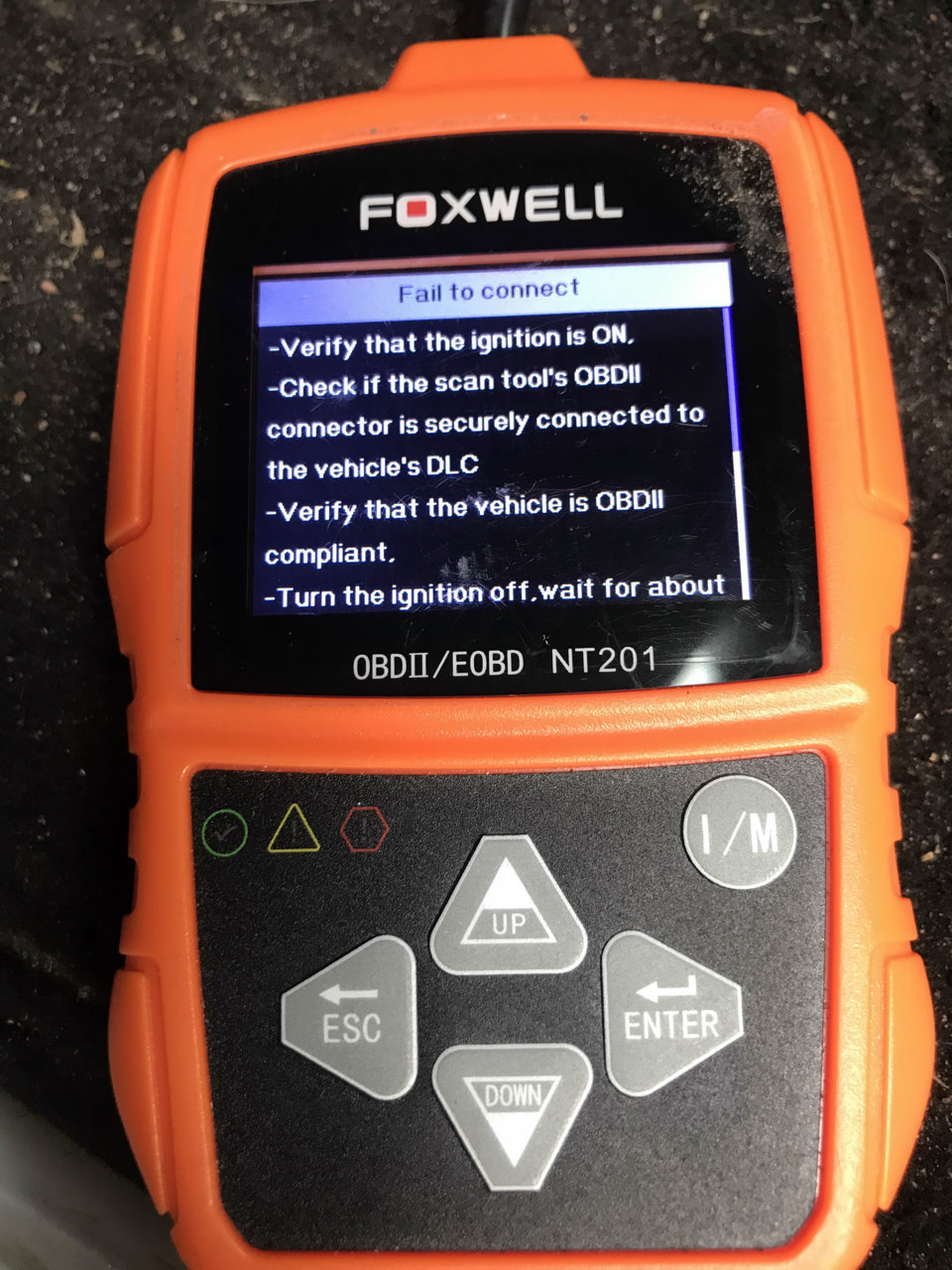

    3.) Scan tool will power on, but not communicate. Several were tried at the time and even recently. I honestly can’t recall if an OBD2 scanner was ever connected to the truck, so for all I know, maybe it never communicated to begin with.

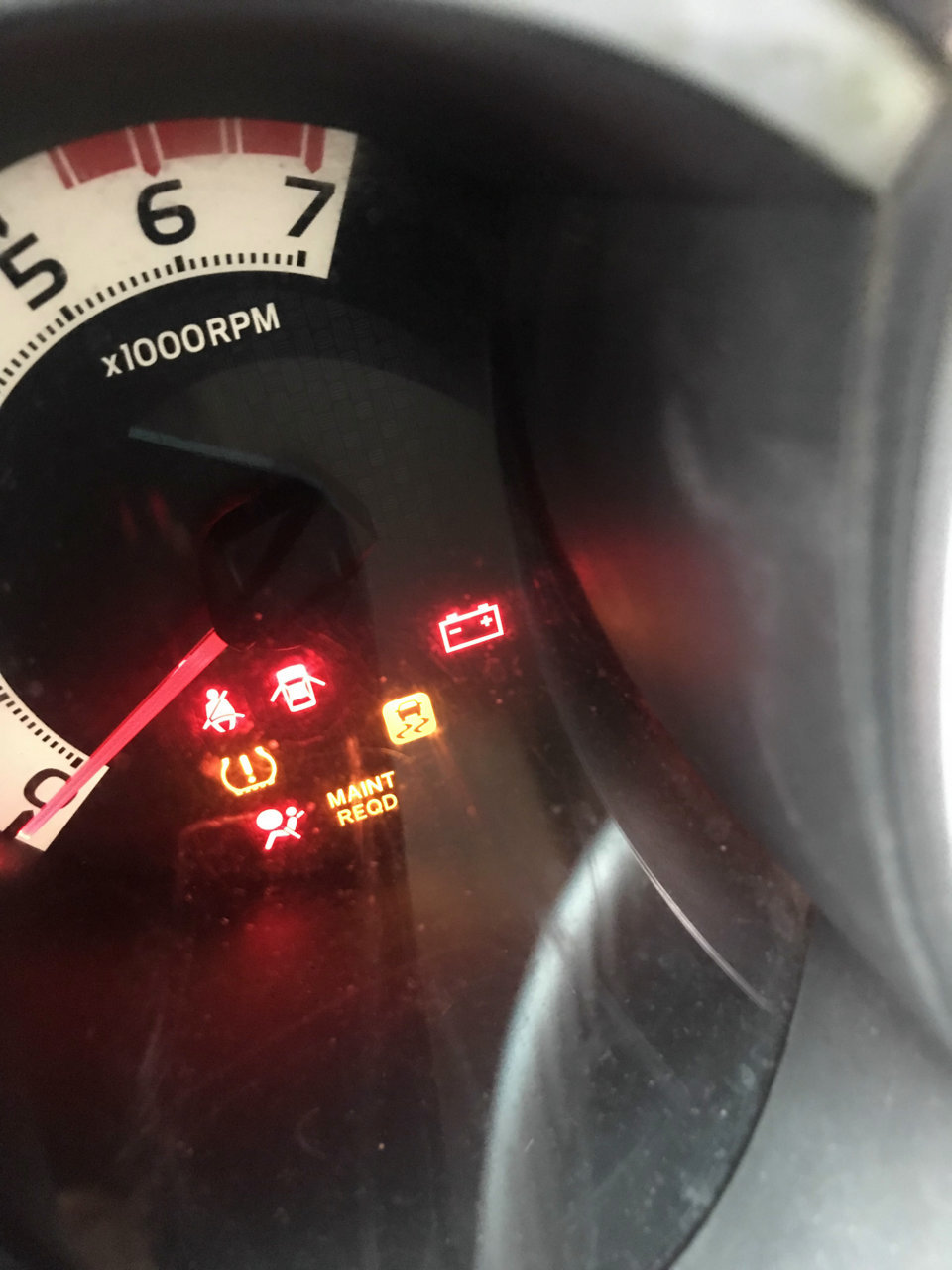

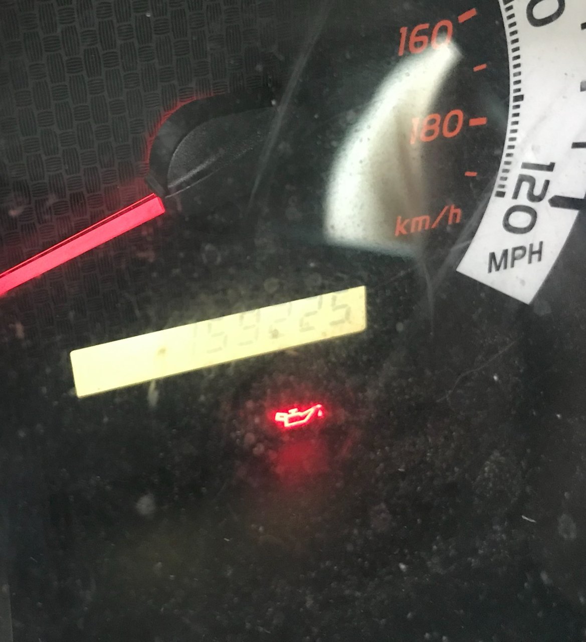

    5.) I’m NOT sure if this occurred to begin with, but today: the check engine light is not illuminating after turning the key on.
    6.) I AM sure this didn’t occur before but is occurring today: Just about every light (except MIL/CEL) illuminates in the instrument panel when ignition is on.

    b. Checked OBD2 port and the relevant pins for power. The pins fit snugly on the scanner. Haven’t checked for continuity, etc. yet.

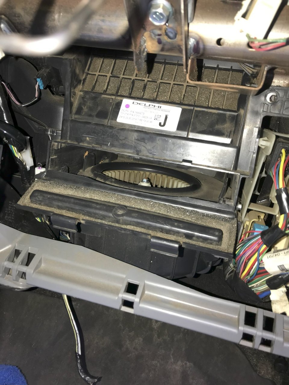

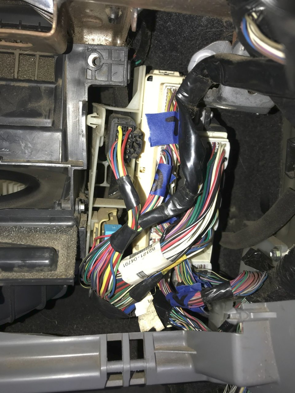

    d. Removal of glove compartment and some of the dash panels (to check blower motor) uncovered an unnatural amount of dog hair and dirt. It’s apparent the previous owner ran a grooming salon inside the cab while simultaneously operating a landscaping and earth materials hauling business. Vacuumed out what I could; it’s taking everything in me not to hit it with an air compressor.

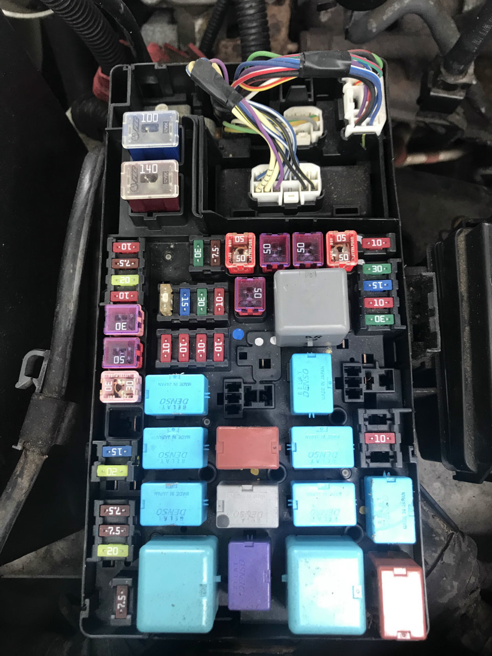

    Since you have no CEL on with the key on the first thing we need to check is powers and grounds at the PCM.
    We can start at the engine room fuse box, check the EFI (20A) and EFI No 2 (10A) for power with the key on.

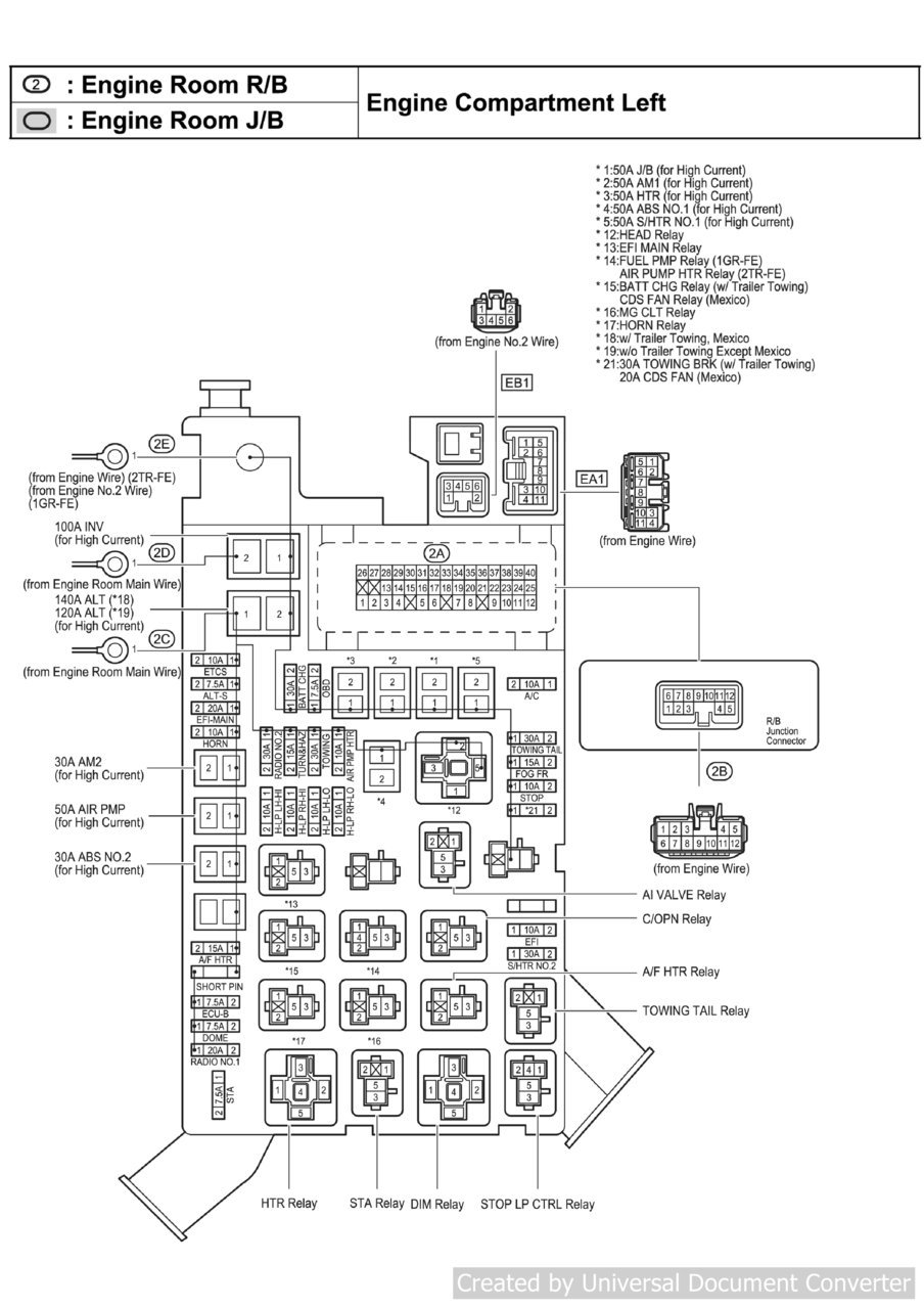

    Here you go.

    Tested both fuses with the key on, and both lit up on both sides. Photo attached of fuse box. Tried to get photo of light as I tested but that wasn't working out too well.
    Also, thanks for the wiring info. It doesn't look so Greek like it did last year :)

    Correct. I just went out and confirmed that is still the case. I have tried other scanners; all cheap, all work on other cars, just not this truck. In the pics of panel lights, the green wheel base thing and the 4LO blink.

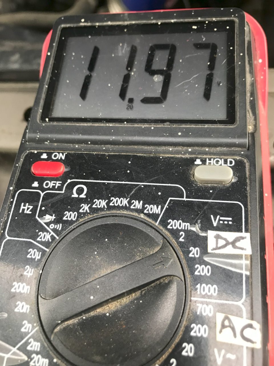

    Lesson learned, don't leave battery connected because you think you will be right back out to tinker again, but then it rains for 2 days.I guess leaving the battery connected for 2 days.
    Battery showed 11.97, so it is on charger now. I re-famliarized myself with the wiring behind glove box, correlating it to the diagrams you provided (thanks again). My fat fingers aren't very efficient with that small space, especially trying to isolate any of the middle wires, so I removed some of that gooey-a$$ tape that wraps the clusters of wires and was falling off anyways. Much better.
    If I'm OK to proceed with testing with the battery being low, let me know and I'll continue. Otherwise, I'm going follow some wires and look for some grounds while the battery charges. This stuff reallly isn't nearly as intimidating when you know what it is.
    Attached are pics of what I'm looking at only as FYI.

    11.97v isn't terrible (about 40% State of Charge), if you can keep the battery charger on it while your testing so it doesn't die on you you will be fine.

    That was my doing when I was looking at the blower motor. I usually put the screws and bolts back in so they don't get lost. I had no idea cabin filters existed until a couple of years ago if you can imagine.

    Something I did notice - it looks like someone has been through the wiring for the ODB port on drivers side, and for a couple of wires on the ECM side. The tape job looks like something I did and not something from factory. I'll get some pics tomorrow.

    When testing powers and grounds with a meter you always want your meter ground connected to a known good ground, circuit should be loaded (key on and whatever your testing plugged in and turned on), meter set to volts DC, and meter leads connected to the proper ports on the meter.
    On power circuits you should see battery voltage (same voltage as measuring across the battery +/- 0.5v), on grounds you should see less than 0.1v.
    For more info on proper circuit testing with a meter watch this excellent lesson by Paul Danner.
    https://www.youtube.com/watch?v=w0PpLTnKKZg
    What is the blue tape on the wires with stuff written on it?
