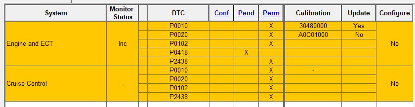

    The P0418 basically means the PCM either isn't receiving a diagnostic signal from the Air Injection Control Driver or doesn't like the signal it's getting from it.

    Should I still upload the scope recordings as a priority...like asap? Seems like we might be shifting focus from 'canbus' to 'things that aren't canbus'. I'll upload them either way along with my notes, but your responses would dictate where I do this today or over the weekend :)
    P0418 wasn't alone. He brought some friends to the hoedown.

    I mean if you want to capture you a known good you can but we know it talks now and we know we have more bad modules.
    It's up to you but I figure lets get the truck running and then go after secondary issues.
    The other codes are marked as permanent, meaning they were set at one time (probably when you bench tested the PCM) but are not active right now. Permanent codes can not be cleared by a scan too or a battery disconnect, the monitors for them have to run and pass multiple times before they will clear so I'm not worried about them.

    I think they all were trying to contribute just to jack with me, but If I had to guess I would say the brake one (or the wiring around it) and the airbag one.
    Unplugging the Yaw made the Steering and ECM appear in the Canbus test section of Techstream; the Steering kept going yellow/red/yellow/red.
    Unplugging the steering looked ok at first, then it seemed to go really, really fast, like it was playing at 3 or 4 times the speed from the Yaw test.
    Unplugging the brake - and I saw this the day before - seemed to make either the Can H or Can L disappear. It was the yellow one. Additionally, it appeared in a different part of the screen without me touching it. When I connected it back, the Yellow one came back and it looked more in line with the others on the scope.
    The airbag one, when unplugged, is when I could use the handheld scan tool and see the ECM on Techstream.
